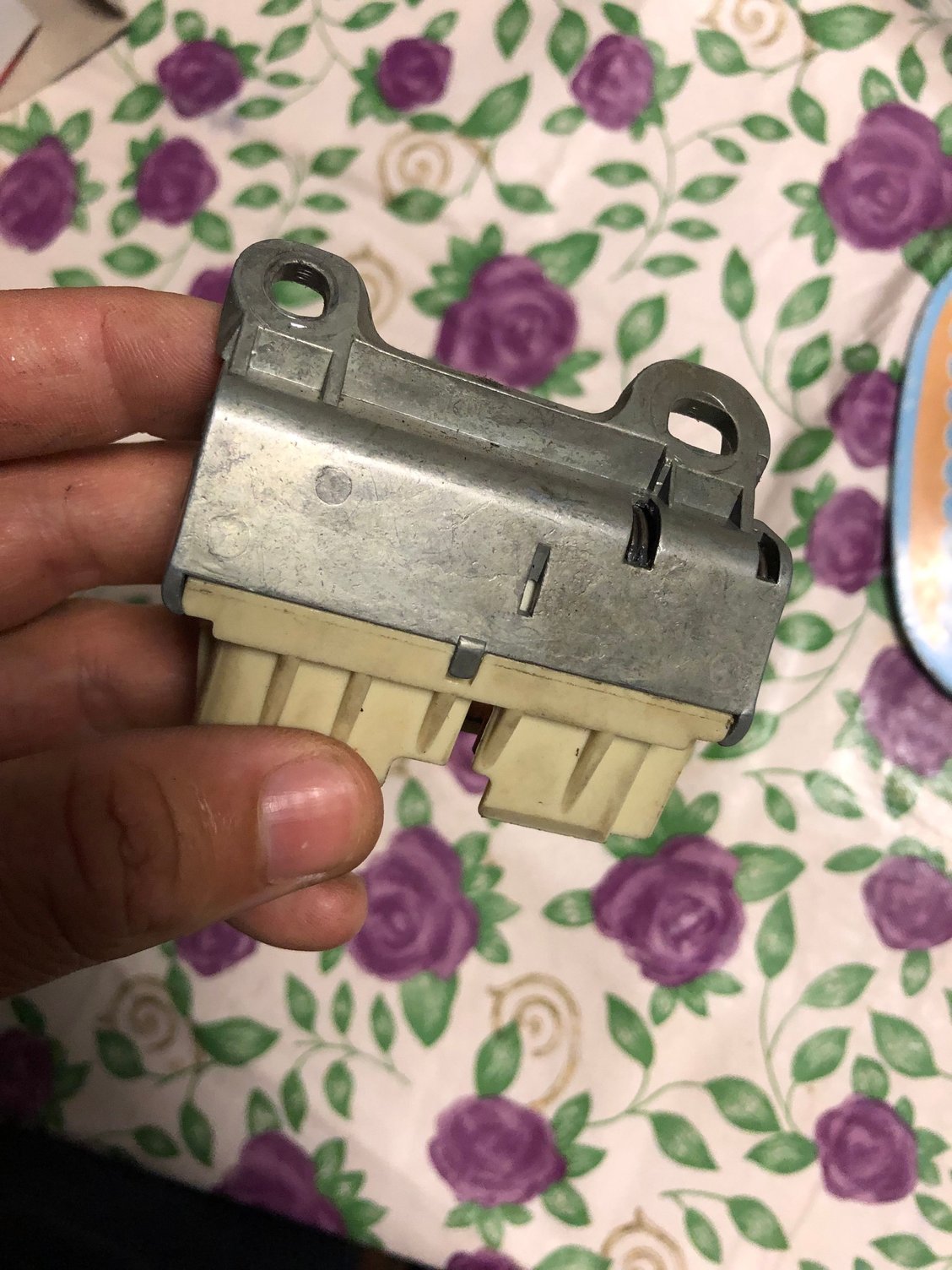

So to be clear this is the 86 CV w/ a 351w and an aod? If so the black wire is only the key in ignition sensor, it has nothing to do with the electrical part of the ignition switch which is down the column. I’m watching the race so i am here.

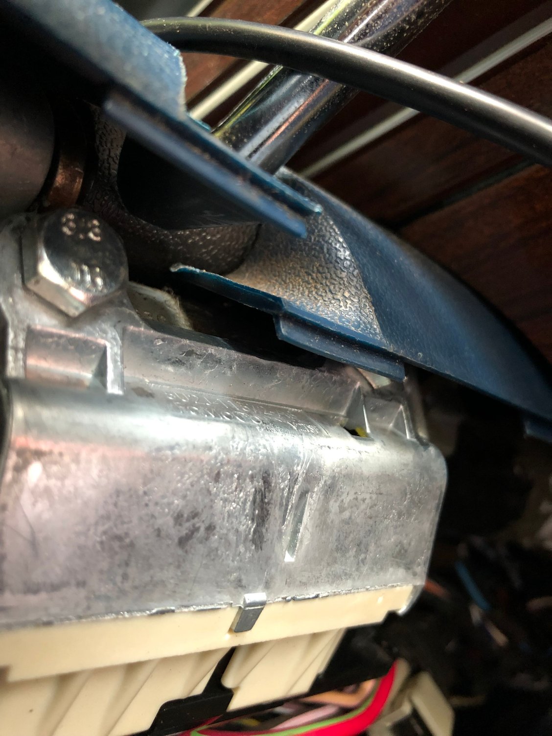

I replaced the ignition control module and inspected the connector harness; at least as far as I could until it went into the firewall. I didn't see anything obvious like severed or chewed wires. The ignition module is a replacement as its spade terminals look new; and the 2 bolts that fasten it to the steering column are Home Depot bolts.
I also looked at all of the wiring in the steering column and although kinda dirty; nothing is severed. I will wait until my replacement ignition cylinder comes in and install it. Then see if anything changed. Other than that, I have no clue what to do other than pulling the engine and checking the wiring coming out of the firewall.

Turn that switch over and you can test it electrically by sliding the contacts just like when you turn the key switch. It sounds like all the accessory things power up but no ignition stuff and no crank. The switch is adjustable on the column so that the key lock and the electric part line up the same. The starter function is pretty tough since it had to release and move all the linkage and key switch when you let off crank position. I can pull up the factory schematic for that switch, let me look. That would be tomorrow. You may only have accessory power for the main fuse box and no battery direct power.

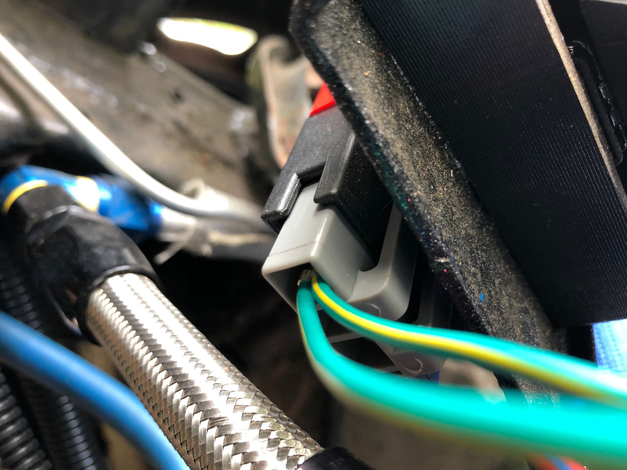

As such, I went back through the wiring harness for the starter solenoid and traced out the wires going to the coil and dizzy. I double checked the wiring against a couple YouTube vids and it appears that I incorrectly wired the dizzy and coil. I mixed 2 of those wires. I corrected the dizzy wires, but when I pulled the coil connector out; it crumbled internally; and the terminals were stuck on the coil pins. Went to pull out the terminals and one snapped. It was getting dark, so I called it quits and will deal with that tomorrow if the weather holds. I don't know what effect an incorrectly wired dizzy and coil would have on the ecm and the rest of the system; could this have been the problem? I guess I will find out tomorrow or Monday.
