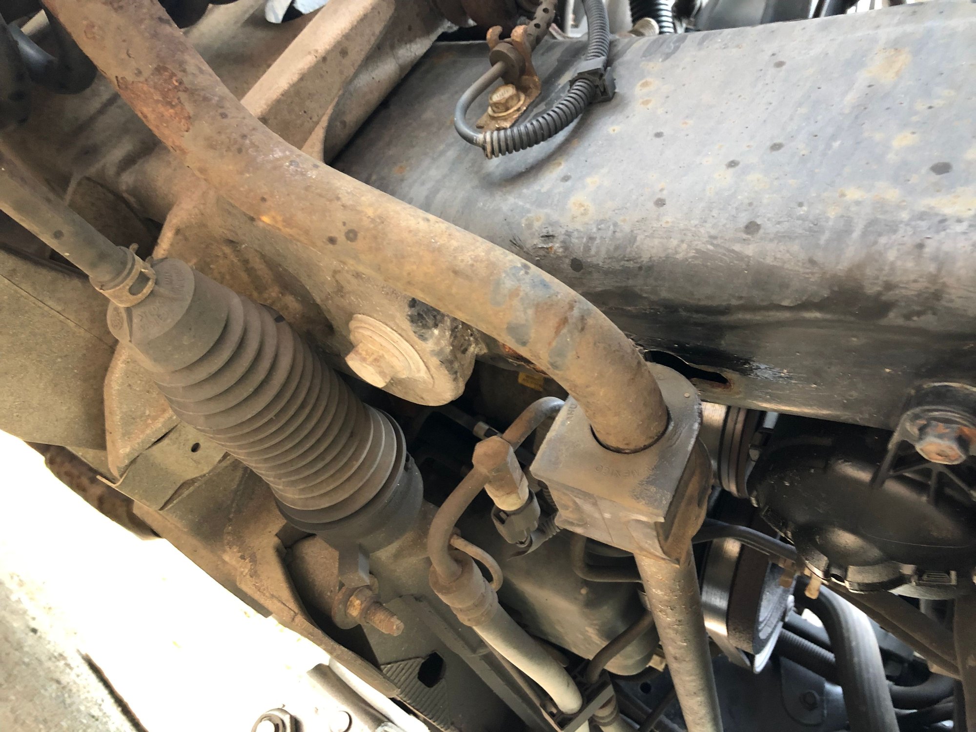

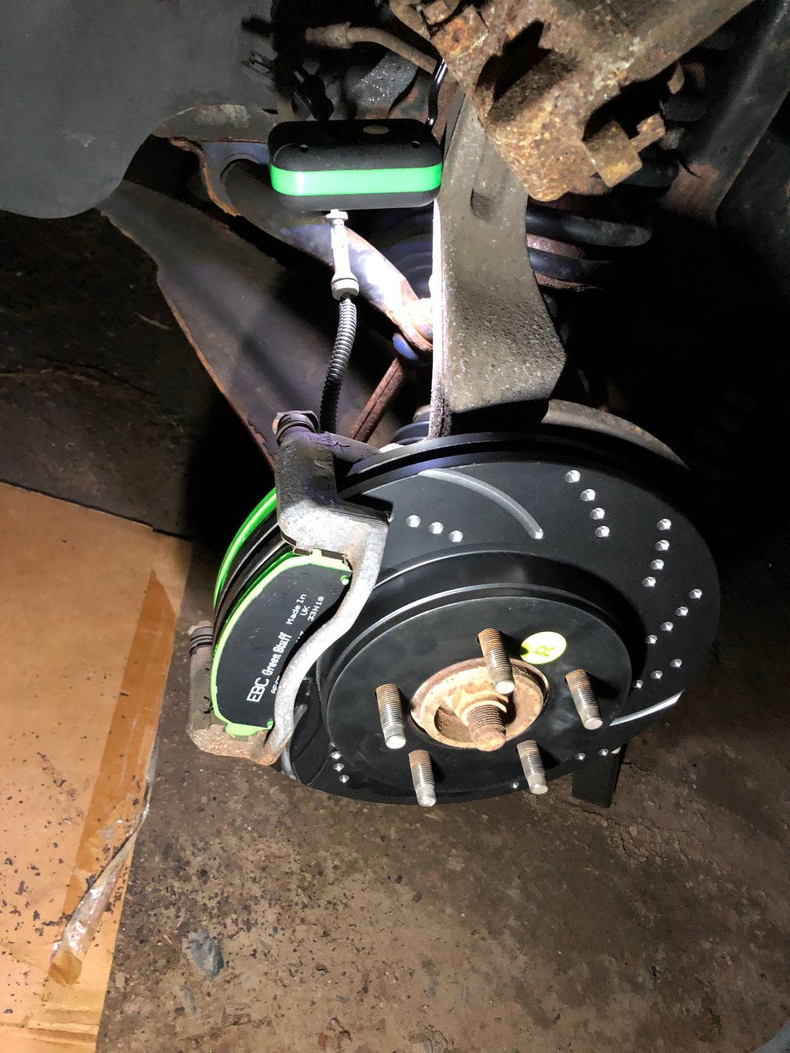

So the new tradition for turkey day is to do major repairs on my vehicles. 2019 I replaced the coils and plugs on my Grand Marquis; 2020 I replaced the intake manifold; yesterday I replaced the front brakes and sway bar. My brake pedal had been progressively getting lower to the floor since last spring. The pattern for this car is they begin to grab more towards the end of their service life; which they started doing in September. Then last month I started seeing the brake light on the dash flicker; and the last couple of weeks I was getting significant brake fade; so much so that I was driving very conservatively.

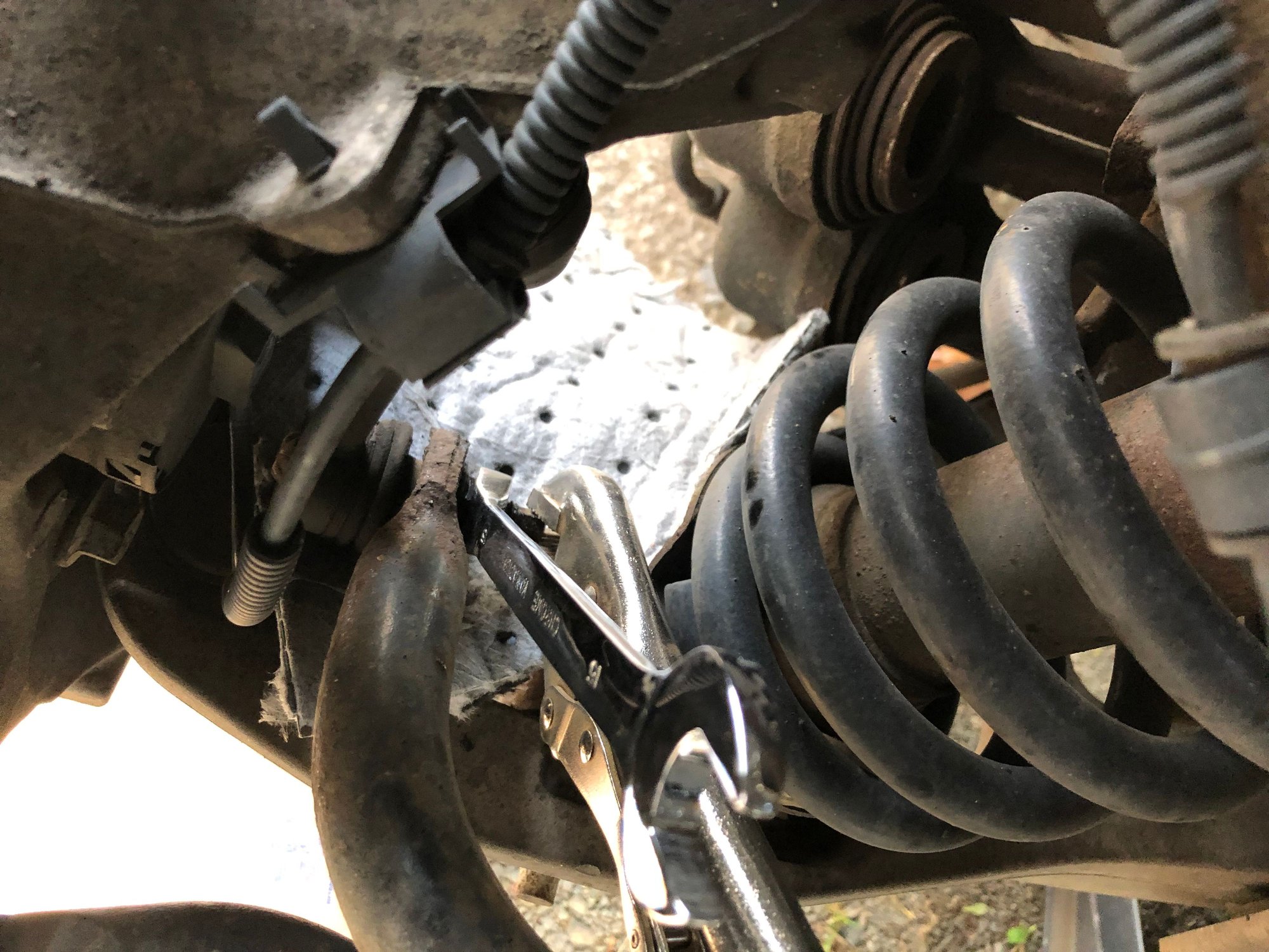

The sway bar is another story. I attempted to switch it out back in 2019 and broke a sway bar retaining clip in the process of removing the old bar. In fear of breaking the other retaining clips; I stuck a carriage bolt and a locking nut in its place. I left the old bar in place while I looked for replacement retaining clips; that I discovered were discontinued by Ford and none could be found locally. During that interim, my carriage bolt worked its way out and fell off; which stressed the other passenger side retaining clip; which broke and fell off at some point. I didn't notice it until I slapped the Saleen wheels and wider tires on the Merc and noticed no improvement in handling. In fact, it was beginning to roll a bit more than usual. I knew something was up; but didn't know how bad it was until I jacked the car up yesterday and found that side of the sway bar dangling by the end link; and the metal bushing bracket was nowhere to be found. Fortunately I had gotten retaining clips for another Ford vehicle off of Amazon a month ago; so I spent some time (with a hammer and punch) making them fit. Then I removed the old sway bar and replaced it with one from ADTR (much thicker). In a couple hours I will see if the driveway is dry enough to replace the rear brakes. Then I will take the car out tomorrow to begin bedding the pads and see if I got some handling back. I will also change the oil while I am at it.

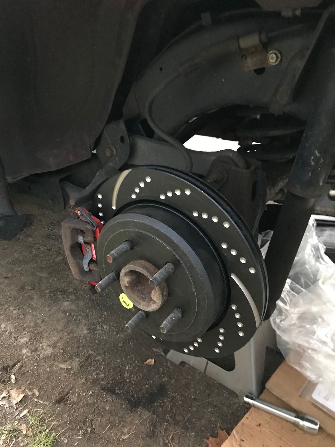

Those are the EBC brakes that my Panther community had been telling me to get for years now. I had SP Performance rotors and pads on my Merc previously, but they were quite the disappointment. It wasn't until I installed EBC rotors and pads on the Explorer that I realized how good they are. It was a night and day difference on that SUV. Hope it's like that with my car. Here are pics from the Explorer.

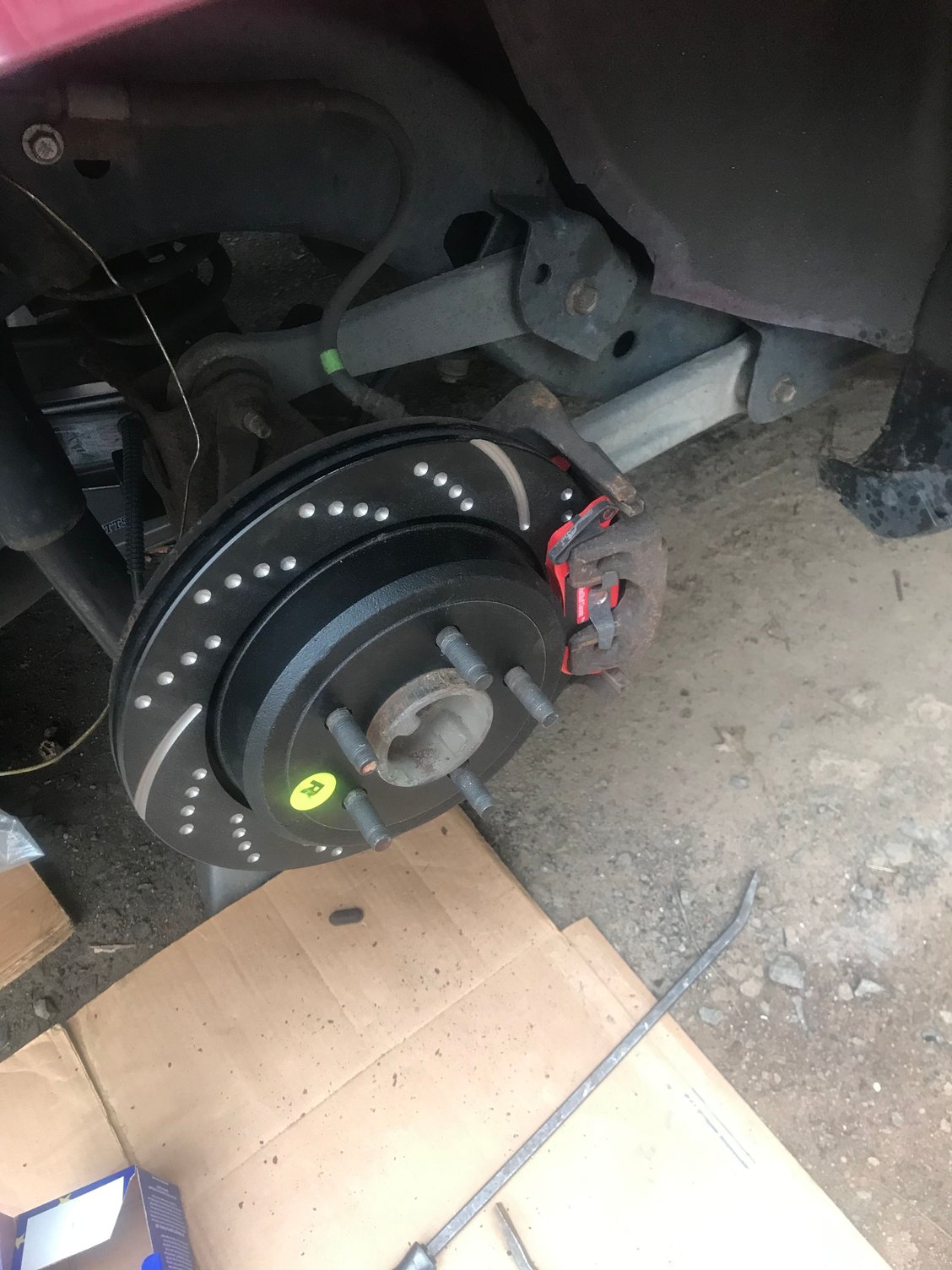

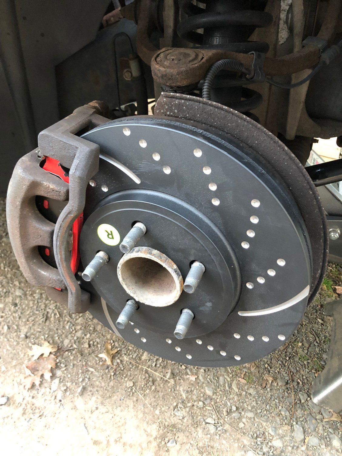

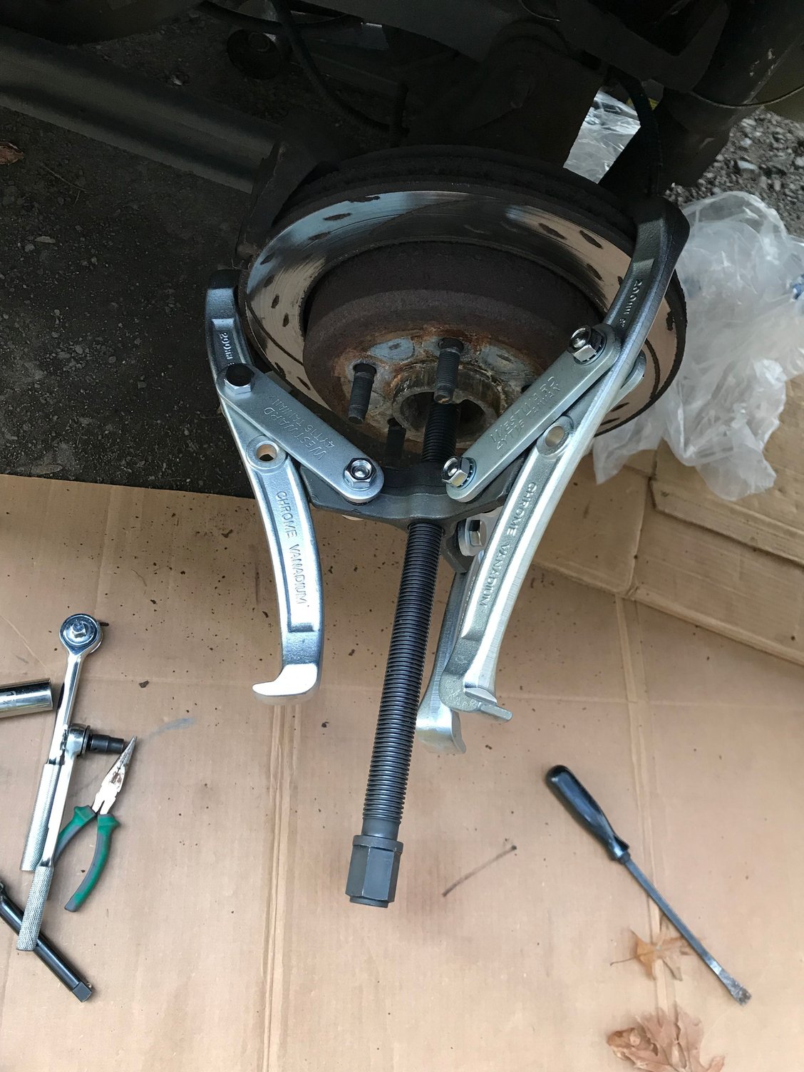

I replaced the rear rotors and pads Saturday afternoon. It could be just my car; but my axle hubs are under-bored; as everything that is mounted to them gets seized. The original wheels, the 1st set of PI wheels, and the Saleen wheels have to be pried off the hub. As such, I used a 3-jaw pulley puller to remove the rear rotors since hammering does nothing. When I put the wheels back on yesterday and went for a test drive, I heard and felt a knocking noise from the rear wheels. When I got home I jacked the car up and pulled the wheels off to see what was up. I readjusted the e-brake and spun the wheel by hand and it clunked and binded up. It was dark and my hands were freezing, so I called it a day. Went out this morning and pulled the brakes apart on the driver side to discover that the brake shoe retaining clip and pin came apart and basically pulverized themselves somehow. Waiting for new brake shoes and hardware to come in so I can complete this task.
