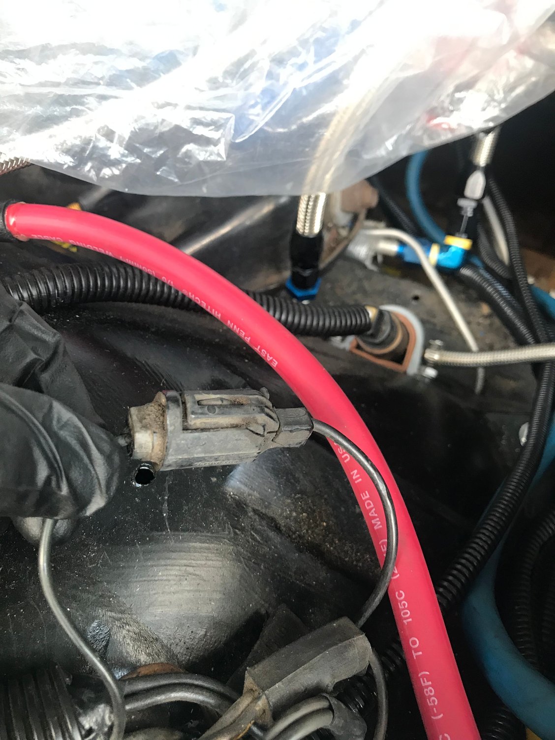

Also assembled a Duetsch connector for the ECM ground that looks to be in bad shape. The original ring terminal actually broke on the old battery cables; which is why I am going to check all of the critical grounds on that car; as it's now 36 years old.

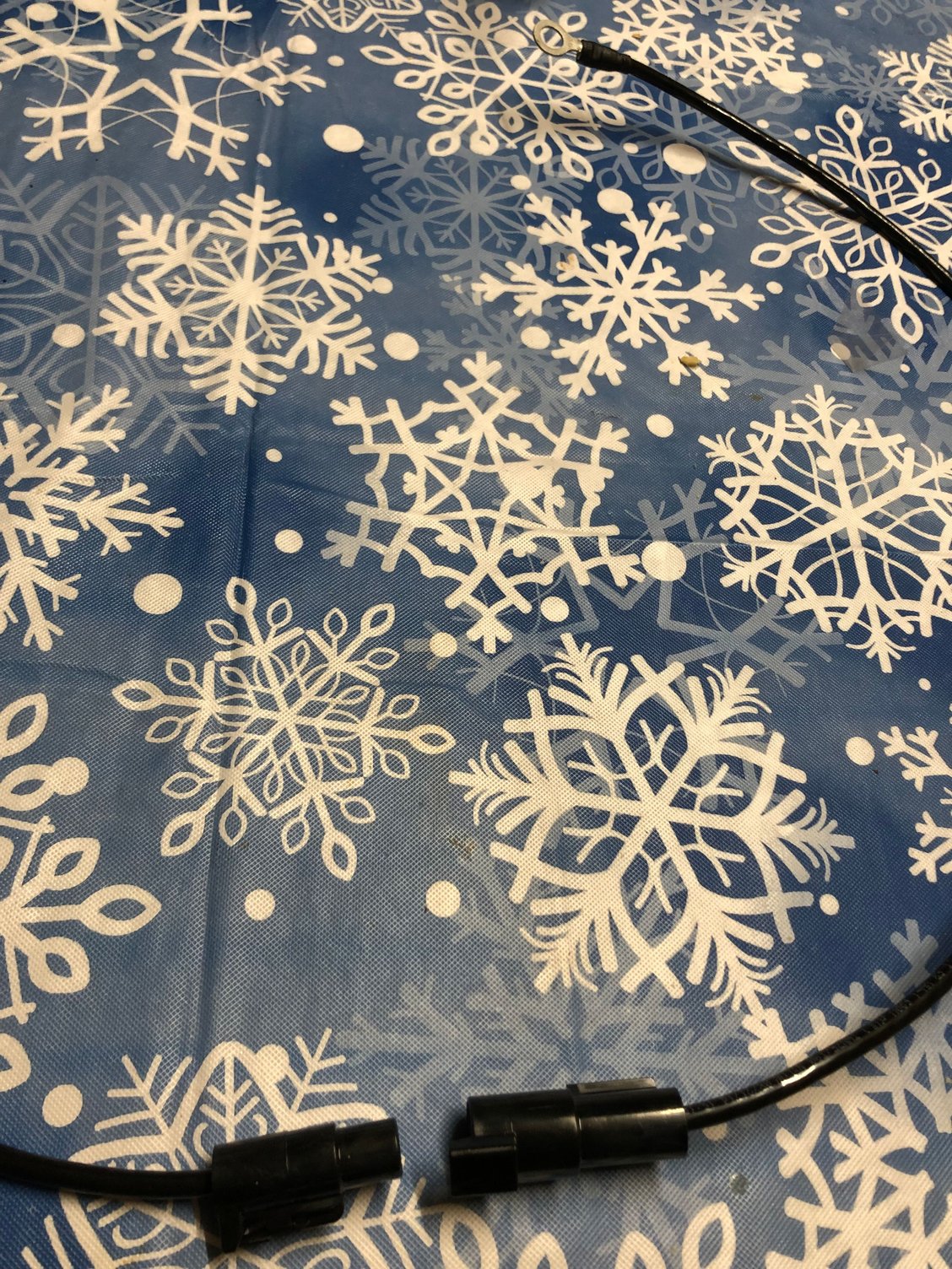

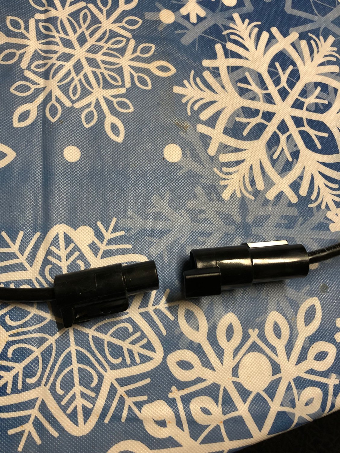

I attempted to solder on the Deutsch connector earlier. I couldn't find my old spool of silver solder that my Dad gave me; so I used the RadioShack solder I got a 3 decades ago. Truly I tell you, please get decent solder for anything electrical! This RadioShack stuff must be some high-temp solder. Had to heat the crap out of the wire and put the solder next to the heating element in order to get it to melt. IT sort of laid on top of the wire and failed to soak in. I soldered all around the joint to get it solid; but I fear that it's at best, a cold solder joint. I will see how it works when I power the system up. So when I went into the Crown Vic to get the heat gun that I left inside (with my poor GoPro), I found the old silver solder in the box with the heat gun. In the long run; I will get a single-terminal Deutsch connector, splice some 10AWG wire in place of the 14AWG wire that Ford used, and replace that connector. For now, I hope the 2-pin connector works better than the original Ford connector.

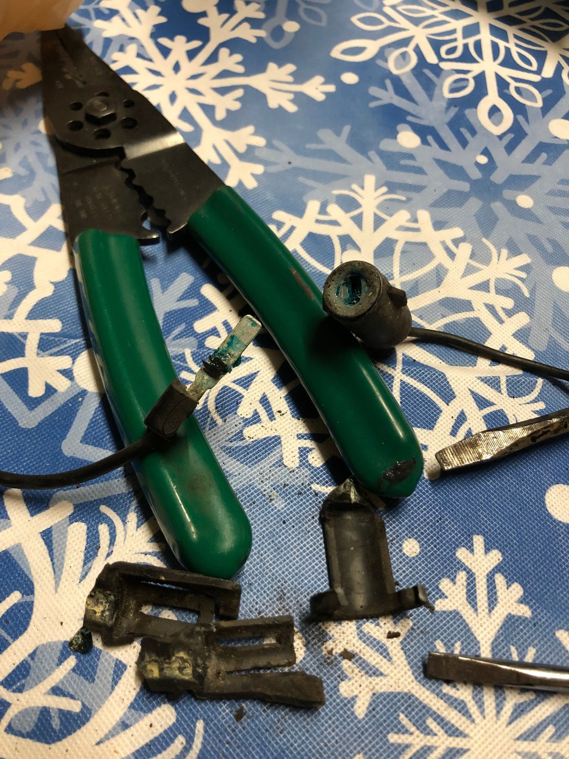

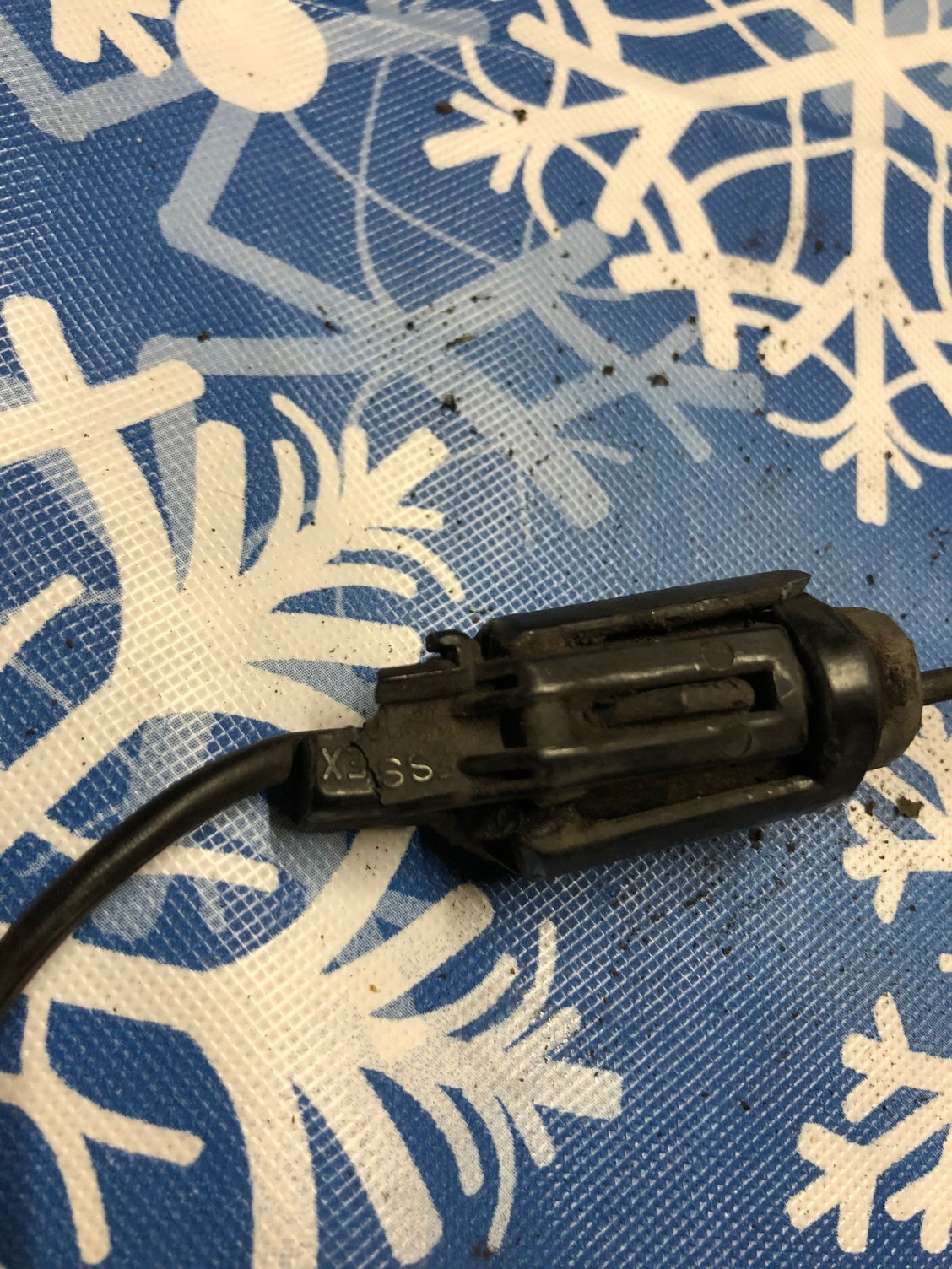

Speaking of which; I brought the Ford connector inside to mess with it on my favorite work bench (kitchen table). The pictures below illustrate the inspection process; which wasn't very long as the connector fell apart as I tried separating the ends. My Dad tested it and said that while it still kind of worked; it was borderline sketch. And I think the blue dielectric grease that Ford used on the terminal was acting like glue. Very hard to pull that connector apart; even after the plastic casing fell off.

I could not leave well enough alone. I got my single terminal Deutsch connector this morning. So after my meeting this afternoon; I got a window of opportunity after the snow squall to measure out the new cable I would need to make that connection; and assemble the connector. After doing that; I was going to cut off the other Deutsch connector and splice this one in; but the wind really kicked up something fierce; and I had to call it off. I will wait until next weekend or whenever to splice the single terminal connector in its place.
