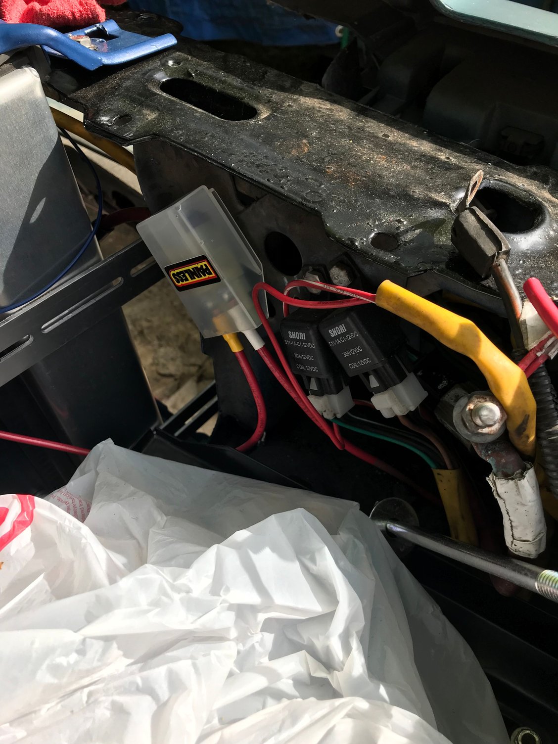

Did a few small things to the CV today. I had meant to crawl under and hammer the floor pan, but just didn't feel like doing that. So I worked up top with some odd and end stuff. Installed the Painless 70A fuse for the fan and ran power to where the battery+ terminal will be. I finally got sick of looking at my battery tray/tool tray/trash tray and cleaned it up.

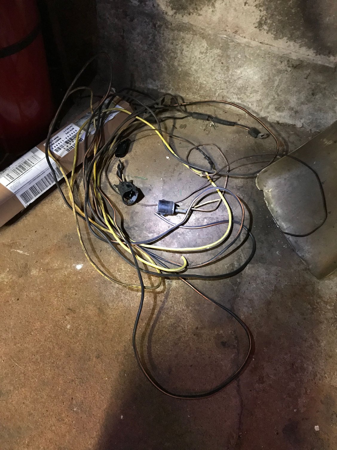

Since I work slowly, the sun had set at that point. As I was packing up, I found my eyes looking at the old charge cables and signal wire (yellow/white stripe wire). So I stopped and grabbed the box cutter and cut a ton of electric tape off of the wiring harness in order to separate those wires. It was getting dark as I wire loomed the remaining wires. Just got in 45 minutes ago. Sometime this week I will get a look and see what kind of progress/damage I made.

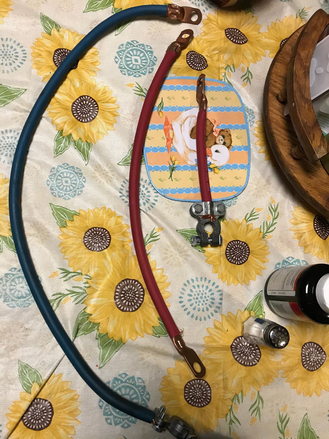

I found the battery for the Crown Vic on Saturday. I was rummaging through the uncrushed portion of the garage and found it under the Lincoln SA-200. My Dad must have put it there along with the Ranger battery. So I took the CV battery and put it in the battery tray in order to measure, cut, and assemble the battery cables. And to run the power cable for the electric fan. In the pic below from right to left; battery + to starter relay; battery + to the power distribution block on the fender; and battery - to engine ground. I was sidelined by sinus issues yesterday; so I only managed to heat shrink the terminal ends on the battery cables. If I have time after work this week; I will start looking everything over and prep for the 1st start. And yes, I sometimes work off of the kitchen table
