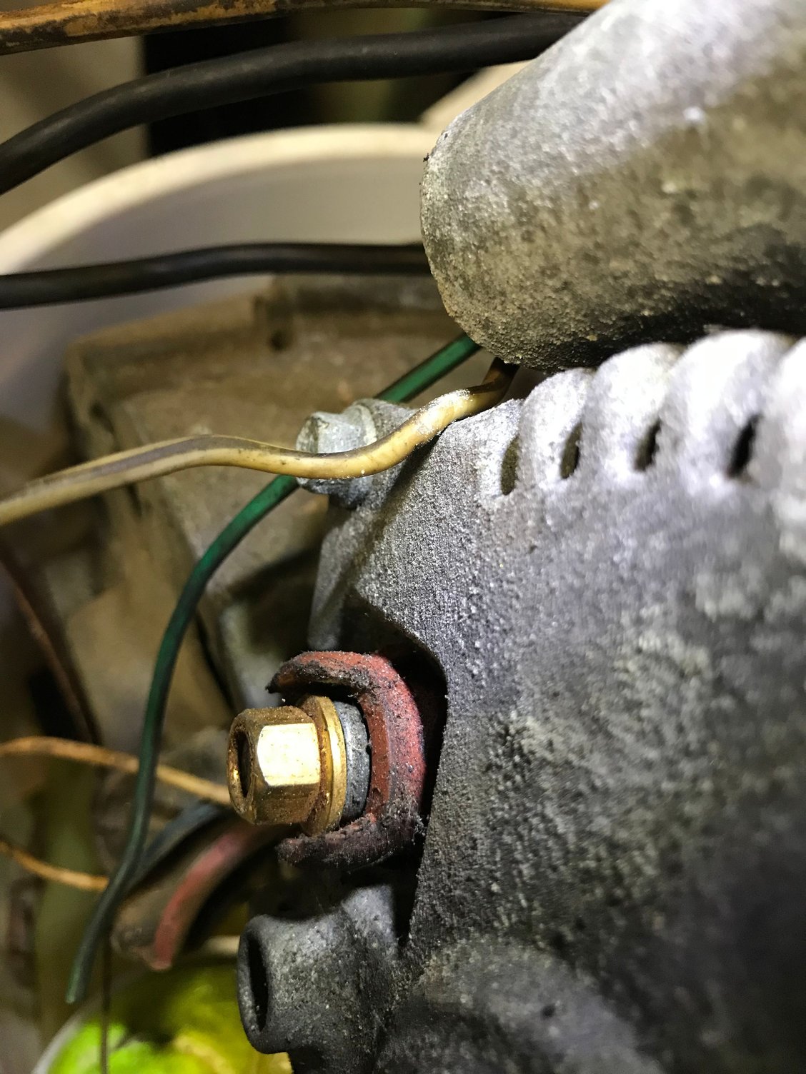

I was specifically referring to the uninsulated connection of the output alternator lead to the next piece of lead leading to the battery.
Seems terribly unsafe to leave such a high current lead uninsulated at the top of the engine compartment. If you catch that with one forearm and ground yourself with your other hand, you are a current path from the battery to ground. And although your bodily resistance is high, it is the current path likely through your heart that concerns me. Doesn't take a lot to stop your heart. It's not the voltage level that necessarily kills you, it is the current that stops your heart.
That aside, you run the unnecessary risk of getting zapped, accidentally shorting it to ground with a tool etc. Not fun for you, and in the case of highly conductive tools, not good for the battery or the tool. It's equivalent to a dead short across your battery if the tool has no significant resistance to current flow.

Totally understand; and thanks for looking out for me. I misread the other post; that was the pre-rerouted picture. I removed the wire loom and duct tape that was covering the copper terminals; and replaced that with heavy-duty heat shrink. Hoping that seals it better than what I had put on there. Also, the 3G I have on there now had tabs by the charging stud that pointed the cable up or down; I have since broken them off so I can orient the charge cable across the back of the alternator so it can follow the routing I had. If I get out there tonight or during the weekend to install the shift linkage and dipstick; I will snap a pic of how it looks.

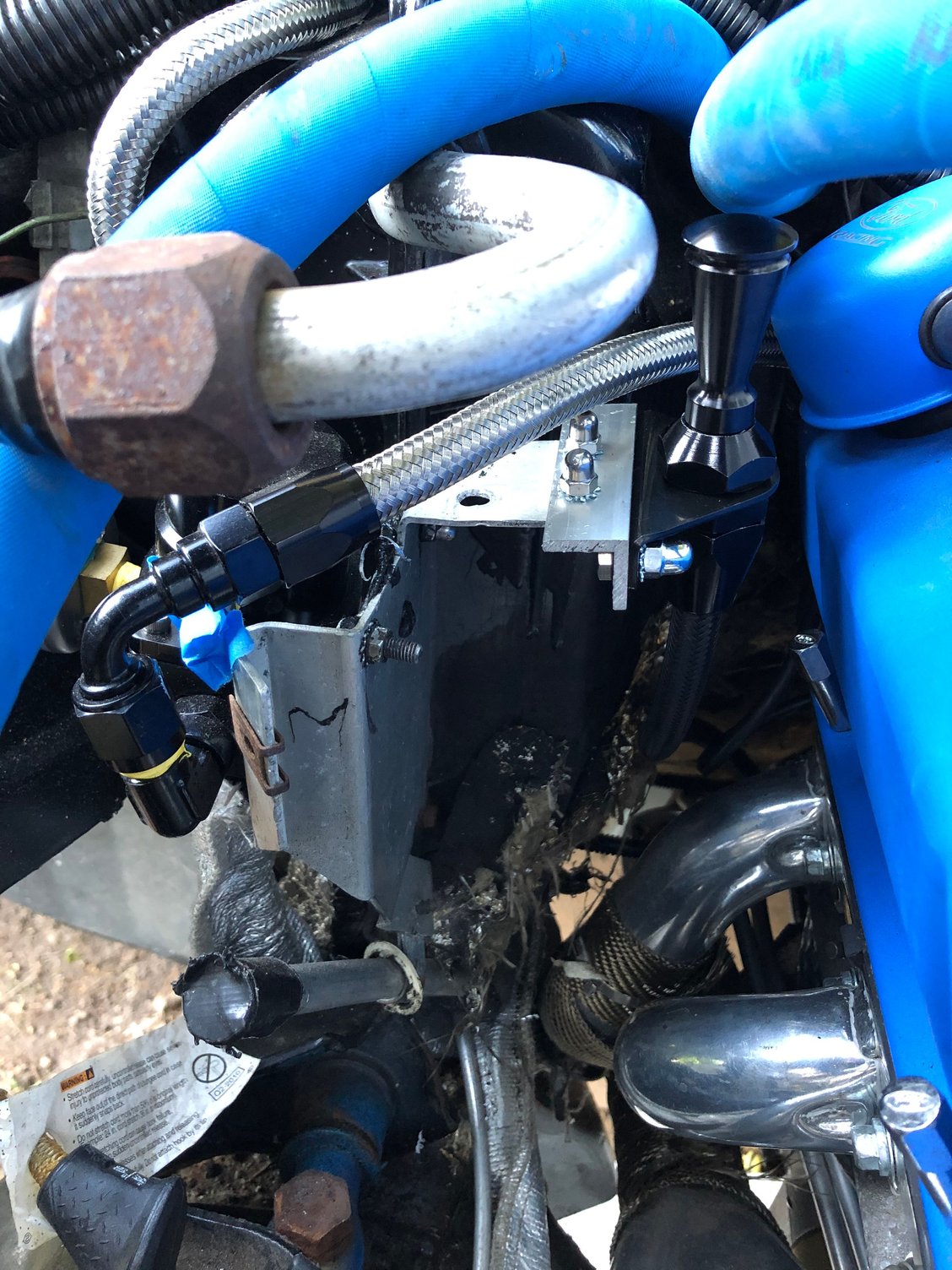

I called an audible and got the braided dipstick instead of the hard tube dipstick. I worked from home yesterday as I was scheduled to take the J&J vaccine. SInce I had a few hours in the morning before that appointment, I slid underneath the Crown Vic and installed the braided dipstick. I had to play around with it quite a bit; threading it in and back out until I got the angle correct and wasn't in danger of cross-threading. I had to remove the bracket that was attached to the dipstick as it was too high to attach to one of the header bolts. I had to unthread the hose end to remove the bracket; and when I did that, I noticed tiny aluminum specs from unthreading. Since my Harbor Freight compressor is down and had to use what little was left of the air tank to blow anything out of the braided hose. Then I reattached the dipstick to the oil pan and washed it out with WD-40. I hope I removed that material.
After the vaccination, I was still feeling spry despite the sore shoulder. So I went back out and got a good look at the dipstick; and figured out that I will get a 3/8 x 4"L stud for one of the primary# 3 bolts to use with a tube clamp in order to hold the dipstick in place. Also, I will replace most of the header bolts with grade 8 allen head bolts. They are easier to install and tighten down; especially the no. 4 cylinder in the rear of the driver side. I also had some heat shielding leftover from the fuel line install and slipped that over the dipstick hose in an attempt to keep the header heat away. We'll see how that works.
Whilst looking in the basement for the heat shield; I found the 3G alternator that I had on the Ranger; forgot that I saved it. I noticed that I didn't remove the tabs by the charging posts; but I remembered that he alternator was on the passenger side of the engine and right next to the battery; so I pointed the cable down and to the left for that short run. On the Crown Vic I simply snapped those tabs off to get that cable in correct orientation. I was feeling good up until 9PM last night; then the side effects hit me like a truck hauling rotten produce. Much better now (except for a low-grade fever); but I will wait until the weekend to work on the Crown Vic again.
