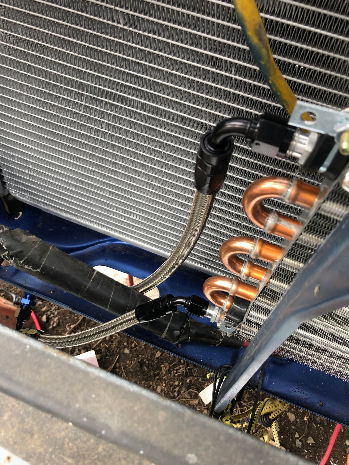

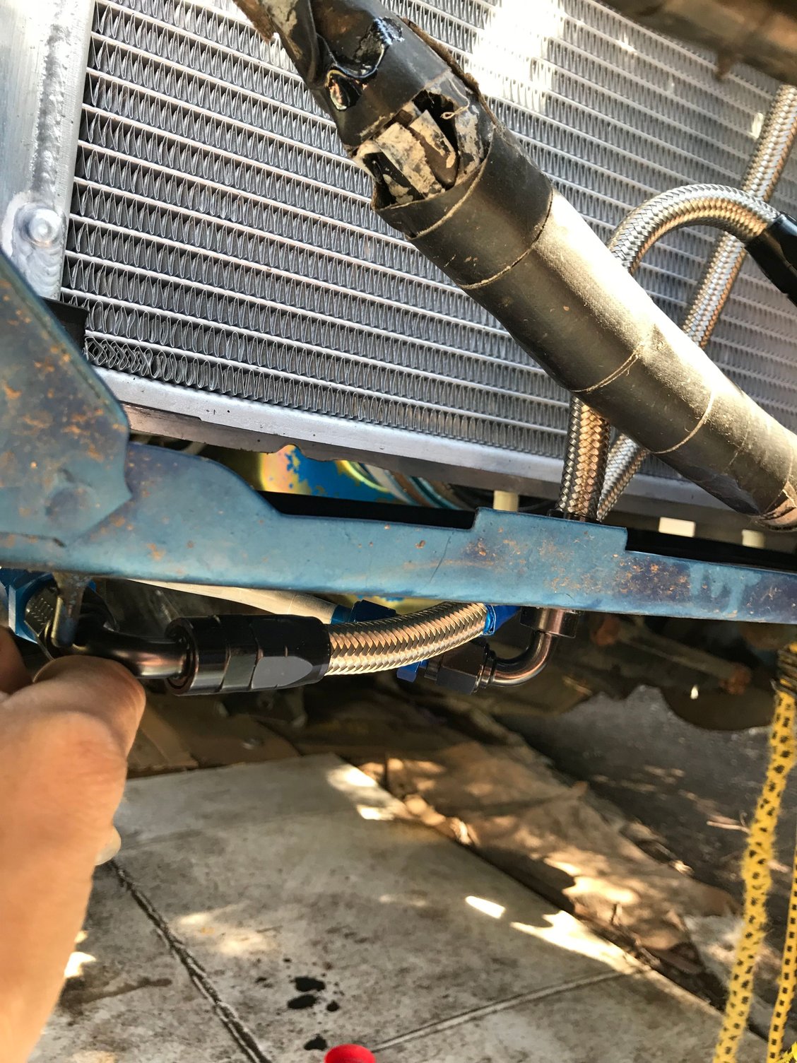

I installed the trans cooler yesterday; assembled and routed the cooler lines. I originally routed the trans cooler lines based off of what the Ranger had. I failed to realize that the Crown Vic radiator core support is a different shape and was never intended to be used for that purpose. The result is wonky hose routing. I will run it this way for now (if it doesn't leak); but I will bend up new lines and route them differently to clean it up.

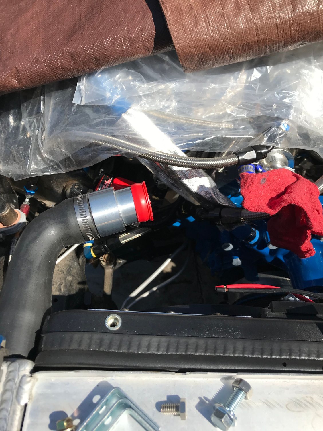

I also just got done modifying/cutting the upper radiator hose to fit a temperature sender collar for the electric fan. I used this method on my '91 Ranger when I converted to an electric fan. I didn't like the idea of poking the supplies temp sender through the radiator fins. What I failed to realize is that the upper radiator port and the T-stat housing port are 2 different sizes. The hose tapers down to a smaller size before it gets to the T-stat housing. My temp sender collar is the same [larger] size as the upper radiator port. So I used a heat gun to heat up the hose and then pressed the collar into the hose while it was still hot. Took some effort, but it eventually went in. I will mock that side of the hose up on Tuesday and then see how much of the other side I have to cut to get the rest of the upper rad hose to line up with with the T-stat housing. I will get pictures of that when I finish up.
Also, I will mock up my home-made CAI (pvc pipe and joints connected to the throttle body on one end; and the MAF sensor on the other end) and see where I have to drill and tap the new ECT sensor location. Then I will hopefully have some wiring to do next weekend.

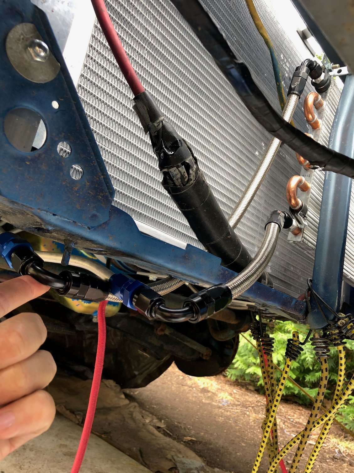

Now that I have looked at this a bit; I might be able to get the tubing bender in there and bend the hot line 45* toward the slot on the bottom of the radiator core support; where the return line is running through. That will make it a little cleaner.

And that's what I did this morning between meetings. Bent the tube towards the opening and routed the hose through it. Looks cleaner now; still going to reroute everything in the future.
And since the meeting was postponed for an hour; I messed with the upper radiator hose. Discovered the stock upper radiator hose won't fit a standard 351W T-stat housing. I guess Ford put a smaller T-stat housing port on the Crown Vics. I will check with the local stores to see if they have 1.5" coolant hose. If not them; Pegasus Racing.

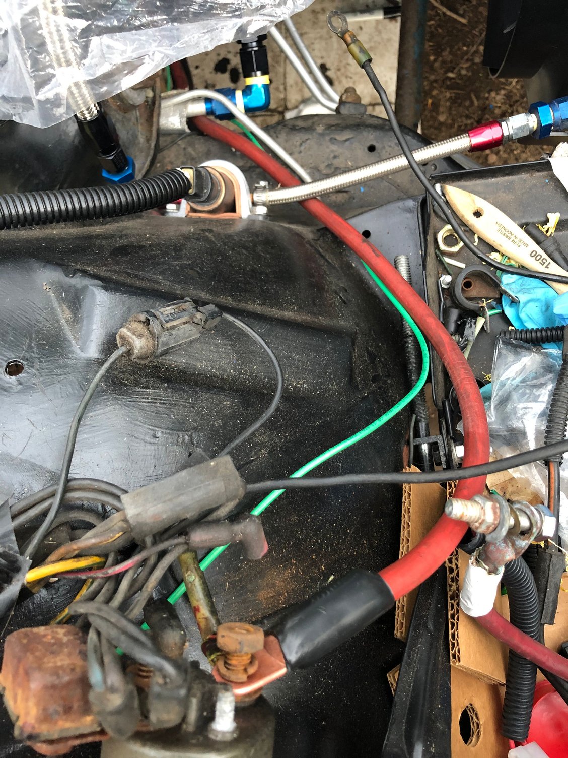

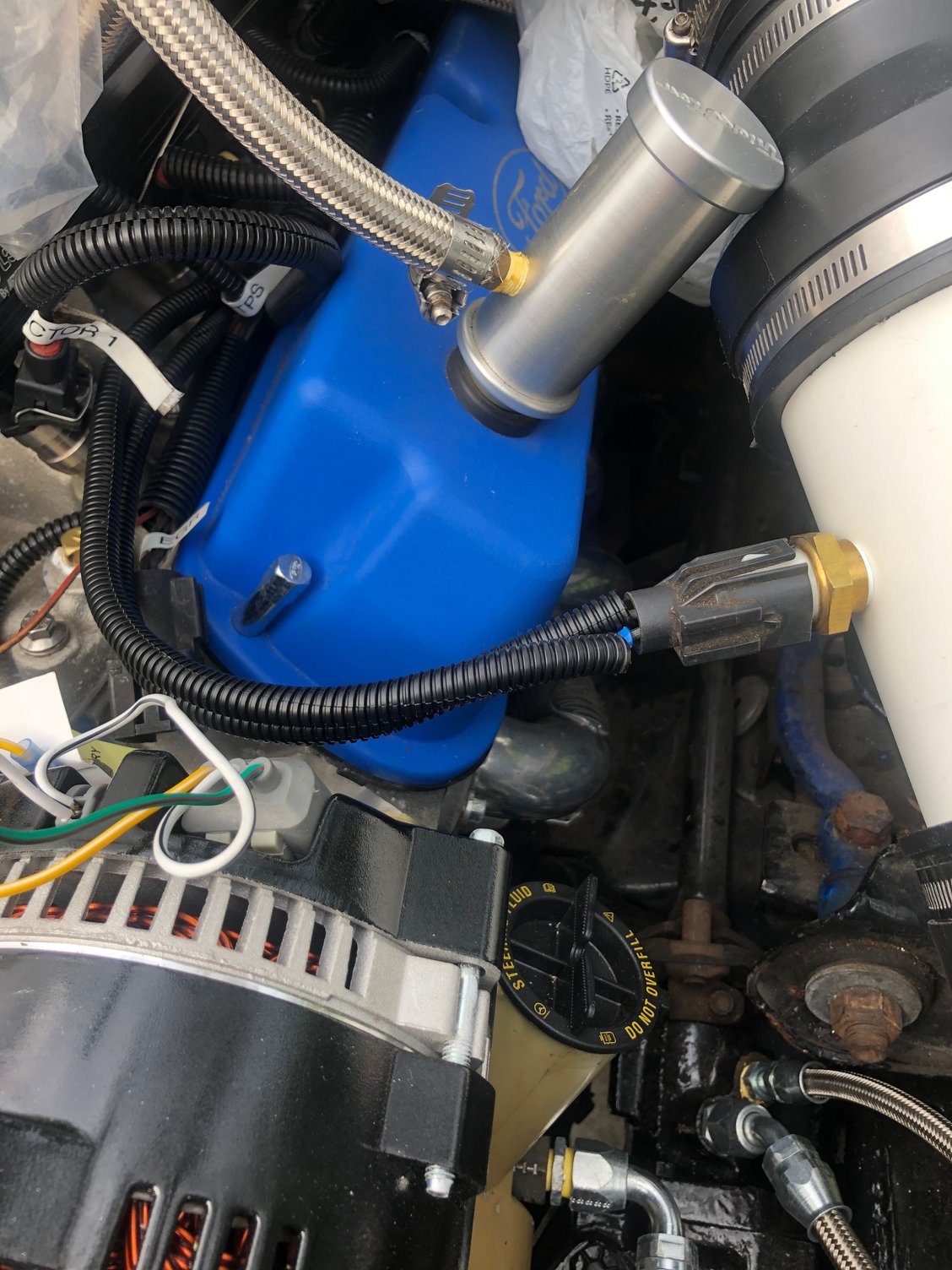

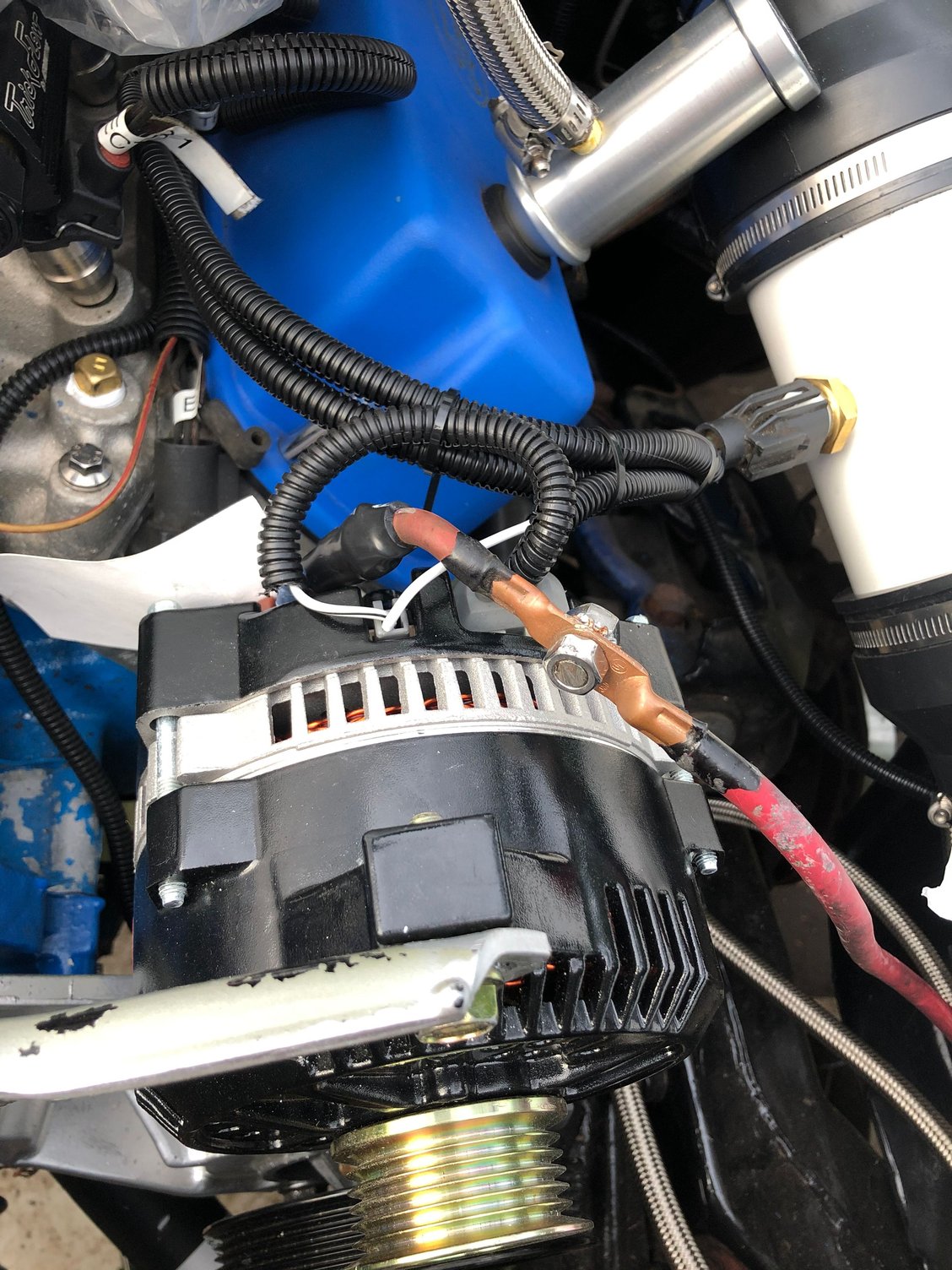

Did a bit of wiring over the past 2 weeks. Wired up the starter with leftover 2AWG I had in the basement and 12AWG for the signal wire. Moved over to the electric fan and ran the signal wire and the temp probe; which I used the Flex-a-Lite temp switch/sender threaded into an inline collar in the upper radiator hose. Moved across to the alternator and sorted that out. Discovered that I will not be using any of the stock wiring as the Powermaster alternator has its own wiring. Just needed to solder the signal wire to the main harness. Oh, I have since heat-shrinked and rerouted the alternator charge cable. I may replace that with 2AWG at some point.

Starter solenoid isn't bothering me; it's the circuit breaker box attached to it. I discovered it's the power window breaker switch and I can't find a replacement anywhere. I will have to figure out some way to replace it. I see all that rust and wonder if it's working properly. I have 2 spare starter solenoids in the toolbox in case this one goes. During the last days of the original engine; it started blowing solenoids and didn't figure out why. Hopefully that problem is solved.
