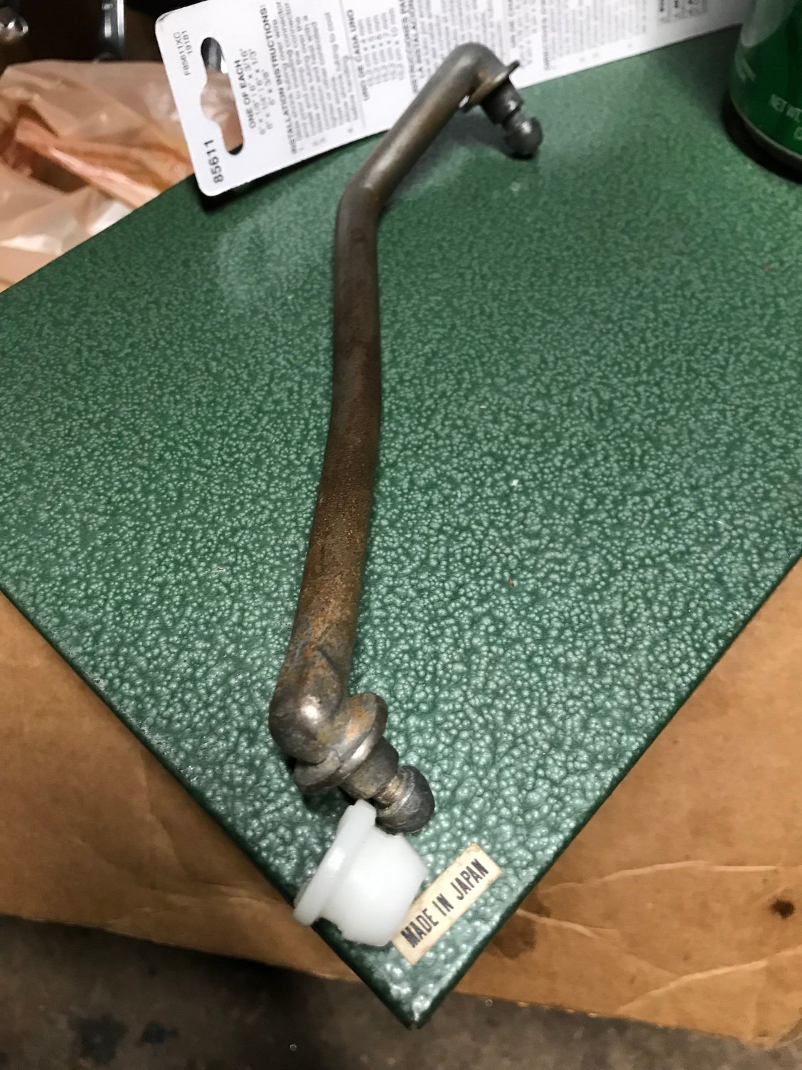

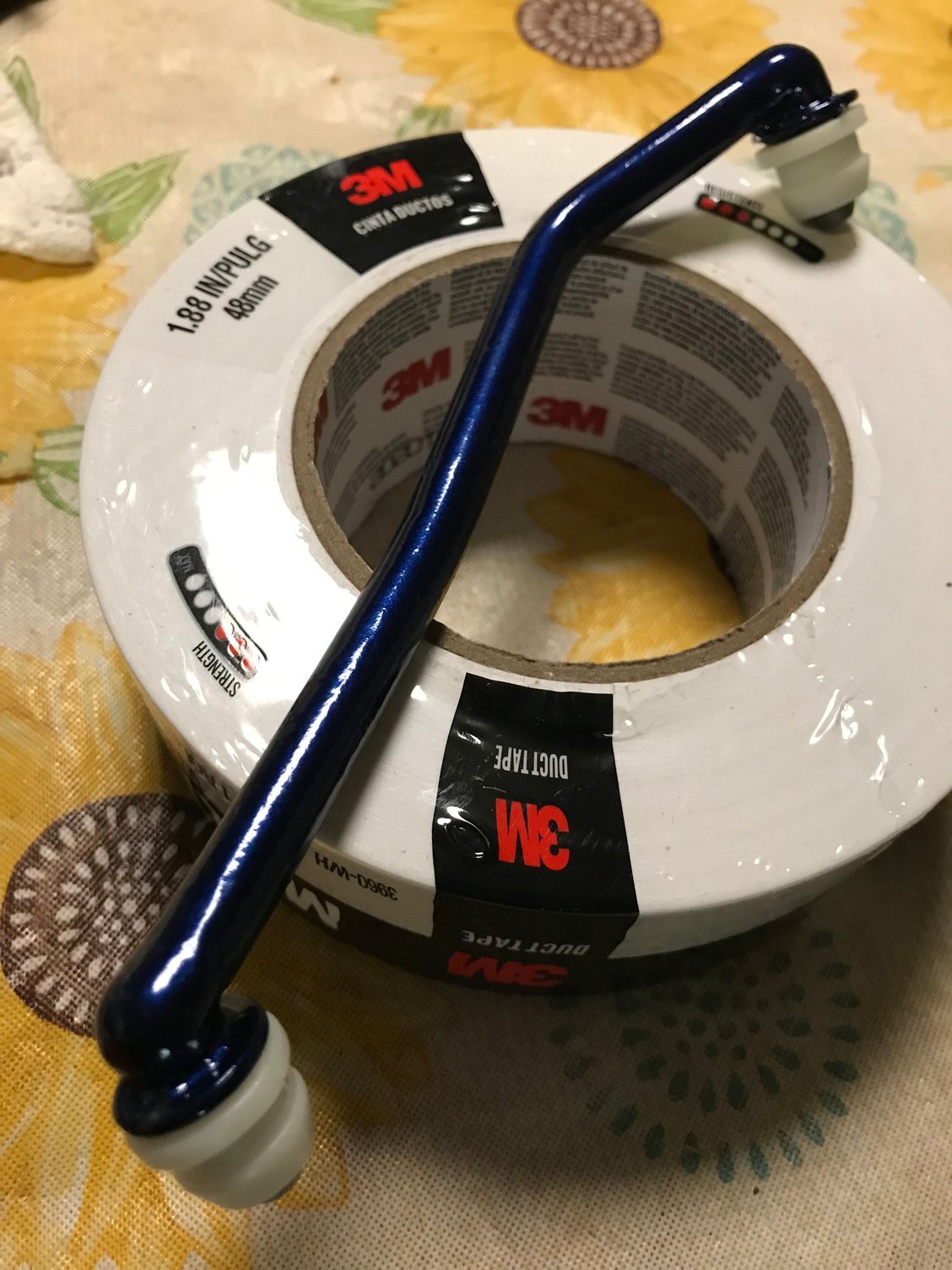

A member from grandmarq.net hooked me up with the missing trans linkage piece. Cleaned it up some and put on a coating of POR15. When the weather dries up; I will spray some Royal Blue on there and call it a day.

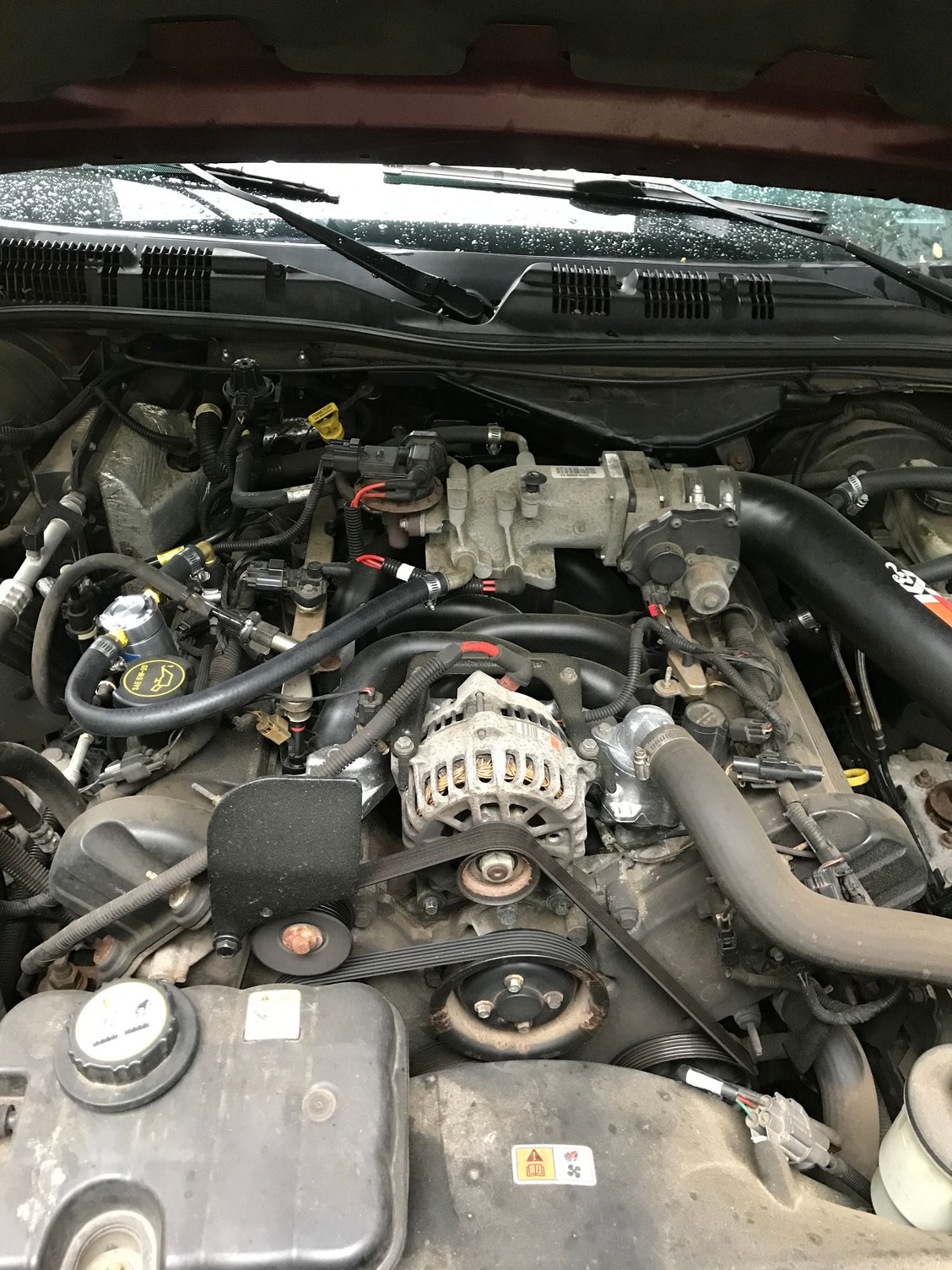

I couldn't get motivated to go out and work on the Crown Vic today. So I decided to tackle the Grand Marquis PCV catch can project. Since the ports on this Steeda catch can are 1/4" NPT; and the PCV valve and throttle body ports on the 4.6 Ford are 5/8"; I initially tried to step it up with adapter fittings from Home Depot. That made the hose run way too long and I couldn't get it to fit. Last week I was ordering house supplies from Amazon and remembered to look up and order 1/4"NPT to 5/8" barb fittings. That made the hose run much shorter. I had forgotten that the fuel supply line is in the way; so I routed the hose around it. Doesn't look too bad; and it should serve its purpose.

Man, that looks good. I think you did an excellent job with the routing.

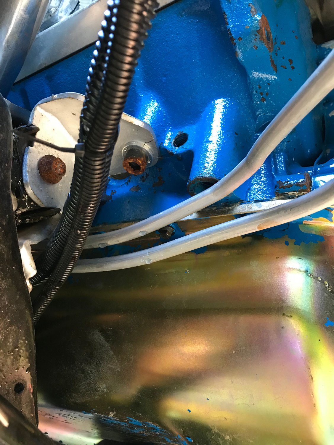

My friends over at grandmarq.net immediately confirmed that those freeze plug threads are 1/4" NPT; when I asked a few days ago. I had a plug from Home Depot of the same size, but wouldn't thread into the hole. I realized that the hole hadn't been touched and needed to be tapped. Even so, the HD plug still had a hard time going in. Frustrated, I threw it across the yard for the archeologists to find a millennia from now. My Dad sensing the anger, reminded me that I still have the plug from the oil pressure port. I grabbed that yesterday and with a little effort, it threaded into the hole. Feeling triumphant, I started to fill the radiator again with coolant; and nearly 2 gallons into it, I hear coolant hitting the cardboard underneath; but this time, it was the rear driver side of the engine block. I found the open port, but it is right next to the header collector and I couldn't get a tap in there. I concluded that at least the driver side of the exhaust has to come down so I can remove the header and tap that hole. A bit annoyed, but that is now par for the course with this car.

I had planned on getting some work done to the CV after work today, but a busy week at work and getting stuck in 2 hours of traffic (due to weather) made that impossible. Only managed to install 1 a/c and put bushings on the trans shift linkage. Had to put the bushings in boiling water in order to soften them up for the install. Looks pretty good for something that will be hidden underneath the chassis. Hope to do more tomorrow.
