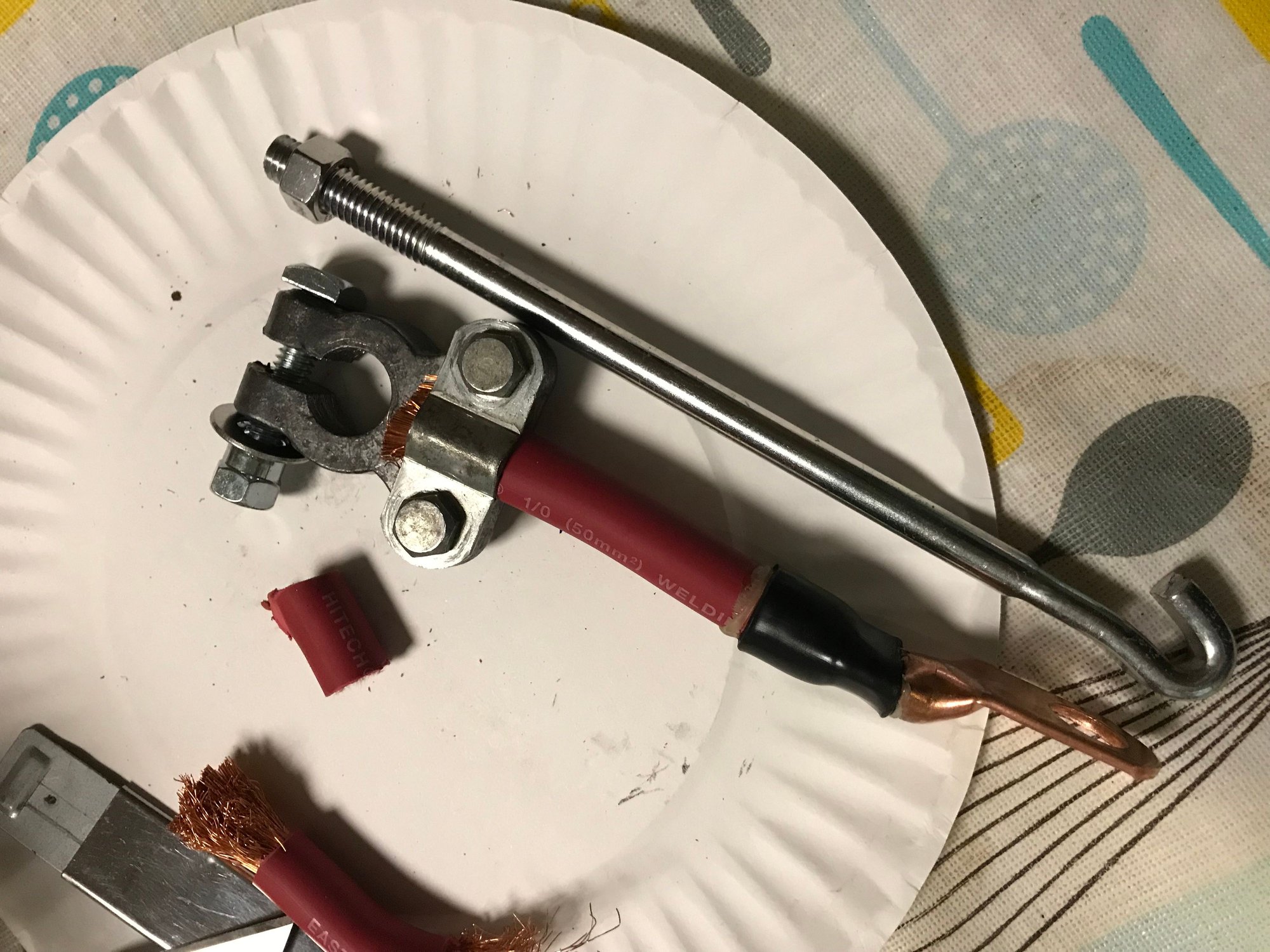

I got a little work done on the Crown Vic over the weekend. I bought a battery and a clean 5-gallon gas can on Friday night. Saturday was spent pulling the car off of the jackstands and scrounging for wood blocks to sit the front of the car on. Yesterday I took the rear wheels off the ground and supported the axle with jackstands; so the drive wheels aren't touching the ground on the 1st start. Installed the battery and discovered that the starter solenoid cable was too long; also, one of the battery hold-down studs needed to be cut down for hood clearance. Got that done and put everything in position after the rain. By the time I got done with all of that, I had to make dinner; so I called it quits and will attempt the 1st start next weekend. I would like to sync the 1st start with the neighborhood landscapers; in case the car is rowdier than it's supposed to be. We have a couple problem neighbors who like to cause trouble for events like this.
