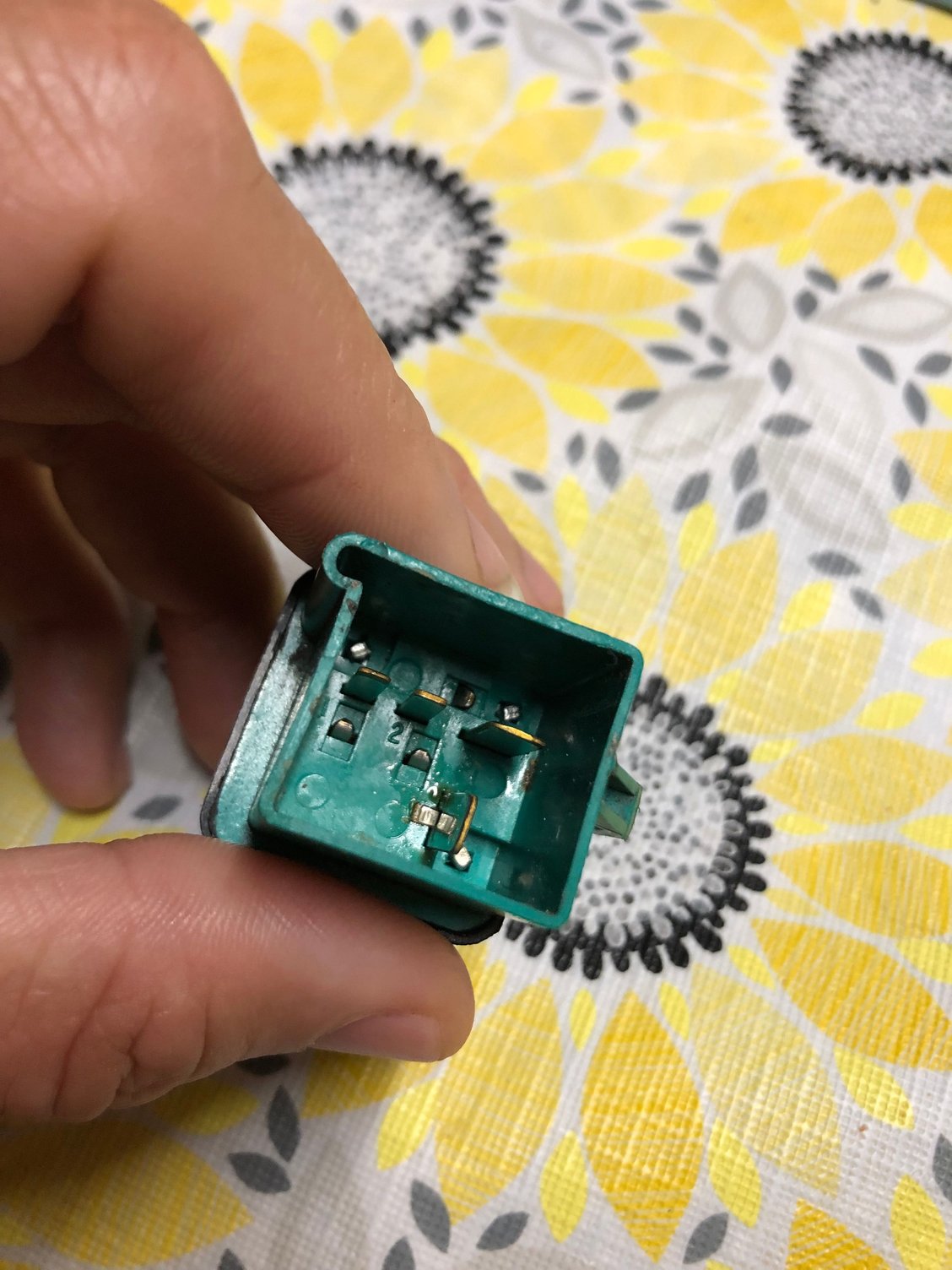

I was inspecting the fuel pump relay whilst pulling the other relays last night and found that my fuel pump relay was kinda cruddy. Then I remembered that I didn't change that out because I had already done so 12 years ago when the fuel pump went south. So I gave the connector and the relay a good blast of contact cleaner and let them dry overnight. I will apply the dielectric grease some time today and plug them back in. I noticed that on the connector end; one of the tabs that hold the terminals in place had broken off. I will hold that wire when I go to plug that back into the relay. If I have the time, I will power up the system and see what I got.. In the meanwhile, I will look for 25 amp relays and matching connectors to replace the fuel pump relay in case that connector becomes a problem.

If those pins don't engage you will indeed have problems. Not unlike the connector you cleaned above. The receiving tabs seem to be not quite aligned which is not always a problem depending on how big the pins actually are.
So if the connector for the fuel pump relay is not secure, I would think it would eventually become a problem. But holding it on to see if the car starts is one thing, if you let go and installs then you know what you need to do

Yah, the accessory relay had a broken pin and the terminal wire had broken off the connector. I ended up crimping on a new terminal and replacing that relay. I should pull that apart and take a look at it. I did steal some time last night to power up the Crown Vic and discovered the situation didn't change; still no fuel pump and no bumping the starter with the key. So I am thinking of disconnecting the A9P ecm and cracking it open to see if the capacitors for those circuits are not burned out. Even though it's a remanufactured unit; I may have burned it out when the ground connector came off of the battery. If this is not the case and the ecm is in good shape; I might send it out to be looked at anyways; as other components could be damaged. Beyond that, I have no idea what to do with this car. I have a friend who has a Banks ecm that he's willing to let go of for a decent price. I may look into that option as well.
