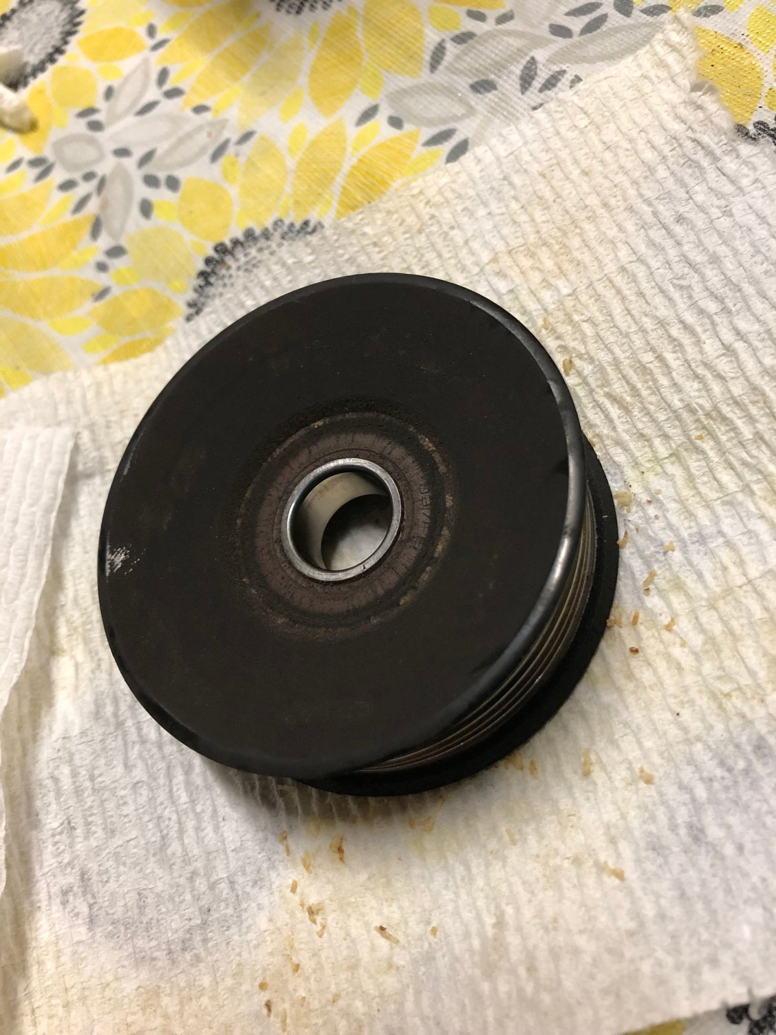

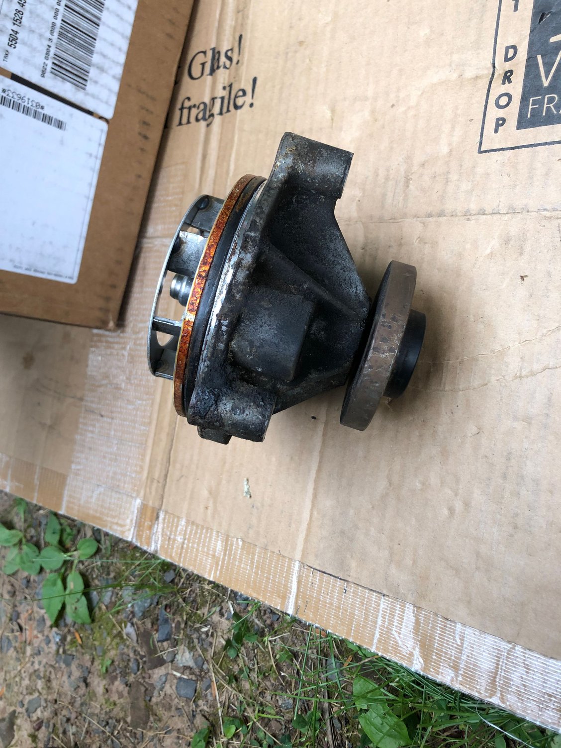

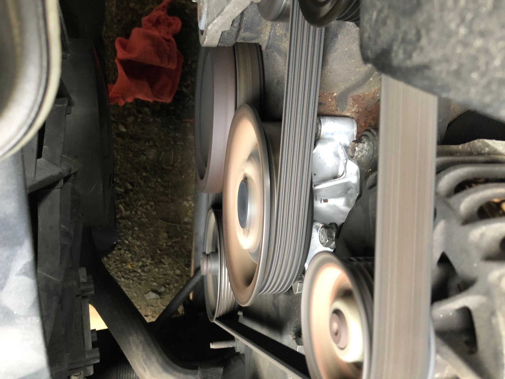

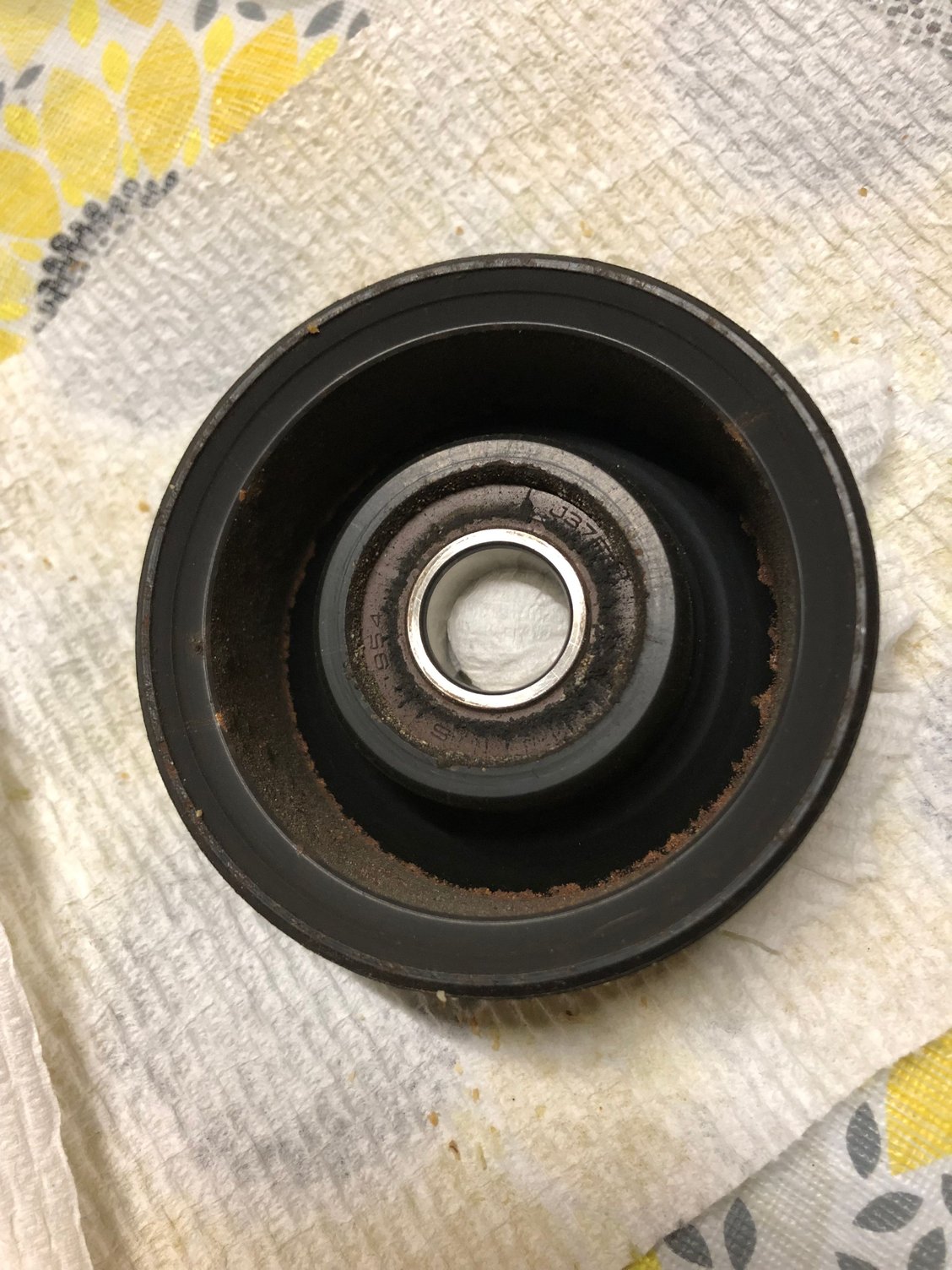

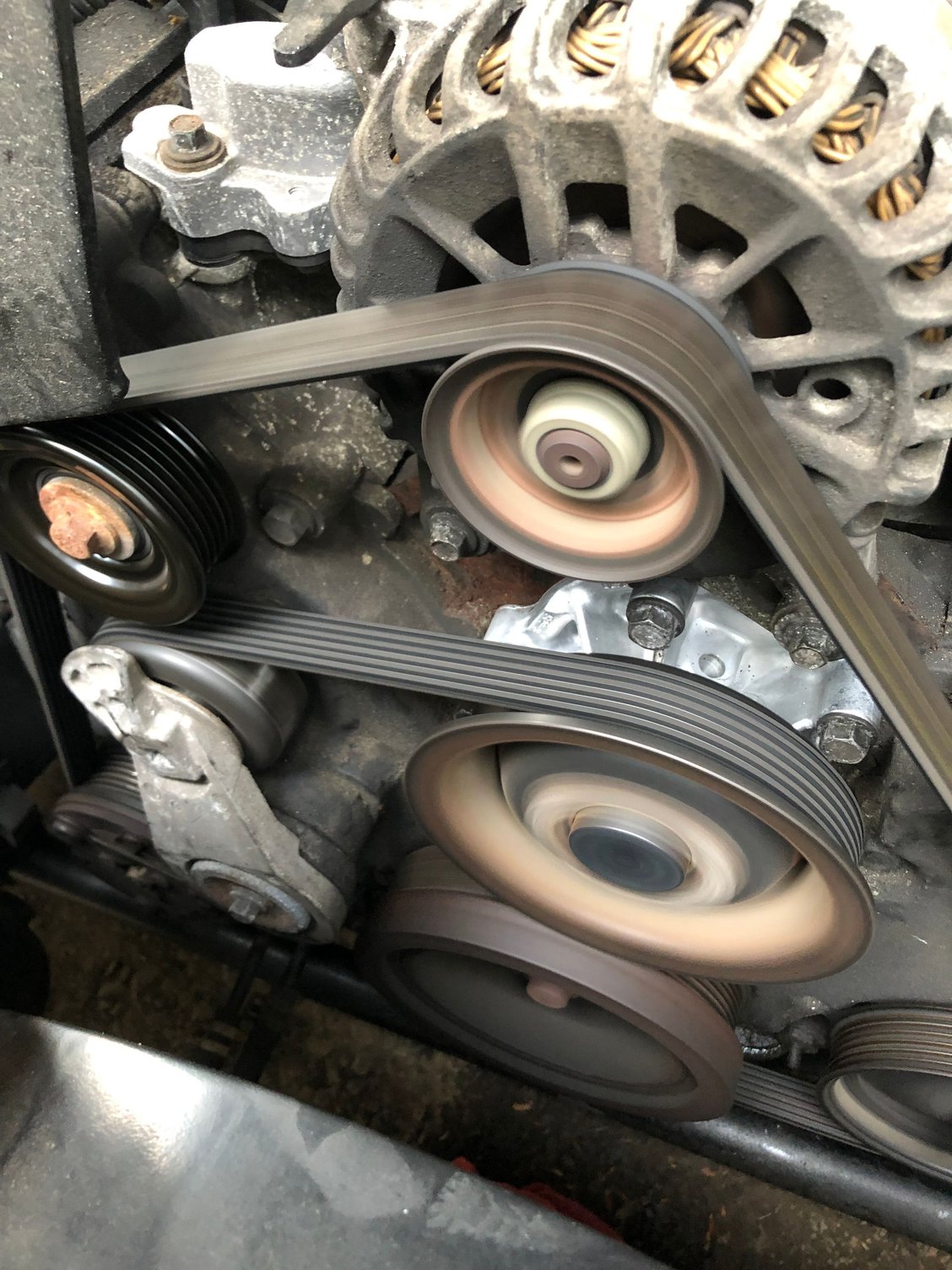

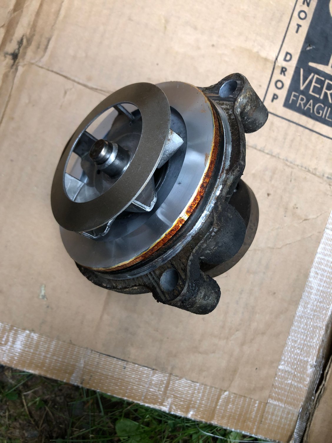

I may have mentioned this before; can't remember; but my car has been making a whining noise at idle and a knocking/crunching noise under load. Fairly loud when I popped the hood; definitely audible inside the car. I was about to buy the stethoscope to help pinpoint the source of the noises when my Dad intervened and told me to pull the belt off and start spinning things. As it turns out; my idler pulley went south; I can feel the bearings as I spin it in my fingers. I was feeling confident when NAPA said they had the idler pulley on the shelf. Picked that up and installed it and no more whining. But there was a little knocking noise that remained. This was the noise I would hear under load. Pulled the belt off and spun the water pump and sure enough it was knocking with me just spinning it by hand. So I went ahead and ordered a Motorcraft water pump, another idler pulley, and an a/c accumulator. I will do the water pump in my driveway; but I will send the car out to the mechanic and have them purge the refrigerant and install the accumulator. With the a/c system purged; I will go ahead and remove the a/c compressor and do the exhaust. Then hand it back over to the mechanic to charge the system back up. This looks/sounds good; but we all know it isn't that simple.........

Changed out the water pump a few hours ago. Was much easier than I thought it would be. And the air impact ratchet made it much easier. Much like the idler pulley; the water pump pulley felt very rough when I spun it; even worse when I took it off the engine and played with it. I can feel a bearing (guessing needle bearings?) or two grinding as I spun it. All in all, the car is much quieter now and runs smoother than it did when I first got it. I also replaced the failing pcv hose with some 12AN hose; as the old hose was collapsing while the car is running. That's what I get for using heater hose. Now I need to get back into exhaust install mode again.
