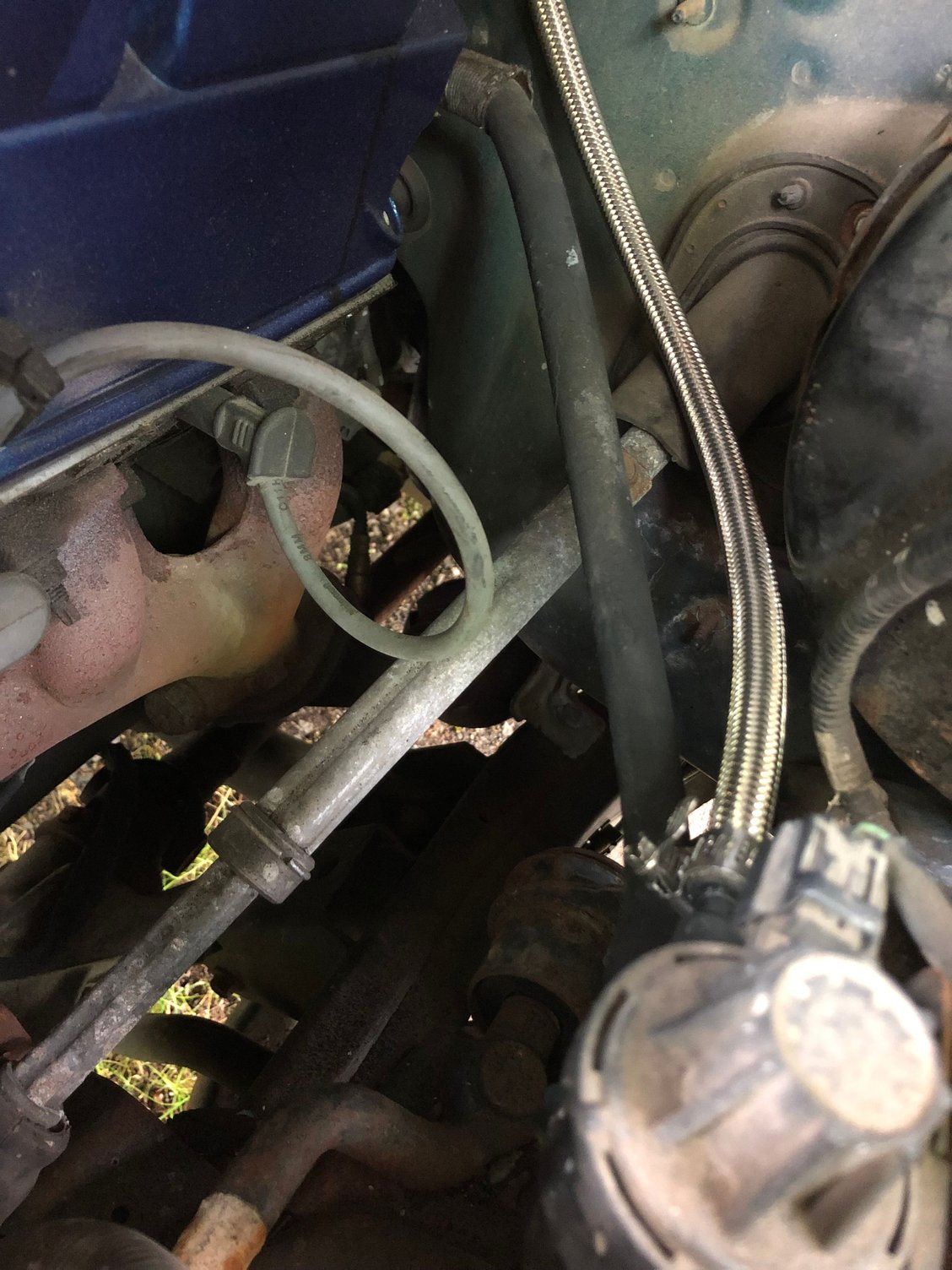

I changed out the fuel vapor solenoid hose that I broke last year when replacing the intake manifold...........sort of

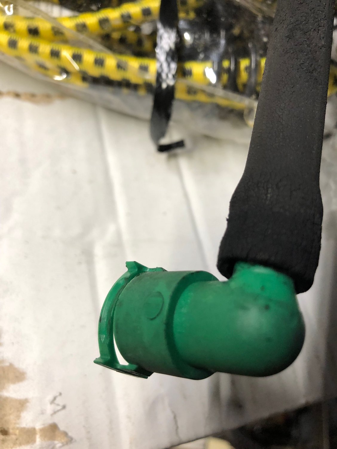

I now know that these fittings are not meant to come off. I just needed to cut the hose off and jam a new hose in its place. My new hose came with the same sorta-style connector, but this one had the plastic strip-collar molded in. Unfortunately, it came rounded off. In order to make it work; I would have to pinch the channels quite a bit; only to have them go back to their original round shape; thus causing the hose to pop back off the intake manifold port. It also came far short of the fuel vapor solenoid; so extra hose is needed to complete the line. I tried to take the connector off the other end of the hose at the fuel vapor solenoid. After breaking the clip and the connector, I realized that maybe they were not supposed to come off; that I needed to remove the hose instead. Which is what I ended up doing. Even broken; it's still stuck on the vapor solenoid. Since I don't have anymore standard 3/8" fuel hose left, I used the next best thing; 6AN hose. It worked well on the vacuum connector fitting I used to join the rubber hose to the 6AN. But the 6AN was a bit too small for the fuel vapor solenoid. So I tried my trick of using the heat gun to get the 6AN really hot; then jam it on the vapor solenoid fitting. Up by the intake manifold end of the hose; I pried the new connector off the hose and jammed the old connector in its place. I used a fuel filter clip to hold it in its place. Seems to work for now. I may have to revisit this in the future. Btw, the old hose was dry rotted and collapsed in a couple spots. Otherwise, I would not have wasted my time on this.

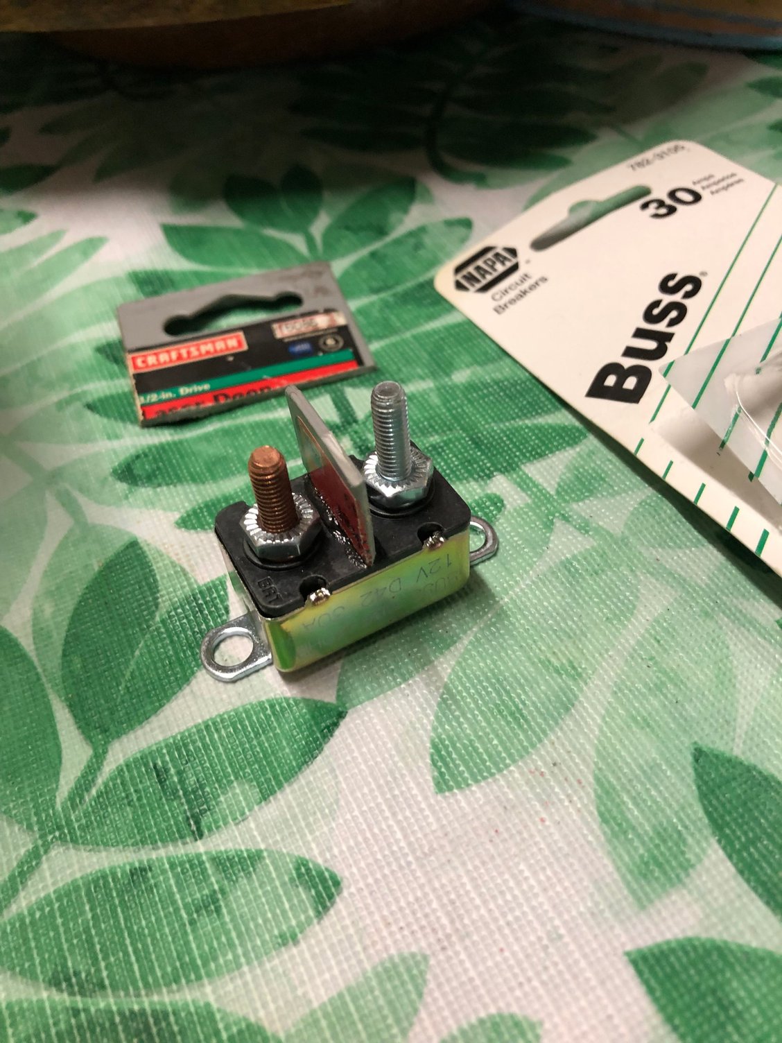

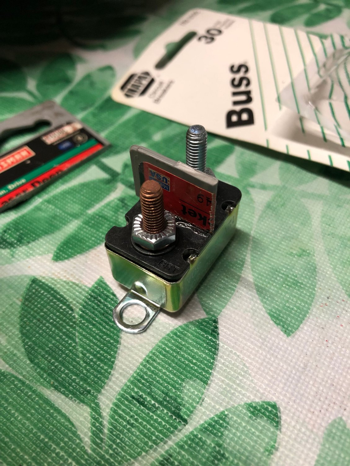

Not much to show here. I am working from home today. As such, we had a brief morning meeting and not much afterwards. So I got the 30A circuit breaker that I had been meaning to install in the Crown Vic; and glued a divider between the 2 poles. I probably could have left it undivided; but the factory circuit breaker had a divider; so I am doing likewise.
