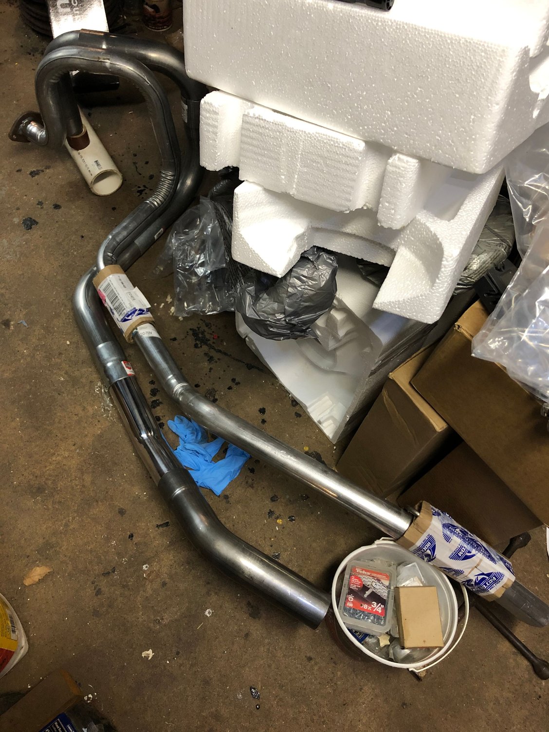

Beginning to think about the full exhaust conversion for the Grand Marquis again. It's August already and I hope to get it done by the end of Fall. Just need to get the Crown Vic on the road before I do that. I've been soaking the exhaust manifold studs down with Liquid Wrench every 2 weeks since June; and will increase the frequency of soakings as I get closer to initiating that project. Just need to get the Stainless Works longtubes, O2 sensors, EGR valve and pipe (couldn't get it to budge when I swapped the intake manifold), and a Pypes X-pipe with the integrated cutouts. Everything else I have waiting in the basement; including a pair of gawdy '90s 4" Pacesetter resonated exhaust tips (I was young and gullable when I purchased them).

The Rock Auto tailpipe is the stock replacement for the driver side. The larger pipe that it overlays is leftover 2.5" pipe from the Crown Vic project. I cut the passenger side off of the Grand Marquis last year and made the other side of the tailpipes with that 2.5" piping. At $37 for the Rock Auto tailpipe; I figured that it would be nearly the same cost if I went to my pick and pull in south Jersey or went a few miles over to the auto salvage (not pick and pull) in the next town. I would have taken advantage of buying the complete Stainless Works system, but even their chambered muffler (supposed to be the quieter of the two) is too loud for my taste. I like my quiet large case Dynomax mufflers. And the SW system is expensive; can't justify spending $3k+ for a complete exhaust; on a daily driver.
