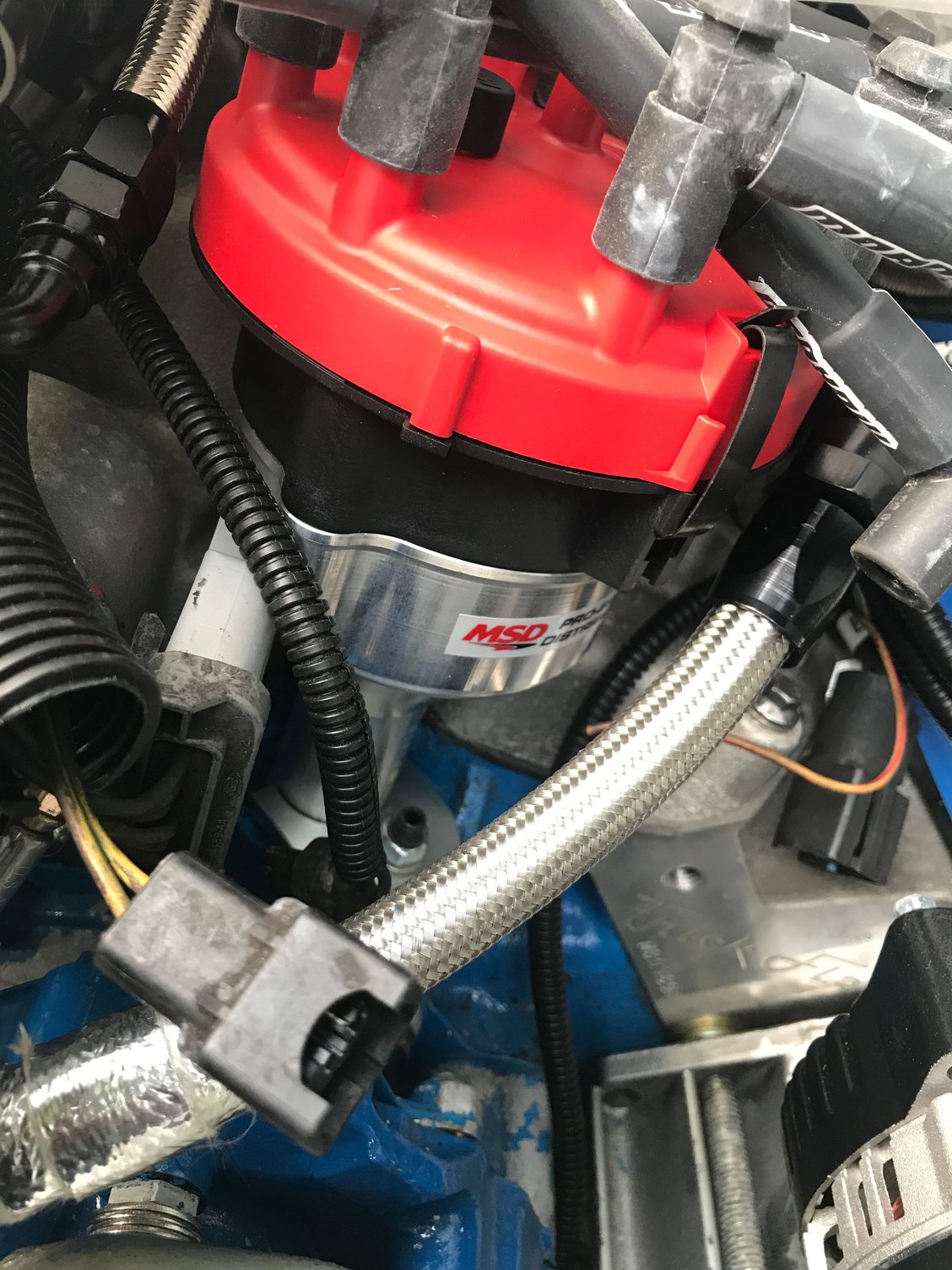

I tried to attempt a 1st start 2 weeks ago; but the weather and sinuses the following day sidelined me. Finally got to it last Saturday and ran into issues. First off; I had a pickle of a time finding TDC on the compression stroke of #1 cylinder. I loosened up the spark plug and heard nothing. So I took a small wad of paper towel and jammed it into the spark plug hole; in an attempt to see it blow out on the compression stroke. That didn't happen; perhaps I didn't jam it in there enough? So I had my Dad come out and stick his finger in the hole while I turned the engine over. I heard hissing; but he said he felt nothing on his finger. I'm not sure how tightly he had his finger in there; but I told him he must be mistaken because I could hear the hissing from that side of the engine. I turned it over some more and I guess he loosened his grip as the second time I heard hissing, he said he could feel the pressure. I may check cylinder pressure when I get this thing running to confirm I got proper compression. After all of that cranking, I took a break because I'm not 20 years old, and all that work made me tired. So, when I got back to dropping the dizzy, it was already running late. But I decided to prime the engine anyways because I would only be running it for 20 minutes. Primed the engine and killed my $50 drill. Once it built pressure, the drill started to labor, and after a minute of priming, it smoked and burnt out. Tried to drop the dizzy and found that my fuel rail fittings were in the way. Not too bad of a problem; as I got my AN wrench, loosened them up, and rotated the fitting for clearance. Then I clocked the dizzy; first time doing so by myself btw. I noticed that it was dark out. So I quit and tried again on Sunday. I cleaned my Milwaukee drill (the one I used for the Saturn oil changes) and primed the engine again; then reclocked the dizzy. Hooked up the battery, climbed in the car, and went to load the tune. I noticed that the dome light wasn't working; figured it might have burned out or sumtin over the years. So I turned the key to power on the system and get the Quarterhorse activated (I think that's how it works, instructions are vague). But nothing happened; no lights; no relays clicking; no fuel pump priming; nothing. I was stumped. Went out with the test light and found no power on the right pole of the starter solenoid; just the battery side where the battery and starter power cable are hooked up to. My Dad came out and discovered that he could bump the starter by applying power to the relay pole on the starter solenoid. So we confirmed it was an ignition issue. I spent the last 2 days scouring the net for diagrams and discovered that I may have switched the wires to the wrong pole when I took the original engine out. All of the fusible links along with the starter power cable go on the B+ pole of the solenoid. So, when I go back out there, maybe tomorrow, I will switch it all over and see what happens. After confirming that is what I did.

Got a question for you, Bones. Is the #1 piston on the driver side or passenger side of this engine? I know back in the 60's and 70's that #1 on a small block Ford V-8 was the front cylinder on the passenger side. Buddy of mine had a 67 Mustang fastback that his dad gave him and he tried to tune it from the driver side front cylinder. It wouldn't run right for him, but he wouldn't listen to me about timing it off the other side. He borrowed his dads car to go get new spark plugs and I timed it off #1 while he was gone. When he got back, instead of being grateful, he was pissed. I told him to fix it himself and left him to it. A couple of days later, he came over and asked me to help him. I did and we went cruising later.

Yes Rubehayseed; you're correct. Passenger side front (toward the front of the car) cylinder is No.1 Your buddy was thinking of small block Chevys with it being on the front driver side of the engine.
