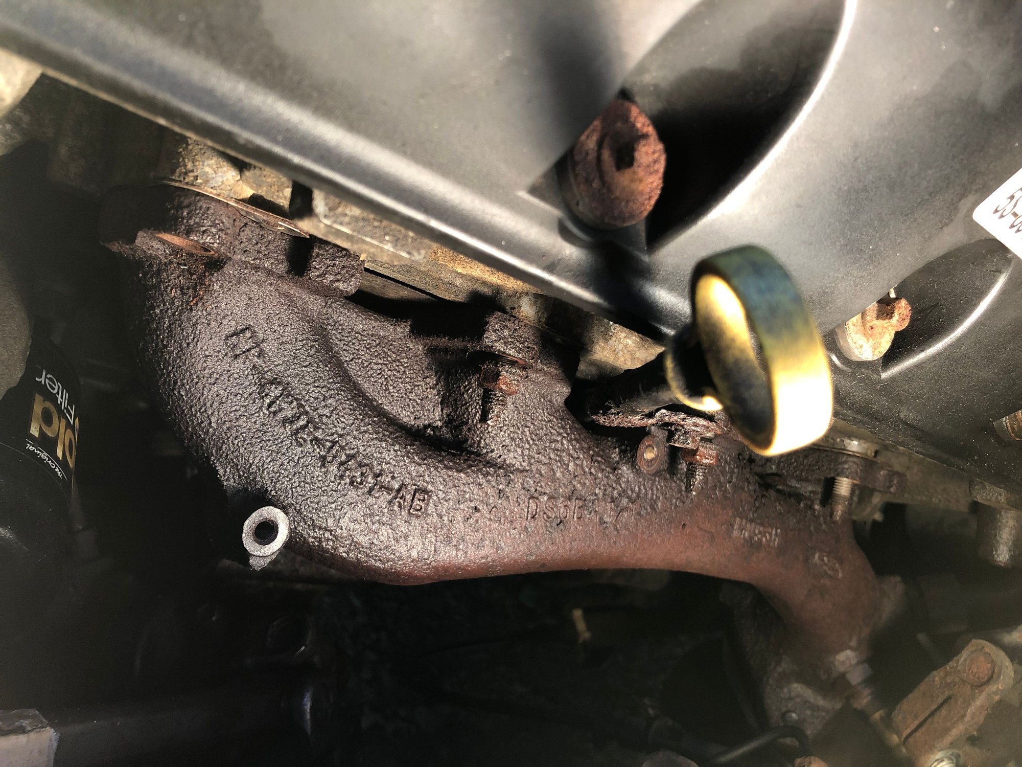

I managed to remove 9 of the 16 studs (actually 4 of the nuts backed off); and loosened another 2 underneath the passenger side exhaust manifold. I will move the a/c compressor out of the way to get at the other 2 studs. I ran back into the problem that I had the last time I attempted to remove the exhaust studs; the 2 that I rounded off. I will come back at them tomorrow with the rounded nut remover socket. I hope that works as I am almost done removing the exhaust manifolds. For some reason my 200psi compressor will only go to 150psi. Not too much of a problem; but for those 3 stubborn studs, I would like to hit them a little harder. Otherwise, 145psi - 150psi was doing the trick with the other studs.

This project is dead in the water. I got 15 of the 16 studs and nuts loosened. One of the rounded nuts reamed itself out when I used the rounded-nut remover on it. At this point, I will have to get a nut welded onto the end of that stud and remove the stud itself. I smeared Never-Seize on all of the studs and bolts that were removed before buttoning it all back up. I will confirm with the mechanic in the next town over if he wants to take a stab at removing that one stud. So, it's back to working on the Crown Vic and the house. Bright side of this is I didn't break any studs and I can still drive the car until I can have it worked on.

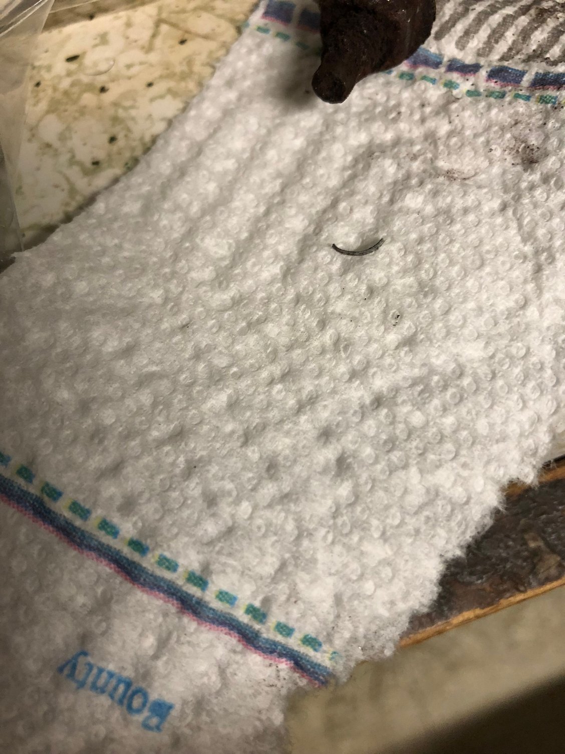

I guess all those frustrating attempts at the exhaust paid off. I got home with a little sunlight left to get a head start on this. So I loosened all the fasteners on the driver side exhaust manifold. Took only 20 minutes. One of the stud nuts that was coming out, got caught at the end and ended up unthreading that stud. When I brought it in to put it among the other studs that came out; I noticed a metal shaving dangling. The stud is in good shape; so I guess it was from the head. My Dad told me to be really careful threading the replacement bolt. Maybe just snug it a little until I get a properly sized tap. So that will be the plan for this.
Tomorrow I will unbolt and move the a/c compressor out of the way and unbolt the passenger side exhaust manifold with the impact ratchet. I hope all goes well.
