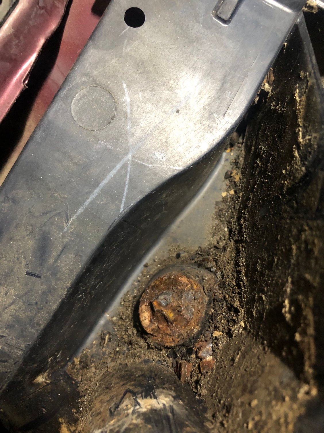

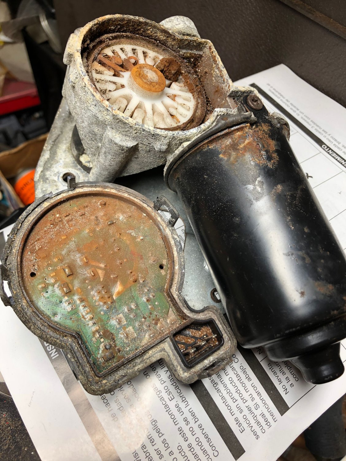

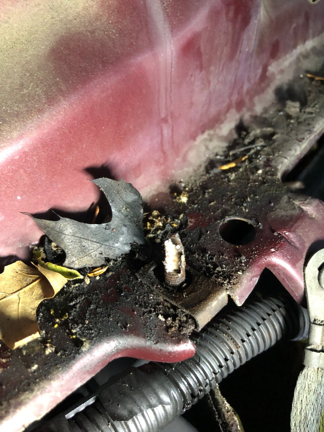

So, one of the issues I had with my daily Grand Marquis was the wiper motor. A couple years after I got the car (2018), the wiper motor started going off by itself. Never had that problem with any of my past vehicles, so I figured the wiper switch/arm on the steering column was malfunctioning; so I replaced it. That temporarily fixed the problem for a couple months. Then the problem re-emerged. Went to grandmarq.net and asked if this was a common problem? The answer was yes and I received a bunch of suggestions ranging from cleaning the cowl area to replacing the wiper motor. I decided to pull the upper cowl cover off for cleaning. That's when I discovered that the wiper motor sits in a box with a drain hole at the bottom. That box was filled to the brim with soil, broken bits of twigs, and leaves. I cleaned that all out and scrubbed the box out with Dawn. Fortunately, we had a dry spell for a month at the time; so the wiper motor had time to dry. And the problem went away for the time being. During that time, I lost a couple speeds on the wiper delay mode; despite cleaning that box every year. I knew that I would probably have to replace the wiper motor at some point anyways. I bought a replacement wiper motor a couple years ago; but I did nothing with it and procrastinated. Until a couple months ago. The wiper motor started activating the window washer pump randomly; and emptied out the reservoir in less than a week of commuting. Now last year, I skipped cleaning the box because of the exhaust project; so that was the first thing I did. The drain hole was clogged after just 2 years. Cleaned it out and slowed the problem down a little. I had 2 weeks of non-activity from the wiper motor. Then yesterday afternoon whilst taking my Mom out for her physical therapy cruise, it activated on its own, and wouldn't stop. I knew the time had come to replace it.
Started this project yesterday evening and was hoping to be done by now. But as many of you know, a job that should only take a couple hours, takes much more than that. It took me a while to get the wiper arms off. The proximity of the hood to the wiper arm pivots and stubborn wiper arm clips made that a tedious task. After that, it went faster.............until I found one bolt that was covered with soil and other debris. After I vacuumed that out; I discovered that the bolt was massively rusted; and somebody had already tried to extract it (without success). It was getting dark last night; so I figured I would try to finagle the wiper motor out from under the lower cowl. After 30 minutes of that, I gave up, soaked the bottom section of the bolt (and U-nut) with Liquid Wrench, and went inside. Had some things to do this morning and obligations this afternoon; but during the day, I thought about ways to get that bolt out. When I finally got to it (6PM), I tried grabbing it with my rounded bolt extractor. That just made the crusty section crumble into a cone-shape. Scratched my head for a few minutes and went to get my drill. Took one of the tiny HF drill bits that I didn't break and drilled into it a little before the bit shattered. Went inside and found my Dad waiting at the cellar door. Wondered what was taking me so long. I explained the dilemma and he suggested I use his cobalt bits and the right-angle drill. That combo worked and I managed to drill what was left of the hex head off. Pulled the lower cowl off and cleaned it real good. I was going to call it quits as it was almost dark; but I went back out and ran what was left of the bolt out of U-nut that was holding it in place. I am going to Home Depot tomorrow and will get a 1-1/2" long 1/4"-20 bolt to replace the one I drilled out; and I have a replacement SAE U-nut. After that I went into the basement to clean the lower cowl. Then I was going to go back up and eat dinner. But, I decided to install the new wiper motor on the lower cowl. While I was at it, I took the old wiper motor apart and found that the bottom of the circuit board was rusted up pretty good. Maybe that was causing it to turn on by itself. We'll see when I reinstall it tomorrow. Hopefully the reinstall goes much quicker. If you read all of this griping; thank you. Here a few pics...............

I'm just wondering why in the hell you waited so long to check it out since you knew it was a problem area for the Merc. Sometimes we're our own worst enemy. Just replace the motor with the one you purchased for it. I'd just toss that old one in the garbage. You might want to open the replacement and make sure it doesn't have all that crap inside it.
