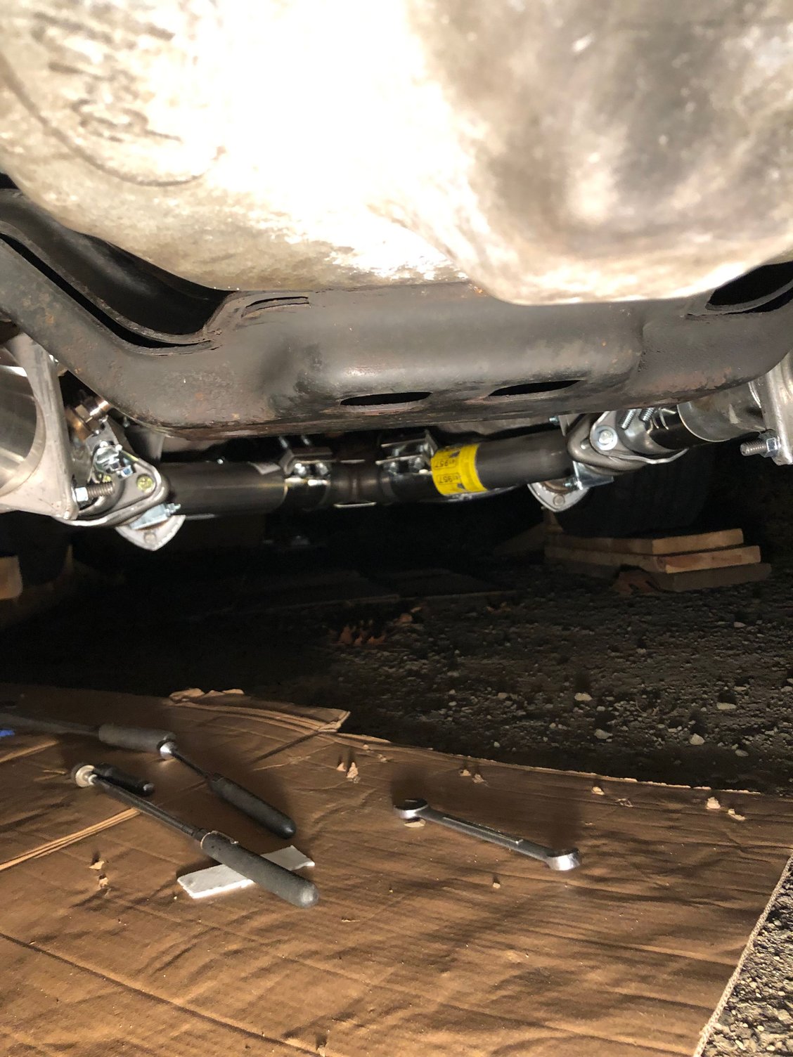

I got some time to work on the Grand Marquis yesterday. I put the X-pipe back up and ran into the same problem I had with the Crown VIc. The exhaust is too long. So I took it back down and figured out how to cut it back a little. Went back out and put it up again. For some reason it wouldn't go up; and for whatever reason the cutouts were hitting the floor pan and the X-pipe wasn't matching up. I looked at it, scratched my head, took everything down and started cutting. My first mistake; as if I sat and looked at the mismatched X-pipe a little longer, I would have realized that I reversed the pipes at the flange because I failed to mark them a week ago. So when I went back out and put them back together; the correct way, and they didn't match up again. Then I really started scratching what's left of my hair off my head. I then realized what I had done and took everything back down. I found a 2.5" coupling and a decent length scrap pipe and made one side longer at the 45* bend. Then went back under the car, measured it out, and cut the pipe to match the X-pipe. Put everything back up and realized that it is off center (using the driveshaft as the centerline), but pointing back straight. I'm okay with that because it's not a show car. The sun was going down and I needed to get cleaned up to make my meeting. I glanced at the X-pipe as I was packing up and now I am wondering if the system is still too long. I will see tomorrow when I get back out there.

I went back out there yesterday and put everything up. I realized that I just don't have the equipment, proper place, and skills to make this work the way I wanted it to. The mufflers, although moved back a bit, are still very close to the axle. And I don't have enough room to put the S-pipe to raise the mufflers. So, I did the only thing that I could think of and use 2 aviation clamps linked together and hung the mufflers; then used the clamps to raise them up a little. They point upwards now; but I don't fear them scraping anything. This is a job that I can't do without a welder. That has been the problem all along (with both cars). So, I will install the air intake, a new belt, and fill it up with oil to get it running so I can bring it to the mechanic for the oil dipstick tube repair. Then find a place that does exhaust systems and see if they can make what I got work. That's the plan for now. I will post pics later when I load them up.

The exhaust is almost up against the floorboard. I might have issues with the cutouts because they are the lowest point of the exhaust and I couldn't push them far enough back behind the floorboards without sacrificing the mufflers that I want to run. As you can see, I like to use flanges. They make taking the exhaust apart much easier. Hopefully this will make the oil dipstick tube removal/replacement easier for the mechanic.
