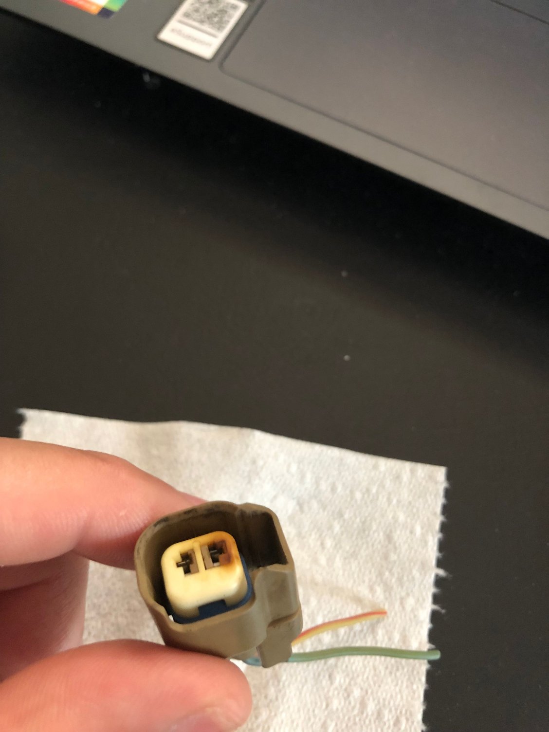

Got the wiper motor finished a day after the last post. The motor stays put and is quiet when it is wiping the windshield; and I have all wiper speeds now I will need to take the upper cowl back off, as I broke the fitting that feeds the washer fluid nozzle. I also finished off the wiper motor box cover. It's a pain to get it to close right; and during my first attempt at cleaning the box; I broke the cover. Duct tape solved the issue at the time. This time as I tried twisting it back into its channel, it completely broke in half. So a junkyard trip is in the distant future for the whole upper cowl assembly. I also discovered that whilst attempting to remove the wiper motor out from below the cowl (unsuccessfully), I hit the fuel injector plug with my elbow and broke the catch. So this passed weekend, I replaced the fuel injector connector. Looks like the green wire terminal was burning. Don't know if it's because of the elbowing or if it had been like that for a while. When I finally get around to installing the electric cutout on the exhaust, I will pull the rest of the fuel injector connectors and check the condition of their terminals.

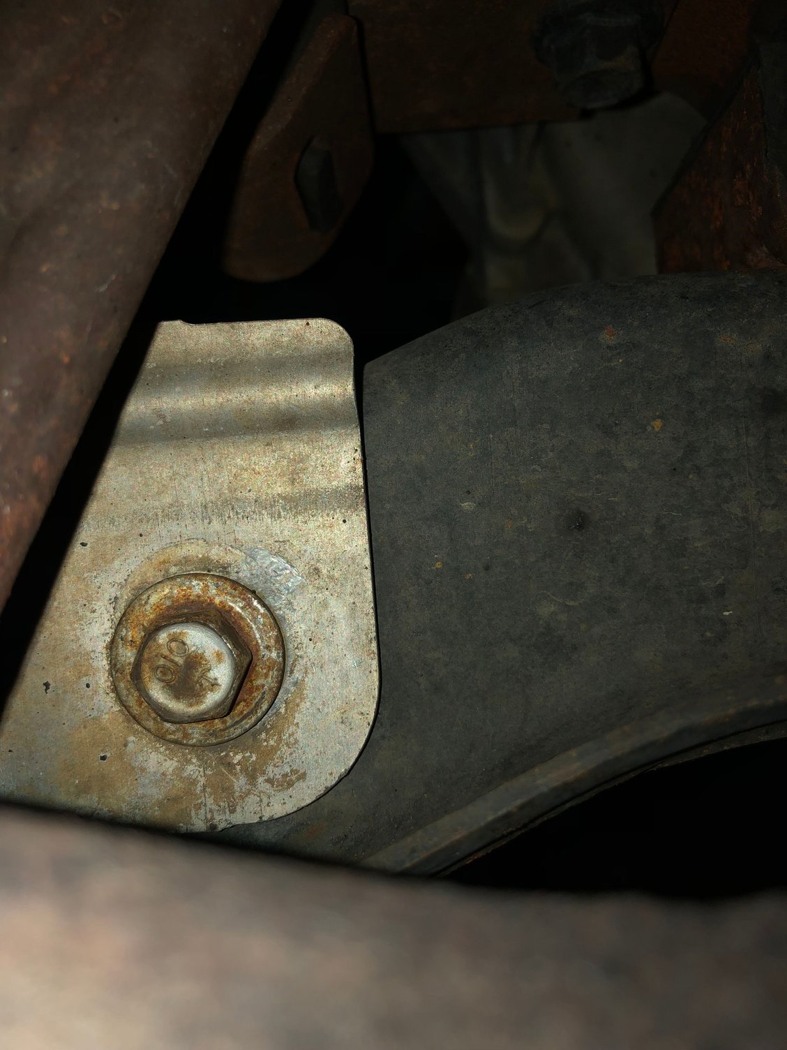

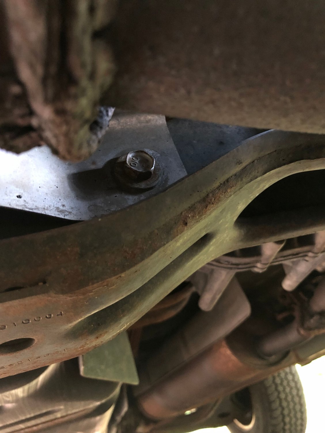

The weekend prior; I used to prep the Explorer for the trip. I attempted to change out the fuel filter, but found that one of the bolts for the heat shield around it, was cross-threaded; or bent. It would start to unthread; and bind up solid. Soaking it didn't help. Since the exhaust runs right next to it; I will have to drop it in order to get an impact tool of some sort in there. Hopefully that will get that heat shield off.

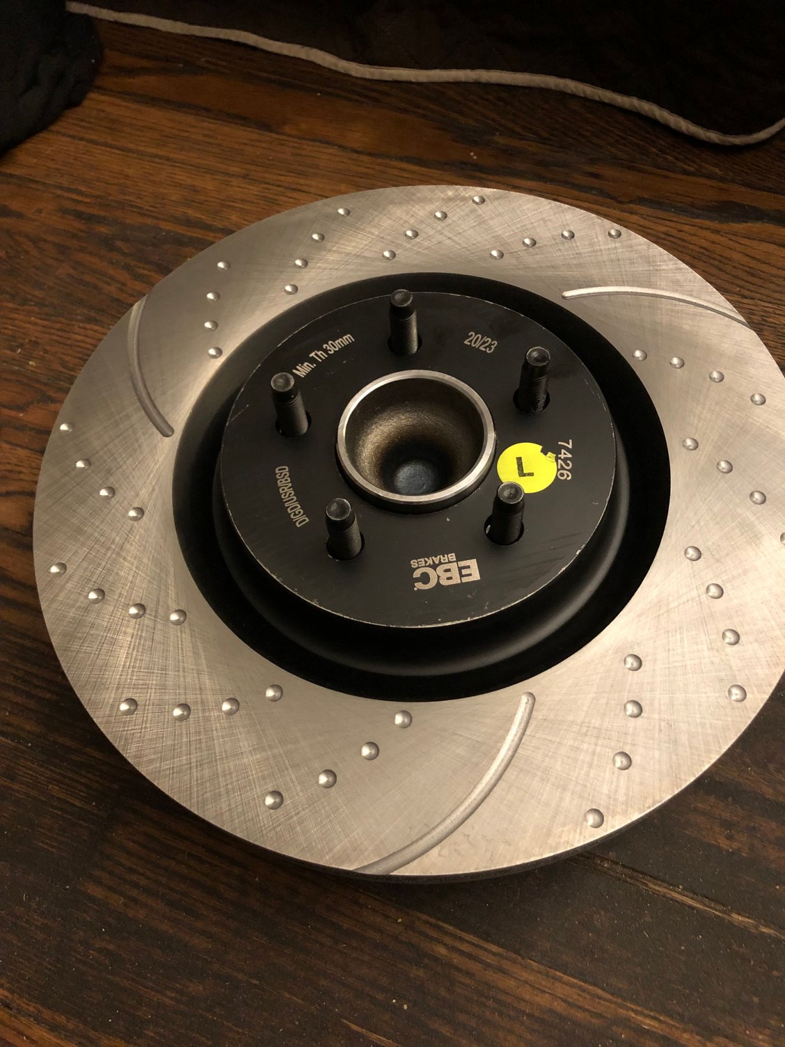

Finally got my GT500 rotors for my daily Grand Marquis last Friday. Had been on backorder for 2 mos. They fit up against the Moog hub/bearing with no problem. I was afraid that I would have to find somebody to machine them if they didn't fit. I took some time off a couple weeks from now for the big brake install. Hopefully it isn't too bad. Couldn't come sooner though; my driver side hub is trashed.

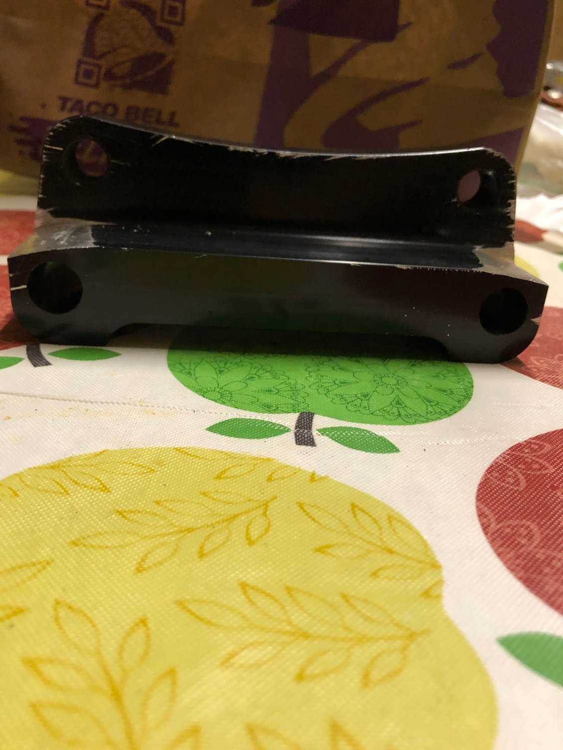

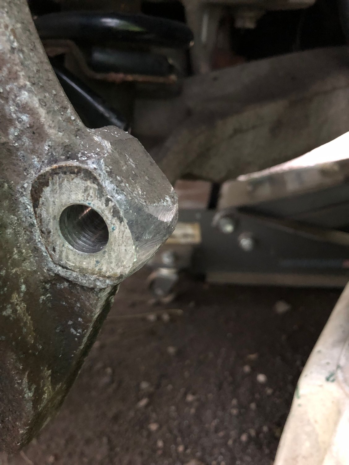

Friday rolls by with a T-storm in the morning to make the driveway nice and wet for this work. I get out there in the afternoon and re-tighten the hub/bearing bolts and start assembling the big-brake bracket. Unfortunately, the bracket was unfinished, and I had to file it down a bit to get it to semi-fit. By the time I figured that out, another T-storm rolled through. I went in and ate a late lunch and fell asleep. Woke up to sun. I was told that the T-storm didn't last too long and it had been sunny for a hour as I slept. So I ran out and played with the bracket some more. This lasted 45 minutes before another T-storm rolled through. In that time, I filed the casting flash off the spindle flange to get the bracket to fit.
More rain early this morning made the driveway more wet. I had some engagements this morning anyways, so I waited until the early afternoon to mess with this a little more. I mounted the GT500 rotor and caliper. Discovered that the caliper was hitting the spindle in the same area where its bracket was hitting. I took everything off and put it back together about a half dozen times to file it down for fitment. When I finally got the caliper mounted clean, the rotor was locked against the caliper on the piston side when everything was tightened down. I started shimming with thin washers and pushed it away a little, but still had contact. And that is where it ended as 2 T-storms rolled through. At this point, I am giving up and putting the old stuff back on; and hope it lasts another week or two. I'll see if I can source replacement calipers as the stock driver side is not wanting to back out when I lift the brake pedal.
