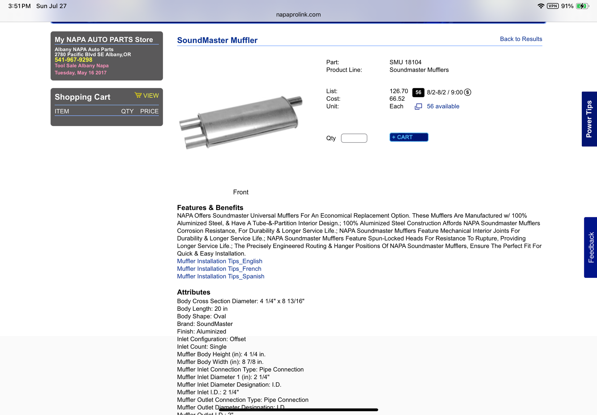

Old Jul 27, 2025 | 05:55 PM
Posts: 3,296
You might need to use a universal muffler like this. 2.25” in, twin 2” out, one on each end.
