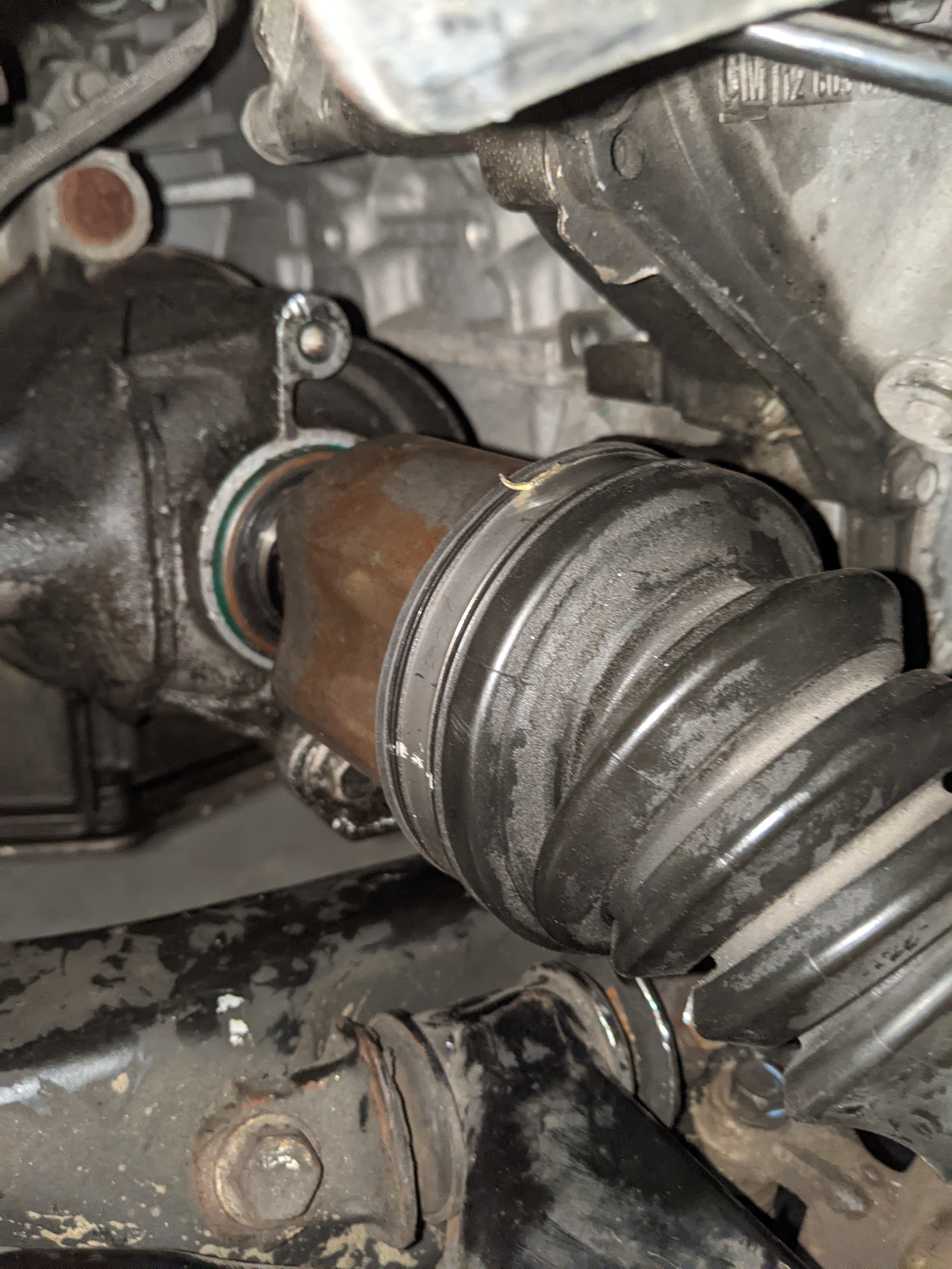

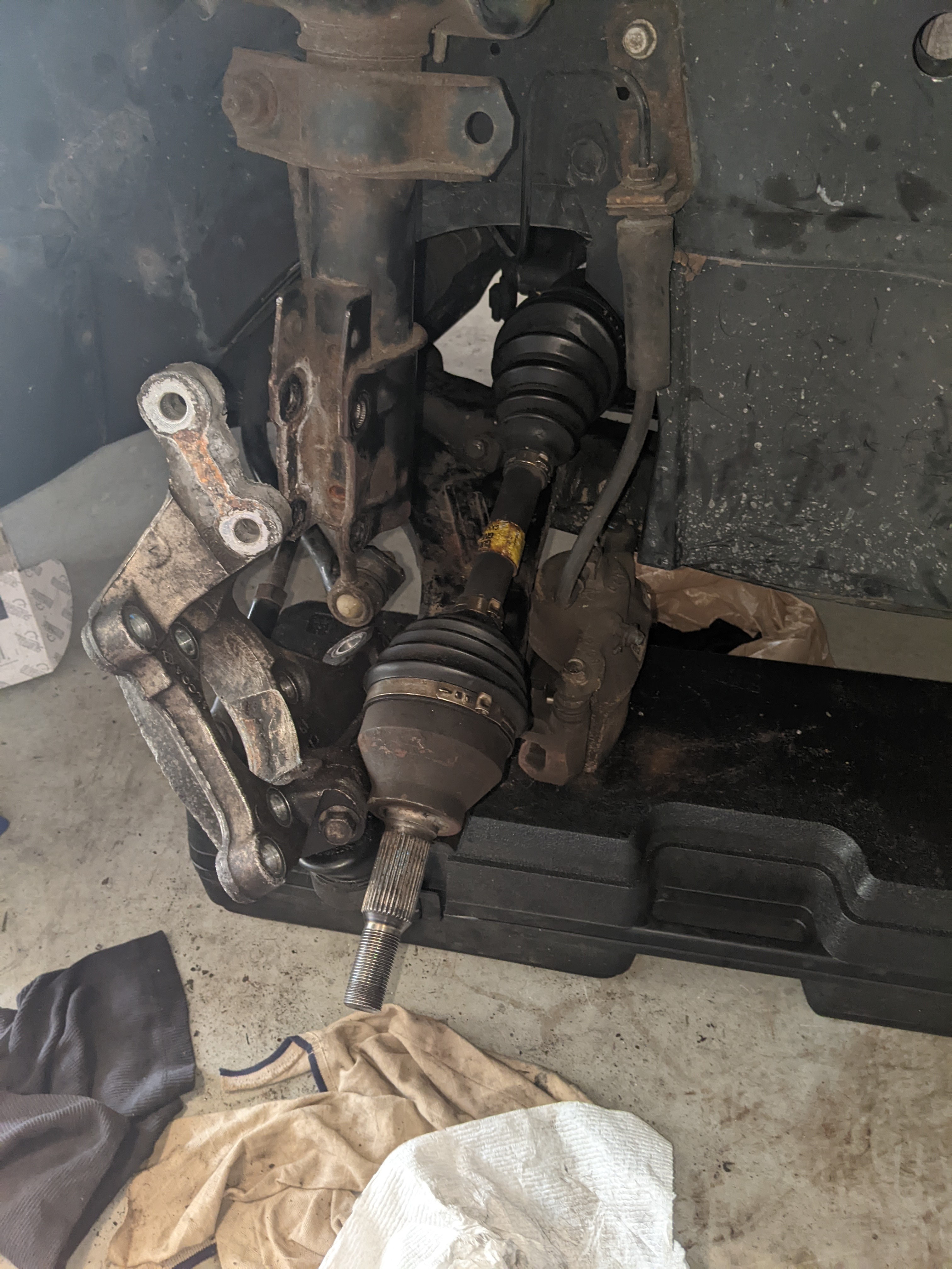

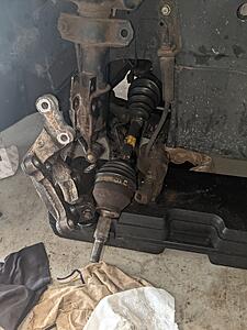

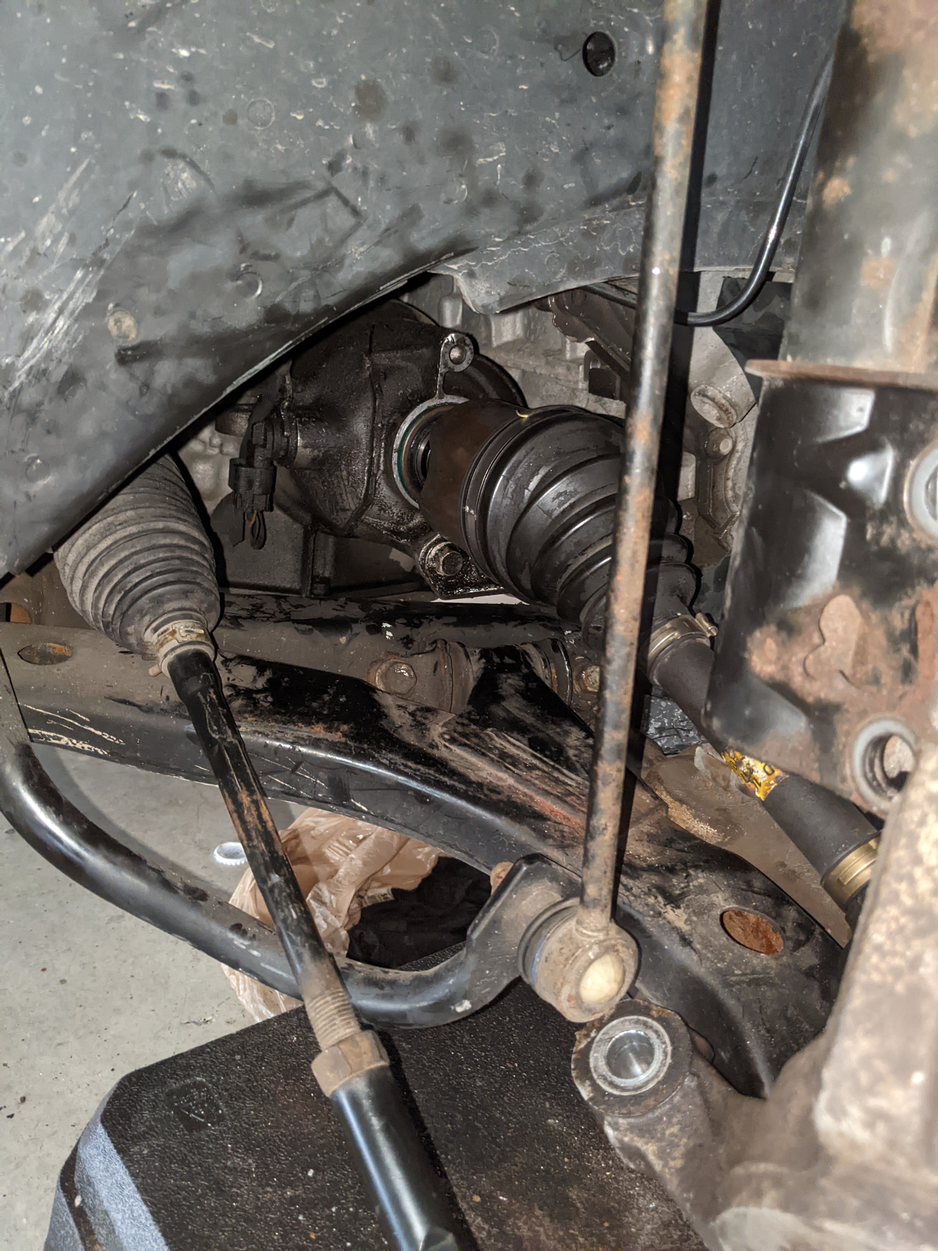

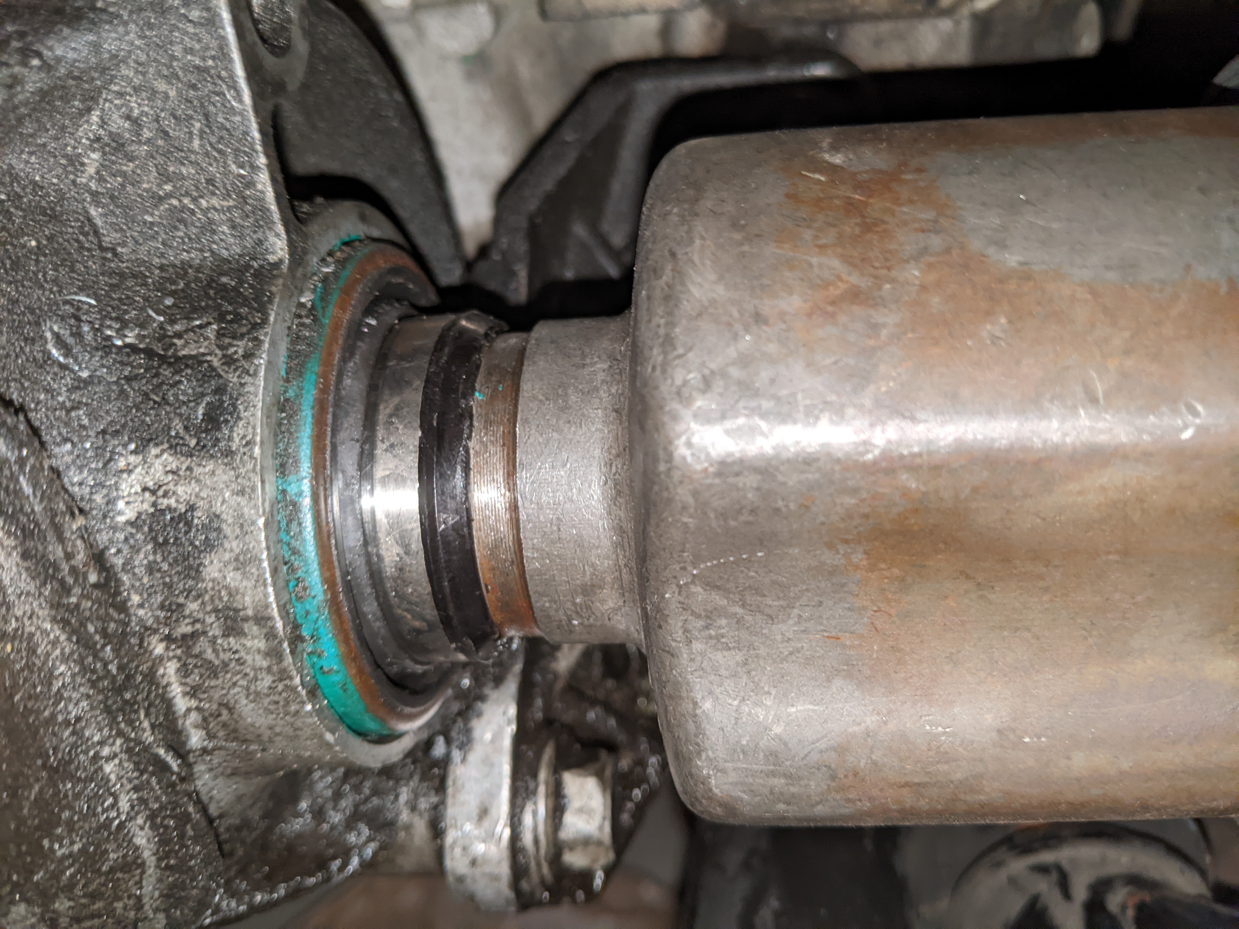

Yes, I am trying to remove the axle from the transmission. After I put the car in neutral, I was able to turn the axle to the right.. for instance, as if I'm screwing it in.
The transmission is automatic. It is the front passenger side. The axle is free from the outboard end. I attached pics.

Good pictures! See this video of the passenger side axle being removed from a Chevy HHR (same setup as your Ion). According to RockAuto, your axle has a stub shaft at the inboard end. This is covered in the video. You will note in the video that the mechanic is using a pretty heavy hammer with considerable force to separate the components. So keep at it! Don't be afraid to whack it good! You'll get it done.
