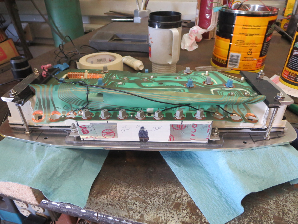

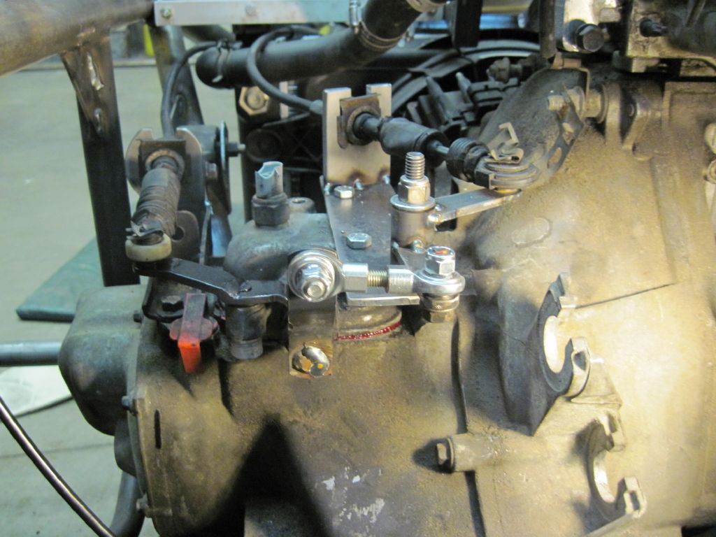

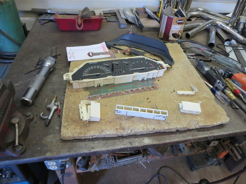

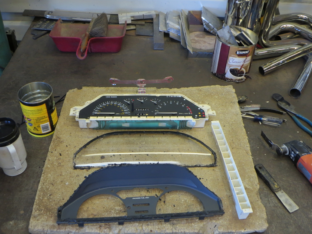

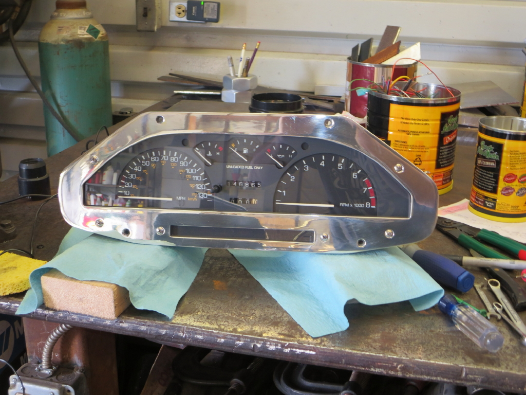

A couple of pictures of the instrument cluster modifications, and a pic of the shifter linkage modifications.

So, does it have a manual trans or an automatic? I can't tell by the picture...
Old Oct 18, 2015 | 09:06 PM
Handy1's Avatar
Joined: Oct 2015
Posts: 11
From: Sugarcreek Ohio
Default Modified Saturn Trike
The transmission is a standard shift. In the bottom right of the pic is the mounting ears cast into the block for the stock location of the shifter cables. It was a real trick getting the shift pattern just the same as in the car. You will see in the pic that things are not welded solid but just tacked down. I learned the hard way that you tack and test before you weld it 100%. A lot easier to take back apart if things don't go as planned.

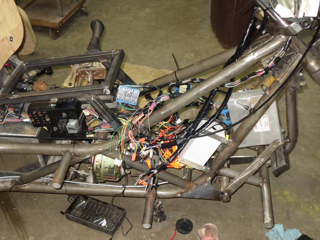

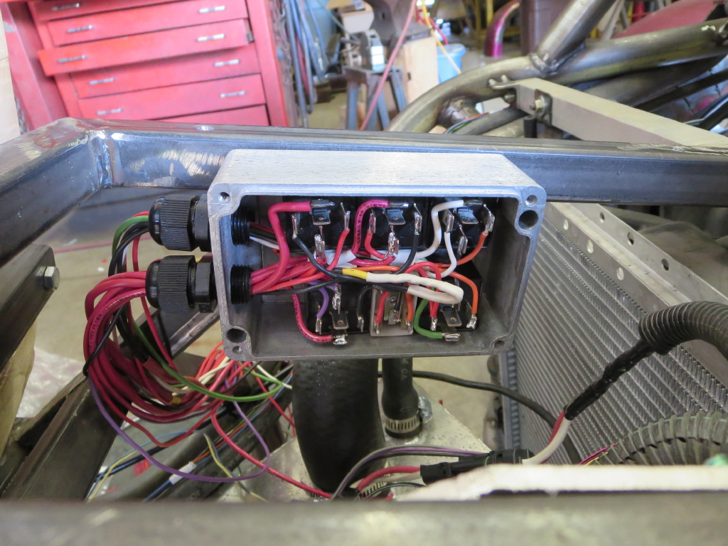

A couple of pics of the wiring nightmare. The box with the relays is so I can use the standard HD handle bar switches.
