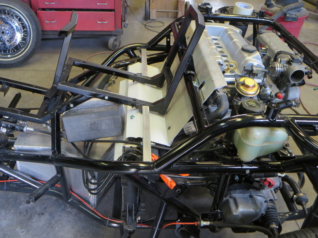

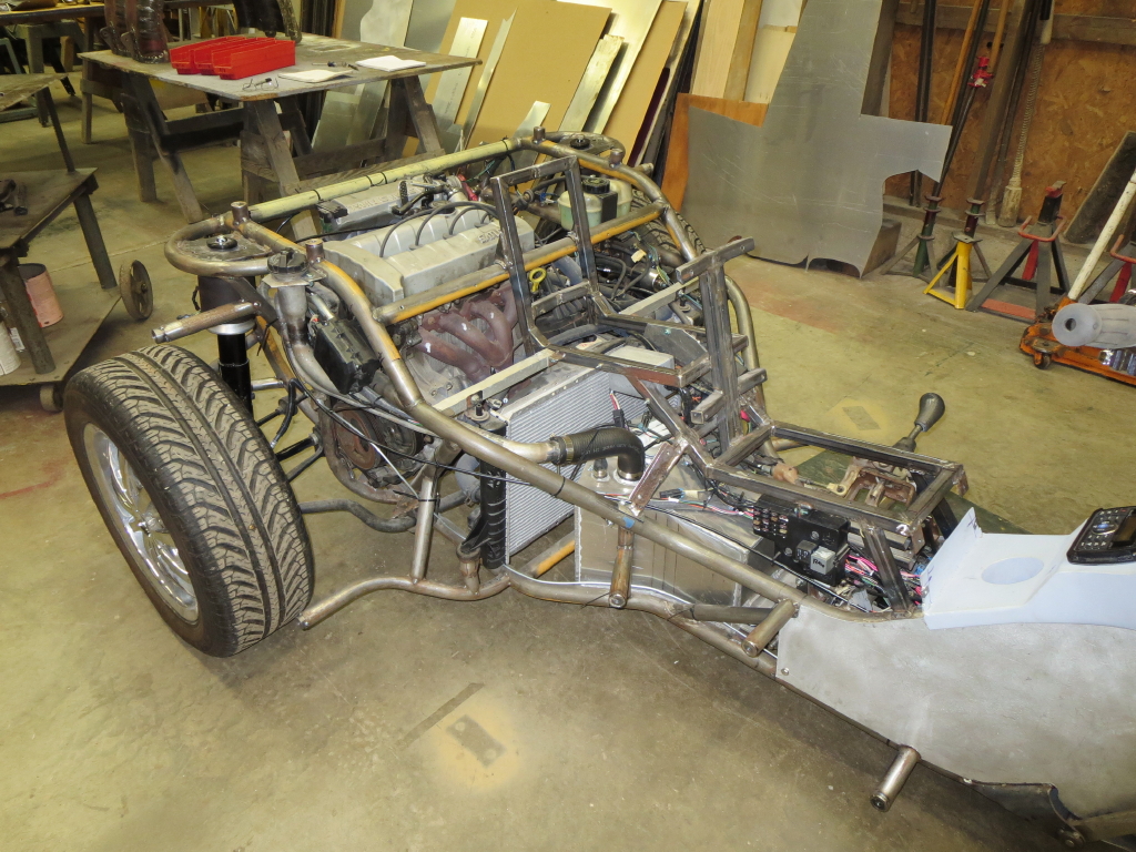

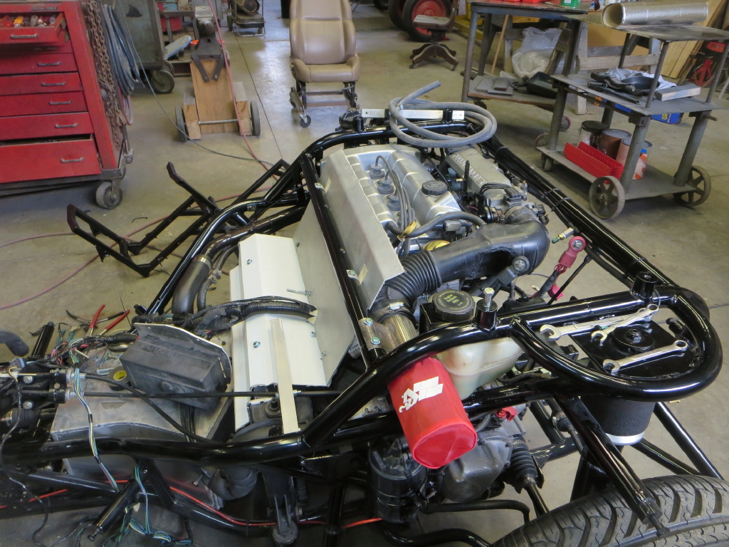

My put up a picture of my custom trike built out of an old 1992 Saturn. Here are a couple of pictures during final assembly. I would also like to know if anyone has any information in regards to an aftermarket ECM. I plan to overhaul the engine this winter as it has 145,000 on it. I does not use very much oil but I am running really hard. Can't resist the right grip (throttle). Also I am planning to turbocharge it using whatever I can get either at a junk yard or on craigs list. I figure a turbo off a similar liter engine 4 cylinder twin cam should work. If anyone has any info in regards to what type of car I should buy the turbo off of it would help.
