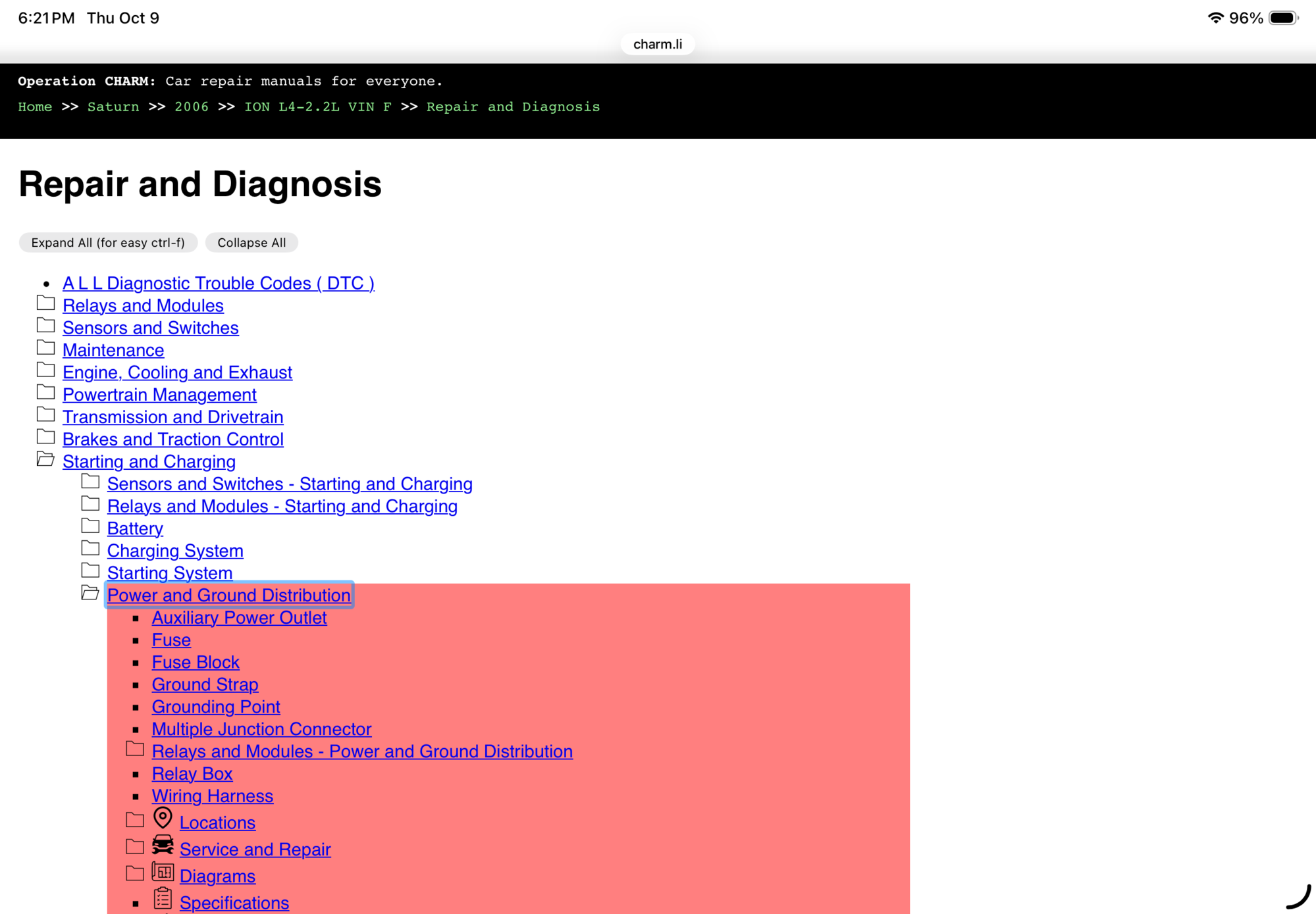

We can help, but you need to help also. Here is a link to the auto repair manuals online. I just looked at the fuse box and what the fuses do on your car.
