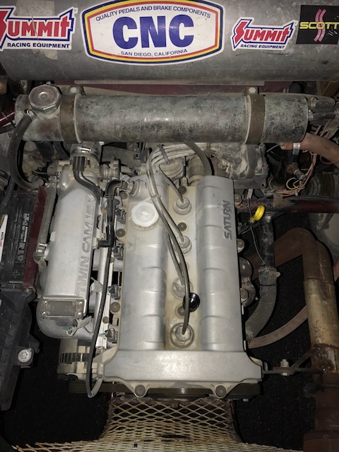

Pardon, me for being absent. Work is sucking away all of my time. Driven this thing only once since last post.
Here is the engine pic.
I have located an electric speedometer pulse generator ring from PacificCustoms.com. Now I have to figure out where the PO has hidden the connection. Hopefully it is taped up somewhere and not cut.

From the stampings on the throttle body and the aluminum valve cover, it seems to predate 1995, as the 95 DOHC had the twin cam stamping on the cover. I have a 95 SC2 w the DOHC motor.
It is however possible that someone who knows the aluminum valve covers seal better threw one on a later model engine and got an older throttle body to match.
11,000 mi on a pre-95 DOHC? Definitely a rebuild. The wiring looks like crap b c it is original from the early 90's..
EGR is prob gone but.it would have been a vacuum controlled, not solenoid controlled
EGR before 95.
MAP sensor position is consistent w pre 95.

Even if the leads are cut you can just buy a new sensor (pigtail you can find in a junkyard) and we'll try to help you figure out the correct terminals on the PCM to attach it to. Actually I doubt anyone would go to the trouble of removing the sensor or removing ALL of the wire to the PCM. I can pro look up wire colors if you need me to.
Anyone who knows Saturn wouldn't try to rebuild a 91 (freak show), so I'd say you can narrow it down to 92-94 DOHC.
