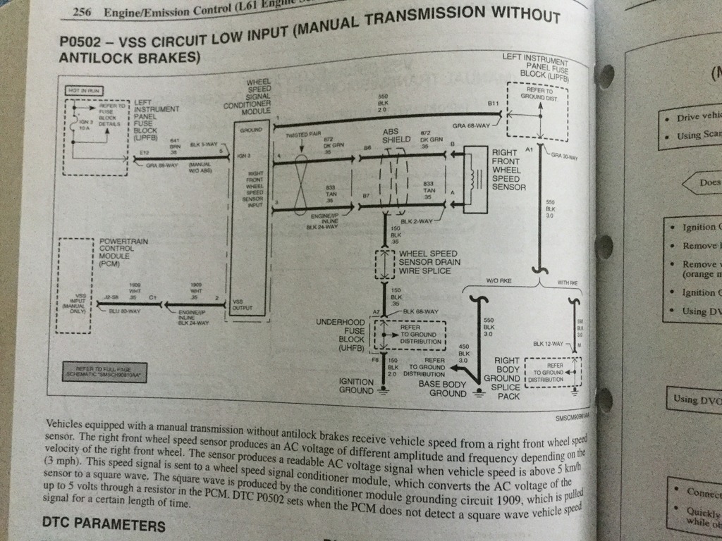

1 Attachment(s)
Those pictures will work. On my 2000 ls there was one wheel speed sensor on the rf wheel. This drove the speedo through the pcm then to the bcm. Attachment 1453
