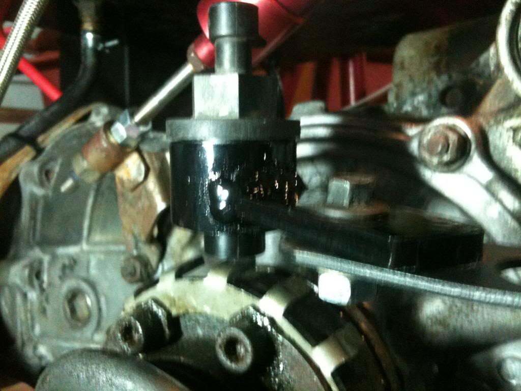

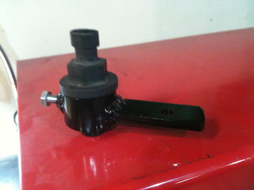

I'm definitely talking about a rev limiter. It just starts to make power when it starts bouncing off the governor. I'm guessing 3000-4000 rpm (I don't have a tach yet).
I asked about the PM in hopes that perhaps the OP had contacted you to fill you in on the outcome but for some reason remained anonymous.
On Samba, a VW site, another fellow has done this swap back in 2015. Here is the pictures he posted of his VSS solution. I just don't know how it turned out other than there are pictures of his vehicle on the road.
So far these are the only google results I've found that seem applicable. My buggy does not have a VSS that I can find so I have to figure out a mechanical, hardware, or software solution.

Old May 22, 2017 | 09:12 PM
Those pictures will work. On my 2000 ls there was one wheel speed sensor on the rf wheel. This drove the speedo through the pcm then to the bcm. Name:  IMG_0069.jpg
