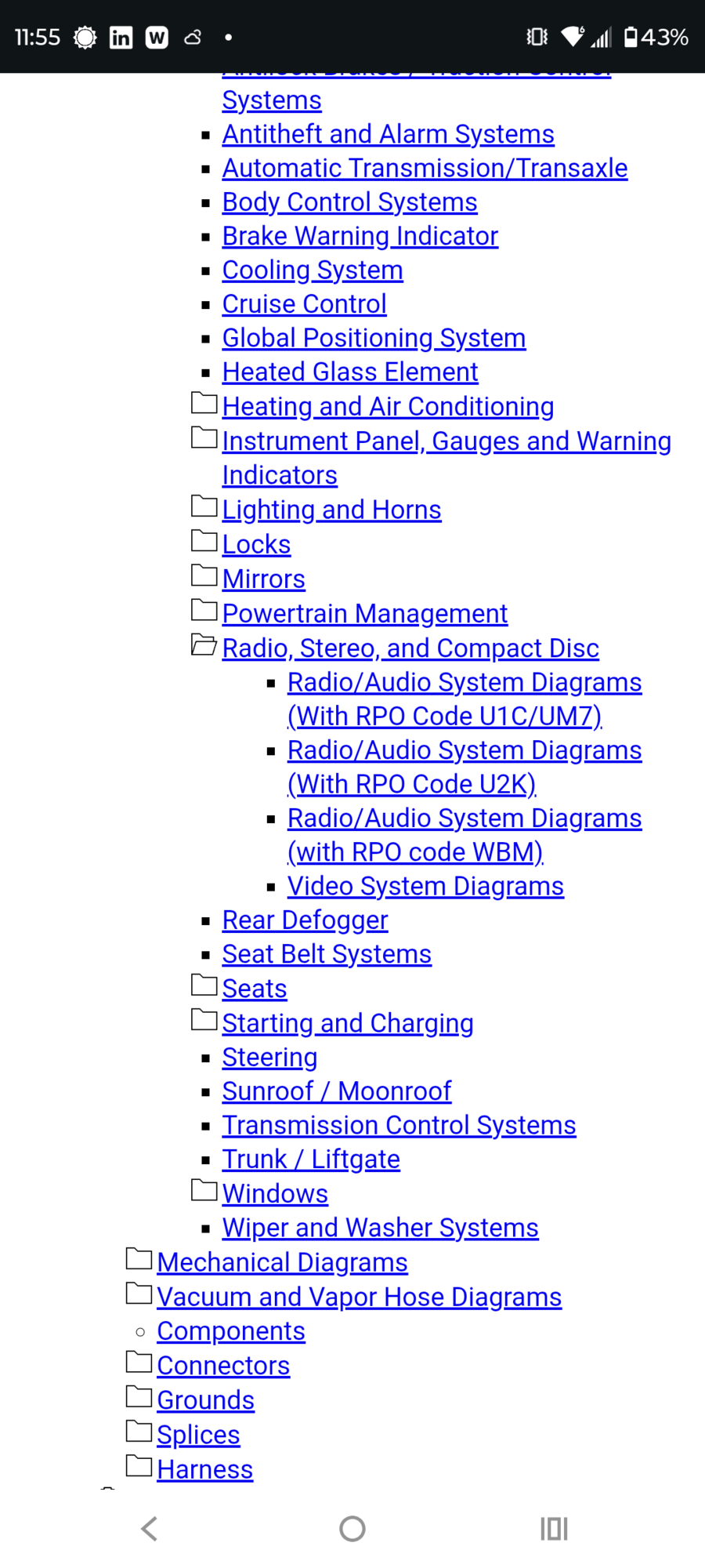

On the L series cars with the factory amp, the amp harness connects between the radio and the factory speaker harness. Cars without the factory amp, the speakers connect to the radio. I have installed aftermarket stereos in L cars and disconnected the amp harness and used the factory speaker wires. Look at charm.li there are three different schematics for the three radio configurations available on 2004 VUES. Colors and connectors are listed. These are copies of factory service manuals, you just have to explore to find what you need. It is all there.

I believe Andy is referring to
located on the charm.li site
For example,
https://charm.li/Saturn/2004/VUE%20A...d%20Diagnosis/Operation CHARM: Car repair manuals for everyone.
Home >> Saturn >> 2004 >> VUE AWD V6-3.5L VIN 4 >> Repair and Diagnosis >> Diagrams >> Electrical Diagrams >> Radio, Stereo, and Compact Disc >> Radio/Audio System Diagrams (With RPO Code U1C/UM7)
for the first one listed in the screenshot.
I gave you the full path so you know where to find it. You can always start at charm.li and never get your way through the tree, or use the bread crumbs in the link above to jump from one level to another
