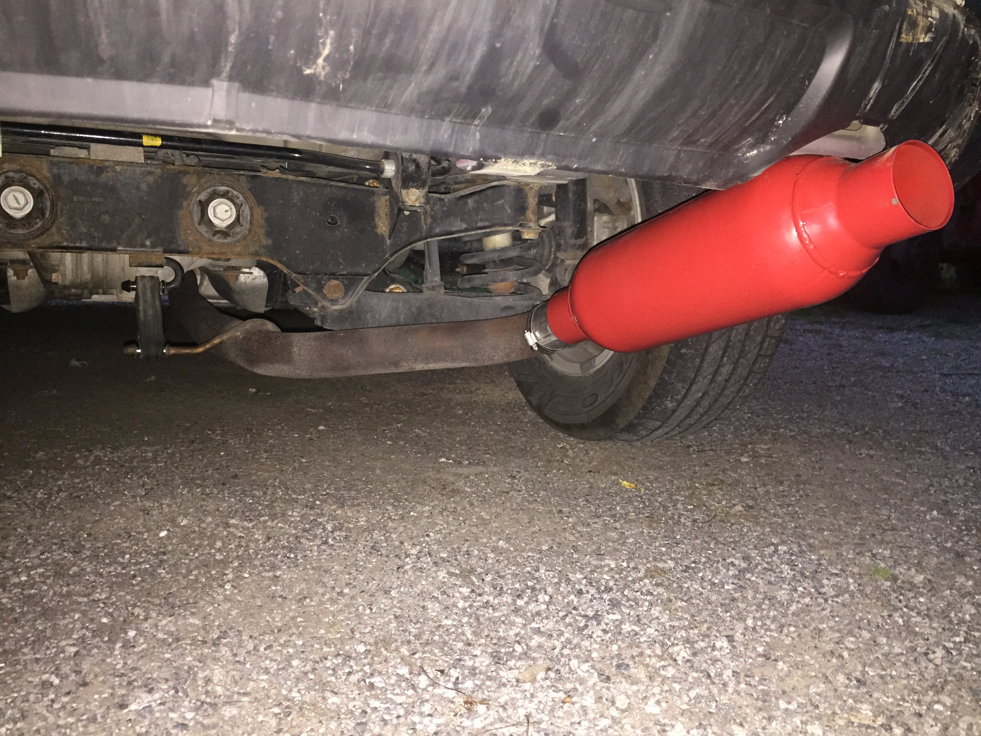

So i noticed that the grey plastic fake diffuser was the cause of the vibrations so i removed said trim and cut a bit of the bumper off as you will see in the picture.

It's just too close. You need to angle it down about 30 degrees or so. And you should be able to do that with a couple of cuts where the cherry bomb attaches to the exhaust pipe.
Old Jul 20, 2017 | 04:48 PM
What he said. An exhaust shop could make you the perfect length piece w a slight bend --> problem solved. And you can put the trim back on so it need not look disheveled.
