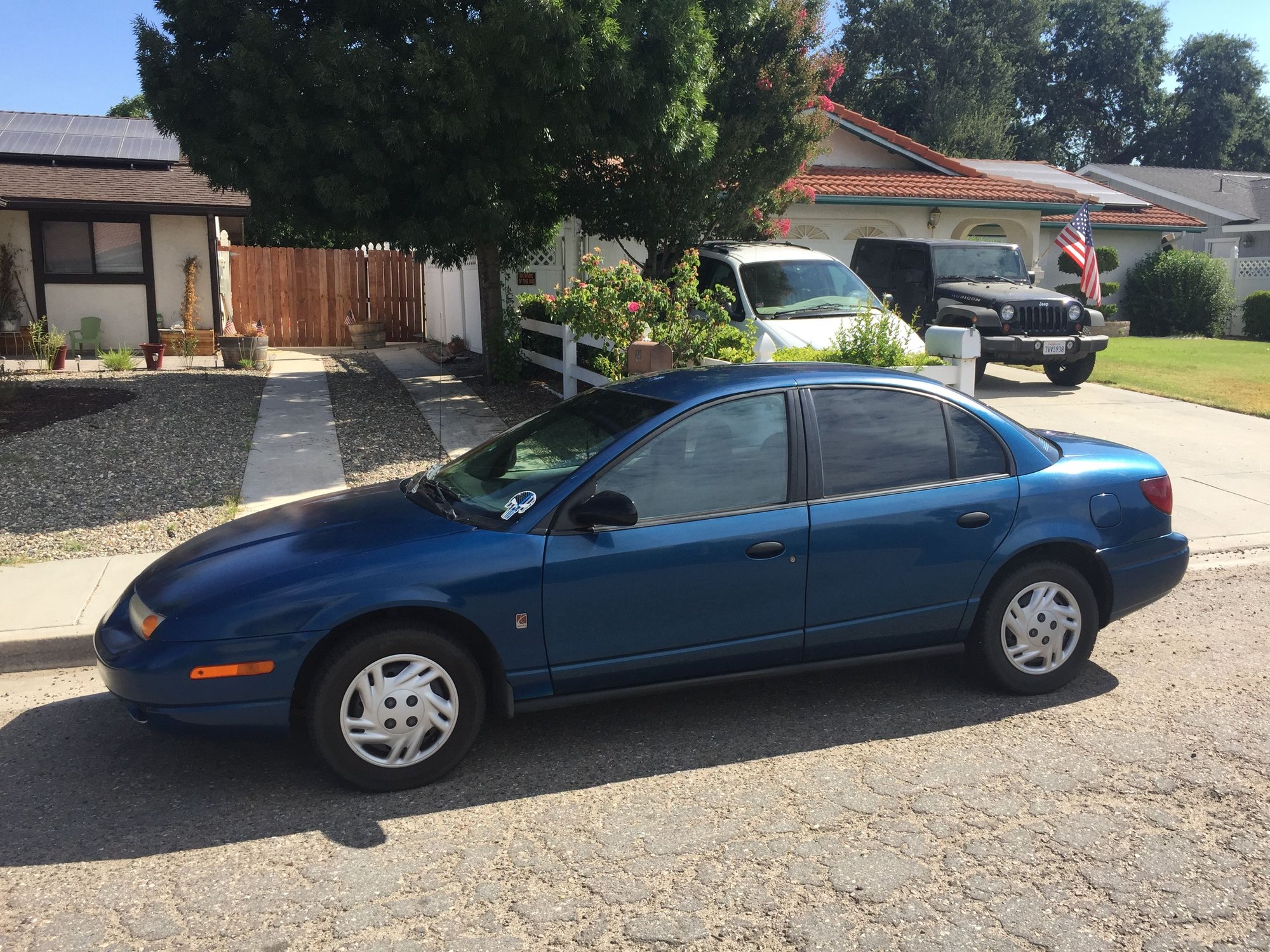

I was wondering if it is possible to take the manual 5-speed from a L-200 and swap it with the transmission in a base SL? I have my sisters car as a donor, the model difference is what is stumping me. I've read that the clutch and throw out bearing are the same but will everything bolt up nice and snug?
