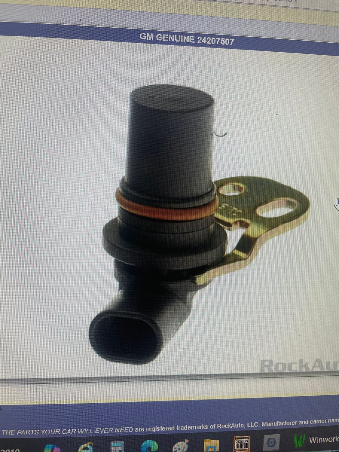

The only other sensor that is suspect(which I think is what you’re talking about) is the transmission output speed sensor. I think I bought one when I was playing with the wheelspeed sensor… I’ve basically bought one of everything for the car because I really do plan on driving it for the rest of my life. We have a Tech 2 at work I’m thinking I’m going to leave it here overnight and check it in the morning when it’s cold.

The transmission output sensor fixed it… I had one in the basement I had bought previously.
