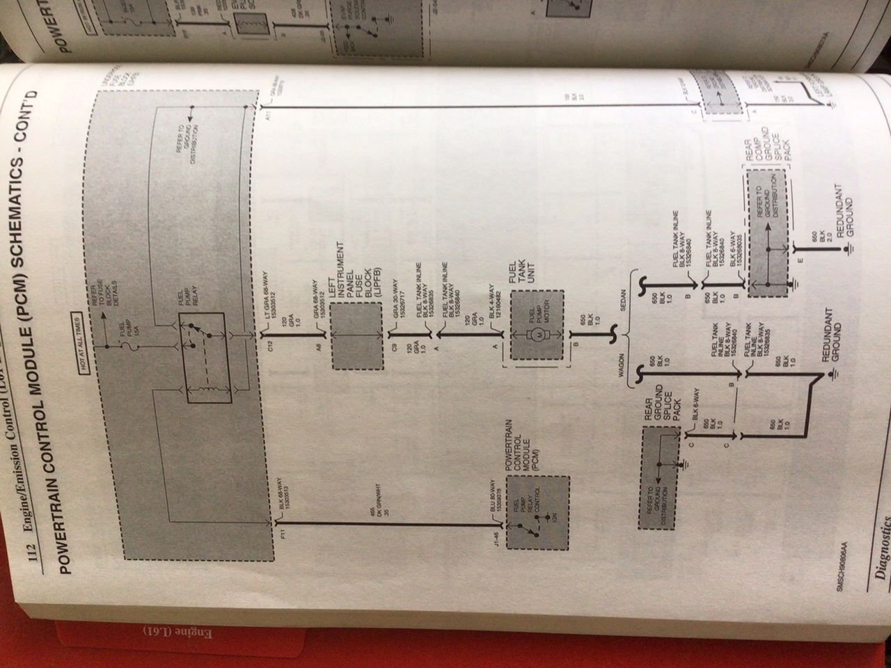

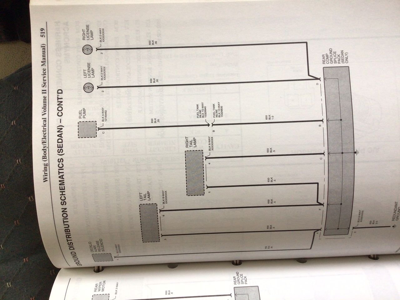

I’ll be back tonite after work. I have 02 books I will look at the schematics. Is the car rusty?
