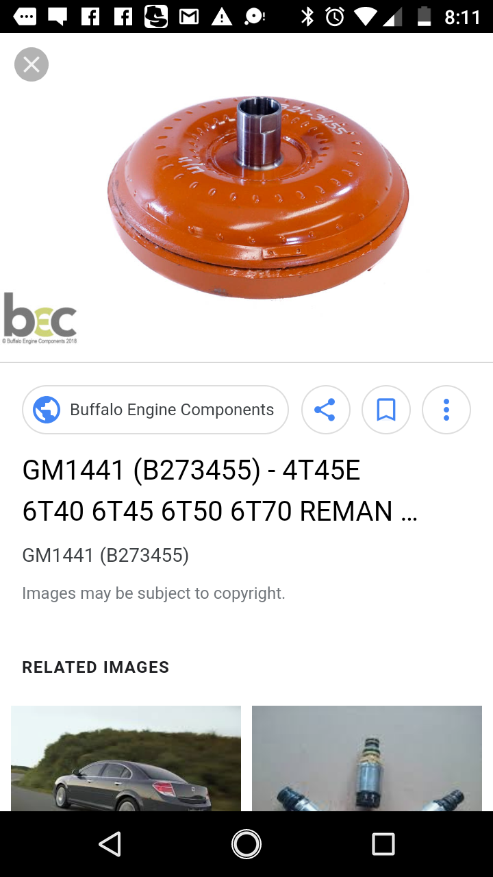

Help please help I'm on SSI disabled and cannot get anyone to help me identify this p
called mobile mechanic he filled the tranny still no movement so we bought the new conveter and going to remove tranny and install new one but the funny thing is there is no codes nothing coming up on it
I am concerned for you, in my 40 years as a mechanic I have never had a torque converter quit with no other symptoms. I have had pumps fail and therefore a dead transmission. I think you may need a second opinion.
Okay so now I'm concerned a little more as we pulled the tranny found out the tranny has a number on it CEK7294PS OR DS
like the numbers wrecking yards and such put on side but
I also found out my tranny is not the 6T40
But the 6T70
I cannot locate where this tranny came from
I'm now at a loss the other torque converter I bought is to big so I had to order a new one double price for this other tranny omg I wish I had one of my friends here that lives closer to help me I'm desperate to have my car back please help
Also found a paper with parts numbers but cannot find online
(S) 29830547
Second number
Part#(p) 15898468
Can someone please help me
