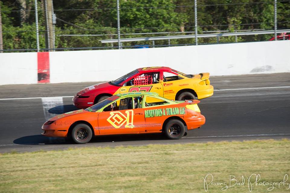

Here are the top saturns lol.. amazing out of a 30 car pack there are at least 20 s series

what are the rules for the class? Fwd and 4 cylinders? If so there are so many great options. One of my race cars is an NX2000 making near 200hp. I'd imagine Acura and others would our class Saturn.

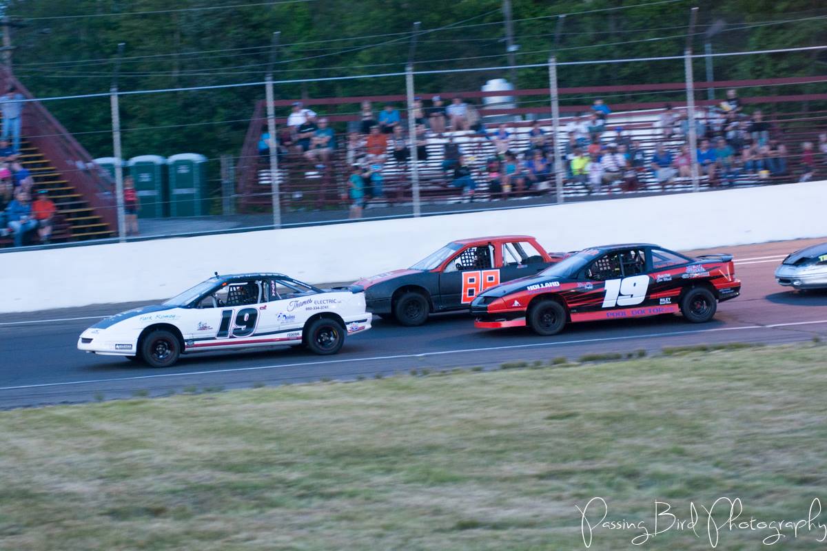

How can it be allowed that two guys have the same 19 number?

White car is 19CT orange is 19RI

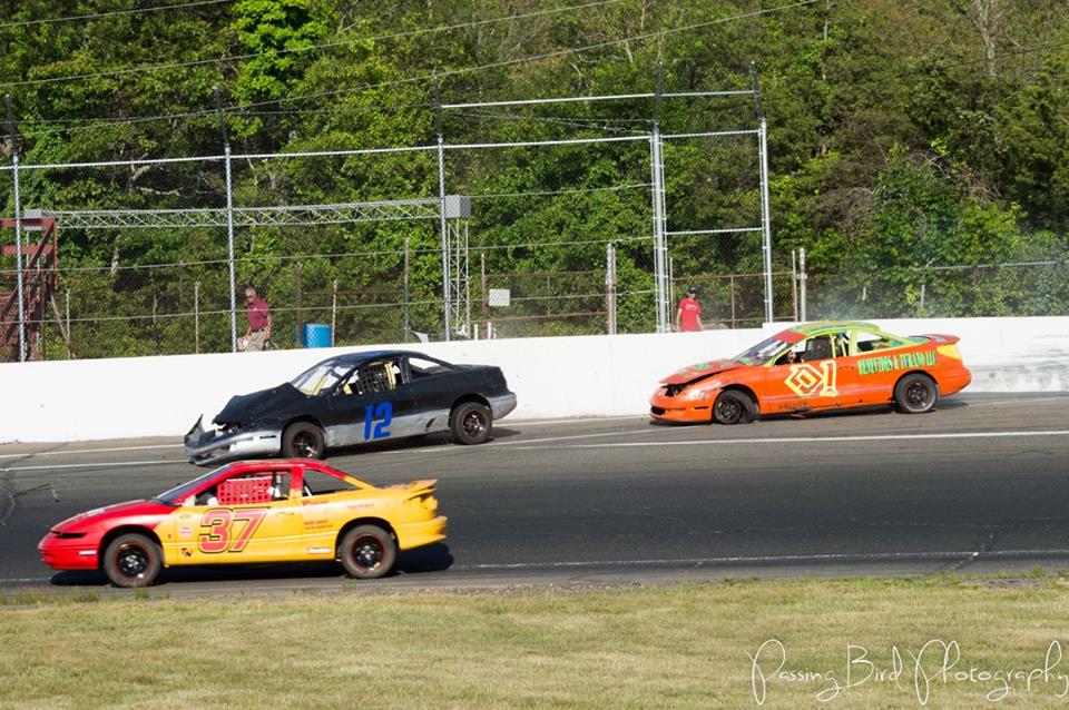

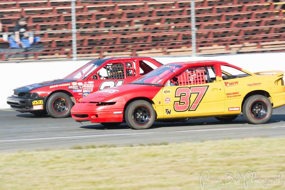

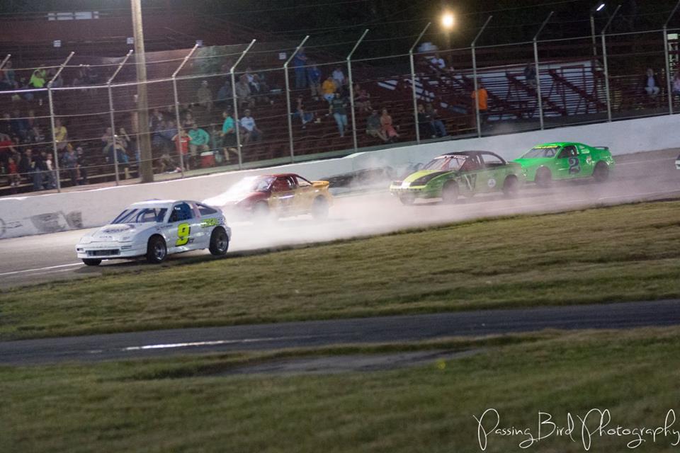

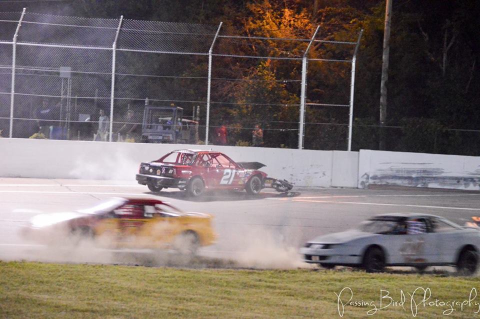

Got our camber adjustments half right for this weeks race... still have a lot of work to do but instead of getting lapped we were doing the lapping . Lot of good saturns got toasted this week, fingers crossed they can get back out for next week.
Car ran a little on the hot side so we are going to remove the therm this week, we are also going to camber the back wheels +3 and -3. We are currently +6 and -6 in front, had both wheels towed in the first week and that did not work at all... what a diffrence. We had to make minor modifications to the bottom of the front struts to get the range we needed, also used a small grade 8 bolt on the top/ washers on the tower.
