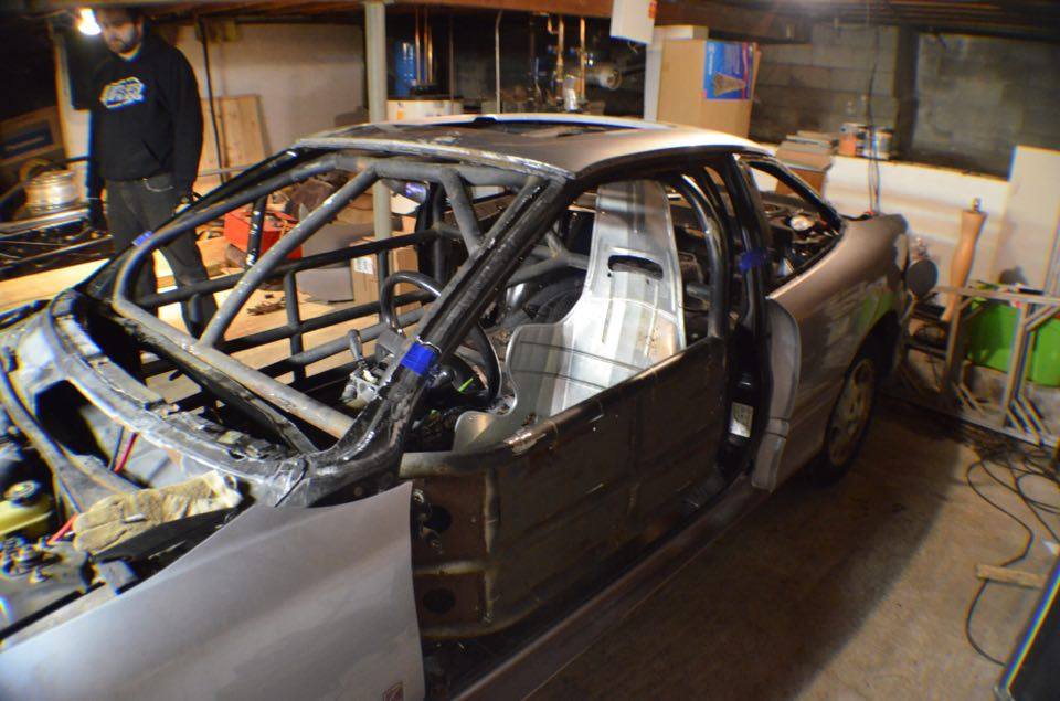

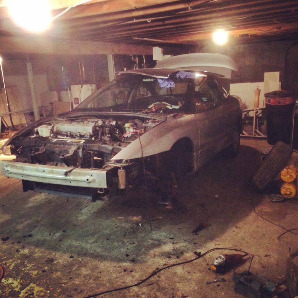

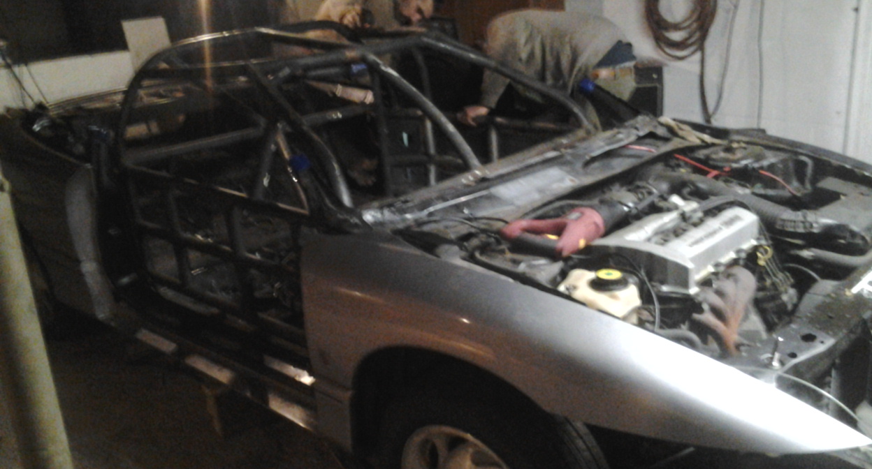

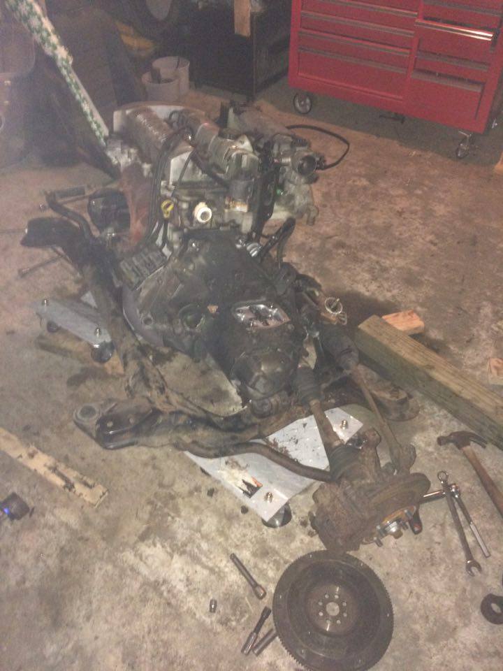

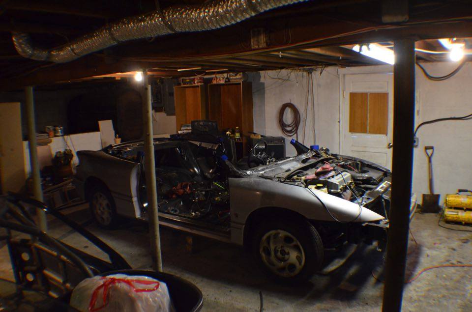

Hi Everyone new guy here, just wanted to drop some info on a build I am doing for a stock car class at my home track dominated by saturns and Integras. 94 sc2 fully stripped, trying to budget so bought a prefab cage out of an identical car... other then that everything brand new. 14x7 bassett wheels with 205/60 Federal tires (one of few tires allowed) removed AC and heater core system, replaced starter, flywheel, clutch, plugs & wires, full synthetic oil change, plus all new safety equipment by racequip. LMK if you got any tips for a newb... 3/8 asphalt oval track

Just an update, cage is 90% in and done.. had to make a few tweaks to please tech. Mounted the battery in passenger floor area where the heater core stuff was. Screwed a batt. box to the floor with self tappers, then used some better hardware to make a strap mount to hold the whole thing. Installed a longcare battery switch on a small panel we welded to the cage. Getting my tires shaved and mounted this week.Last night got my hood pins drilled and mounted.Mounted fuel tank in trunk and cut the floor pan out, replacing the plastic fuel line for the supply from the tank all the way to the stock filter and plan on adapting the the stock plastic return line to a small new piece of regular fuel hose. Going with a 12 gallon jazz cell with a built in sub fuel pump, Waiting on final cage tweaks, then cage/ interior get painted, then roof goes back on, then paint and vinyl for exterior. All will be documented in my sc2 build part 2 video on my Channel.https://www.youtube.com/channel/UChT...4sENmC6zwUgkQw Please subscribe.. and thanks for watching
