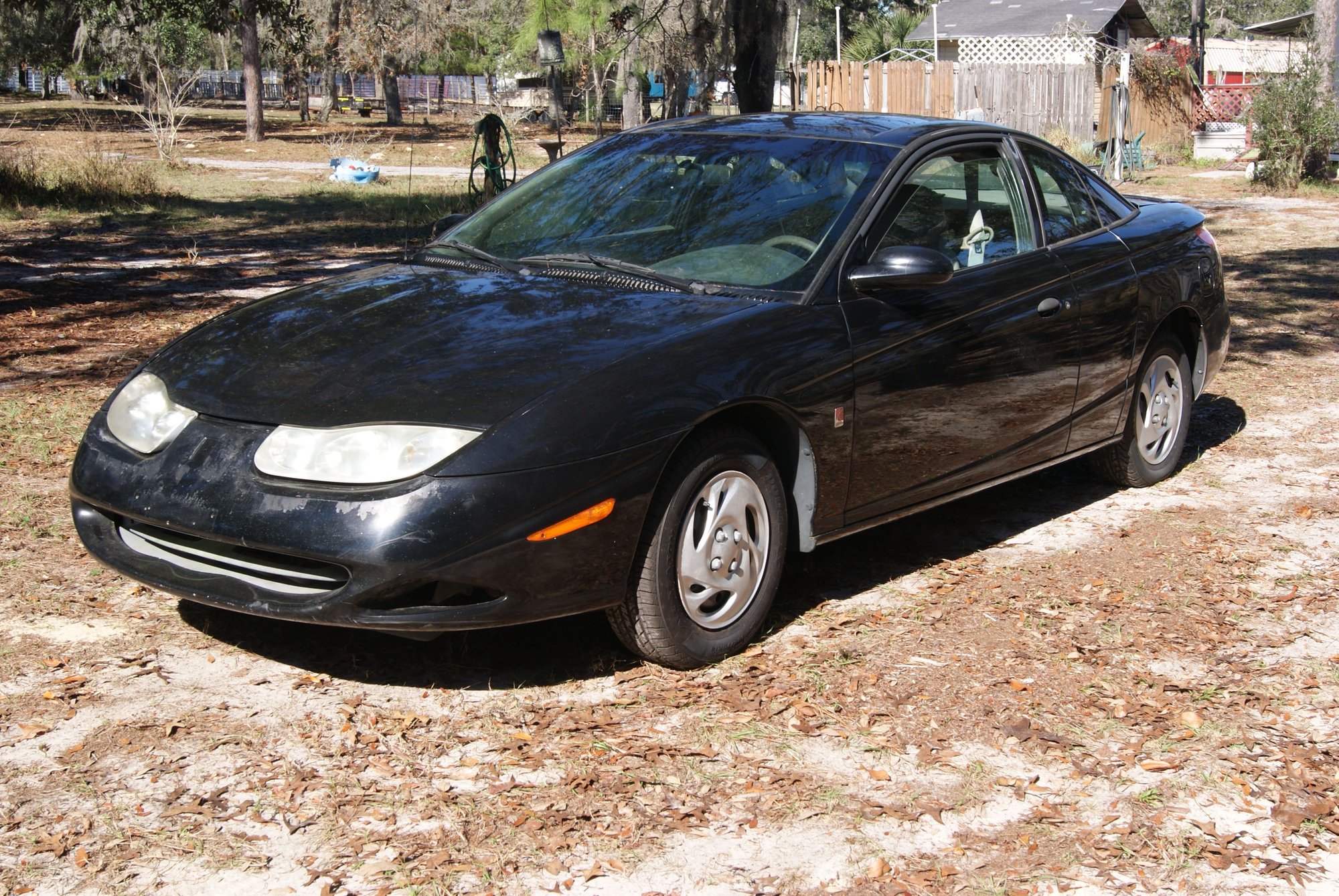

Here is a pic of my little gem, could use a little paint.

MAACO, baby! LOL
