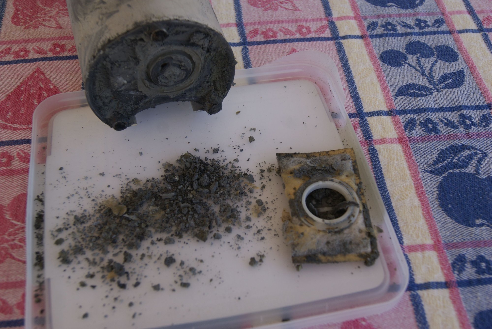

Update, went back to make sure that I had power to the fuel pump. I did, so pulled the pump. Found the problem. See pic for what happened. The new pump had some kind of material, it looked like some kind of rubber when I put the new pump on last year and the car sat all summer in the Fl. heat. .For all the problems that gas with 10 % ethanol in it, it eats certain rubber. Looks like this is what happened to the bottom of the pump screen. Clogged it so it would not run. Wii order a new pump.
As you can see the pump inlet is clogged and pump screen.

While I am waiting for the new pump, I will use the old gas for cleaning future parts. The tank looks clean, but will clean just to make sure. I will put on a new fuel filter with the new pump also.

Update, New fuel pump and fuel filter installed. With my hearing aids in, I herd the fuel pump running. Turned the key to the start, no start. Checked the fuel pressure at the fuel rail, good pressure. Engine will run when i spray fuel in the intake . So , the 1 thing I am missing is the fuel injectors not working. Where do I go from here?

I would think that the top of the injectors look similar to what your pump looked like. I have a set of noid lights that plug into the injector harness. I have a set because of the different plug configurations used by various manufacturers. I recommend that you purchase one noid light for your injector type and test each injector plug for injector pulse. The light will blink on and off if the computer is trying to fire the injector while cranking the engine.
You probably need four injectors and maybe a new fuel rail.
