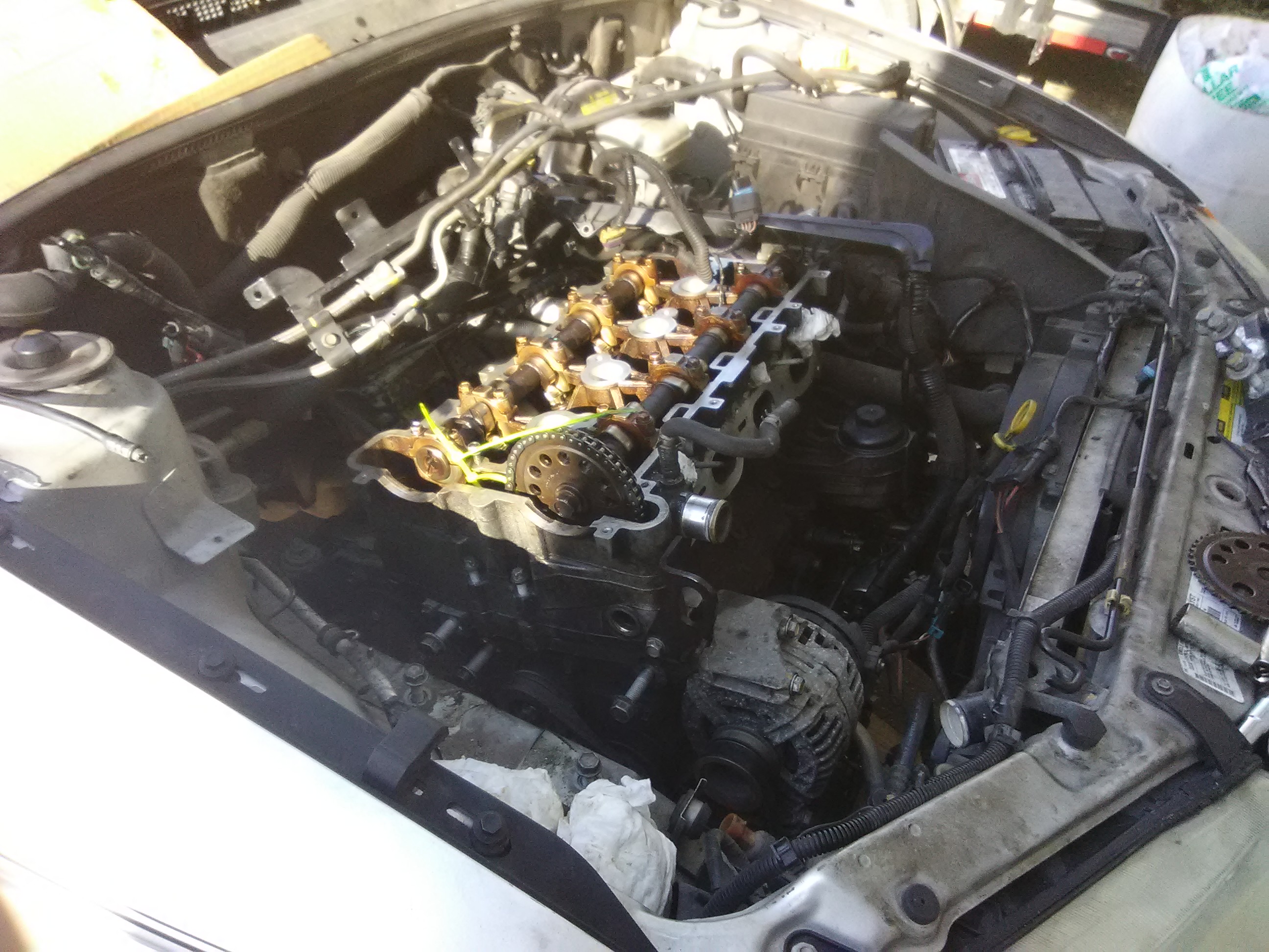

Hey guys and gals, i was doing a head gasket, timing and water pump change on my l100, i ran into a problem, i can get the crank pully bolt out bc everything i try the crank still moves, also which way do i rotate the bolt to get it to come out is it standard thread or is it reversed threads, thanks guys for the help.

It is standard right hand threads. It is a torque to yield bolt just like the cam sprocket bolts. That means they should be replaced if removed. Pull the starter and you can stop the flywheel with a big screwdriver. The cylinder head bolts are also stretch to yield and need to be replaced.

why remove the fly wheel. also i got it off, called my uncle who is a master mechanic for bmw, he told me to remove the spark plugs from the piston that are not at top strock and put a piec of wood in them bolt the head on with only 4 bolt and it will hold the crank still with out damaging anything

trust me when he told me that i slapped my self. i cant believe i didnt think of that.
