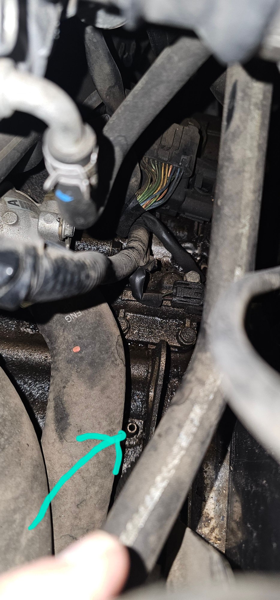

There a nipple on the driver's side (lt side) that has a nipple on top doesn't go anywhere. Can someone tell me is this a vent that should have a.hose on it? There appears to be some transmission fluid on top of the transmission as seen in pic so, MAYBE, a hose came off or something? Any help appreciated!
What hooks up to this nipple? DR SIDE HINFA.
What hooks up to this nipple? There appears to be trans fluid on top. DRIVERS SIDE TOP

Since I don't know anything about Honda engines (except motorcycles), I won't even venture a guess.

Pressure test port?

Hi dentpusher, I checked on my V6 Vue today, and that nipple is for the transmission breather vent tube which is attached to the underhood fusebox:
The '05 Honda Pilot (with similar but not exactly the same transmission as ours) Honda part number is 21320-PVG-000 , "Tube Assy., Breather": https://www.hondapartsnow.com/genuin...205AT&filter=()

Thanks for checking, redview. I suspected as much. My tube is still there but i can't see the bottom end and feels attached, I'll have a closer look. That is what i was suspecting. ✌️
