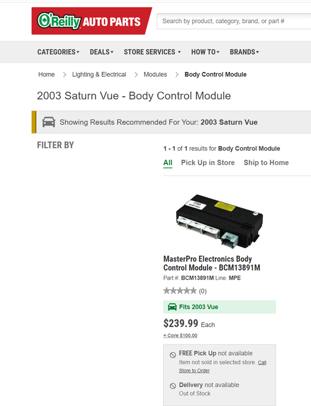

I have NO IDEA if this chain store has thecorrect pat for your particular vue.
But I did search 2003 vue 2.2 so i dunno.
