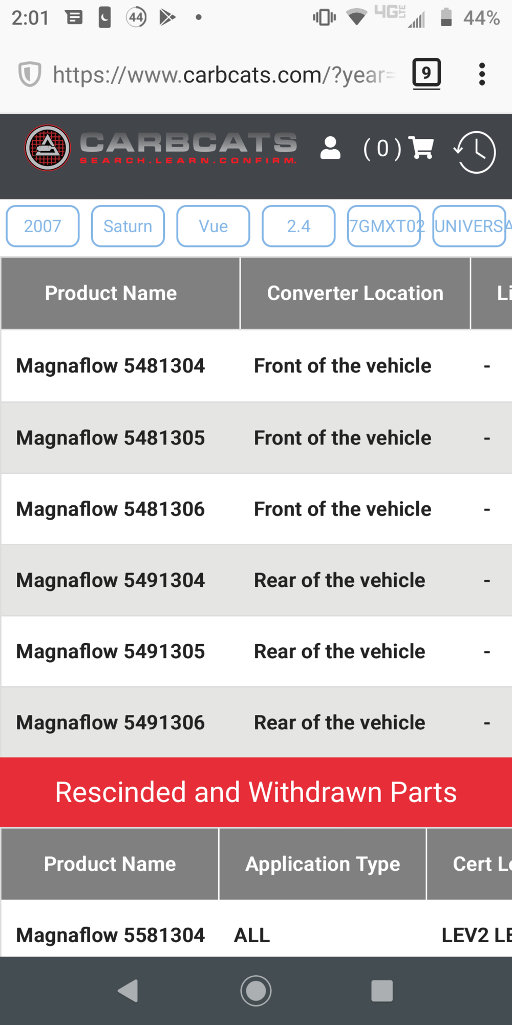

Hello. I have a 07 Vue 2.2L that needs a catalytic converter that's C A.R.B. Will the 06 cat fit the 07? The gm parts website the part number is interchangeable, I'm looking at the aftermarket walker calcat or number 82684. Can anyone help please? Thank you!

I found the following on the carbcats website. The executive order number allowing for these aftermarket parts to be exempted is in the screenshots below. I think. Can't get the damn thing to open. There may be other manufacturers listed in there. Apparently the only way you can get a waiver is if absolutely no one makes a converter for your vehicle anymore. I have not yet tried to look up the magnaflow products and I do not understand why there are three for the front and rear. Seems there should only be 2 each.
