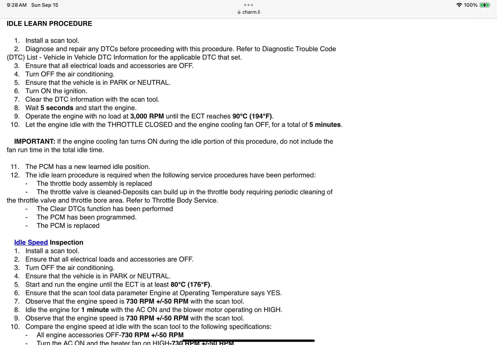

Looks like your idle control is similar to my L series v-6. It is strictly computer controlled throttle plate, no idle air bypass.
Try this procedure.

I cleaned the throttle body, which was very dirty, and then performed the idle “re-learn” and now it idles with the A/C on and in “drive” with no issues! Thank you guys so much!
