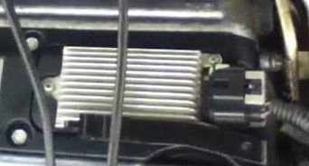

I had the same symptoms See pic as I replaced the module on the right side of the valve cover. It solved the problem, and it was cheap.

Okay it's me again. Still having the same issue. Have done the relearn, have replace coil pack and module. Still having same issue. Now doesn't even want to start. Cranks with no start. I have about lost my mind on this thing. Oh and still no codes, except when it dies it sets the communication code
