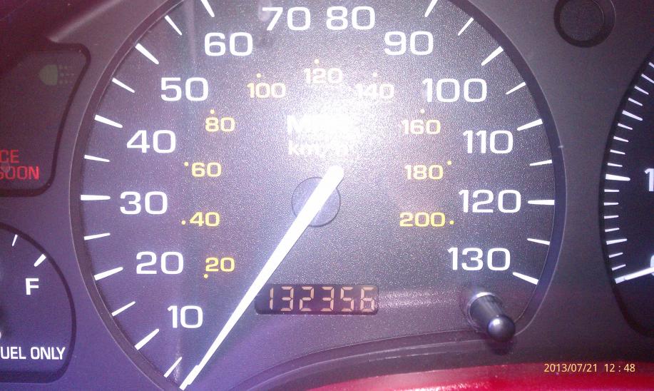

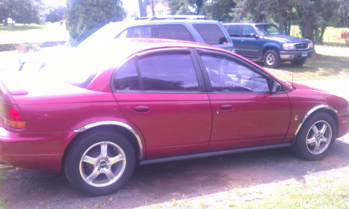

Im located in Connecticut. I am trying not to go to the junk yard because they will offer me $350 and thats hard to swallow. Between buying the car and putting parts in (that I have not even enjoyed using) im invested in about $1600. I attached 2 photos of the car.
Attached Thumbnails I'm new to Saturns and it's already giving me problems-imag0278.jpg   I'm new to Saturns and it's already giving me problems-imag0281.jpg
Old Jul 27, 2013 | 10:15 PM
Man, that's a nice looking car. I'm wayyyyy too far south to make an offer and make it worth my time to come fetch it. Good luck with it. I still think it's fixable, but would take a smarter person than me to figure it out. I'm just a dumb old hillbilly.
