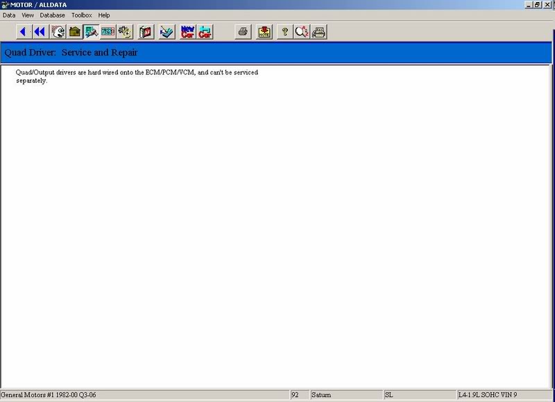

Originally Posted by STLWACO
Quad Driver is built into the PCM of the vehicle. To correct the concern the PSM would need to be replaced.
Nonsense. Quad driver output fault is a generic code that covers a bunch of stuff that share a single "flag". A problem with any one of the systems hanging off of the this circuit will set the same code.
I'm yet to see a single quad driver output fault require a PCM replacement.
IM me and I can share the sometimes gory details of troubleshooting it, or search for quad driver in this forum and you should find a post or two by me concerning troubleshooting this code.
Based on age of car, I'll blindly guess your EGR needs cleaning.
Derf
Old Nov 22, 2006 | 09:28 PM
Folks,
I should have been more specific in my response -- indeed, the quad driver is an integrated part of the PCM. Simply pointing out that getting a quad driver related code on a Saturn S car
almost hardly pretty much never ends up upon proper diagnosis</span> to be the quad
driver itself that is the problem.
In theory--sure--could happen -- and indeed you'd need to replace the PCM.
In practice --
yet to see it.
Sorry if I came off a bit harsh -- I had a shi*t day at work.
Ultimately -- I hope you problem will be solved with our assistance.
Derf

off topic, but curious... what program is pictured in the screenshot? Is it just used for referencing automotive jargon?
