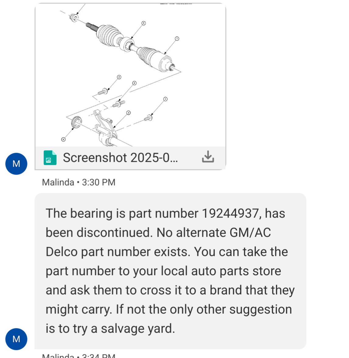

Does anyone have any info on the bearing for the cv intermediate shaft bearing for a 2002 Saturn sl automatic?
https://www.gmpartsdirect.com/oem-parts/gm-intermediate-shaft-21013354?c=bD0xJm49U2VhcmNoIFJlc3VsdHM%3D
This is the part number for the intermediate shaft (21013354), but I'm having trouble finding a replacement, so I'm trying for find a compatible bearing to press in, if I can, but I'm not finding any information about it online.
I'd like to avoid pulling a used one, since I'm not a huge fan of reusing old bearings, if I can.
Edit:
Talked to gmparts.com support, and it looks like the bearing is this
https://www.gmpartsgiant.com/parts/gm-bearing-19244937.html?vin=&make=Saturn&model=SL&year=2002& submodel=&extra1=&extra2=&filter=()
19244937
But it has been discontinued.
Making progress, at least. Lol
