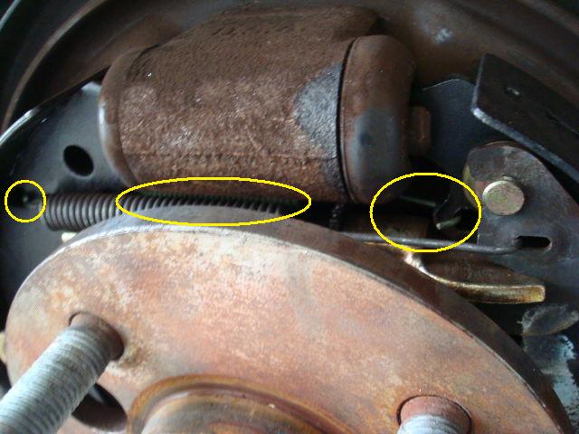

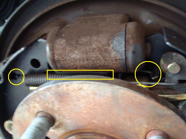

parking brake spring check
adjuster spring check
lower return spring check I think
upper return spring ?????

I think those are indeed your upper return springs , not your adjuster springs as I originally postuated

I dont know where the spring is supposed to go!!!! I cant find any pics on the assembly for my car at autozone either!!!! CRAP!!!!

dad,
the link I sent you is for 91-98 drum brakes. 99-02 are apparently slightly different. My bad for not looking up what year your S car was. (Like I said, I hate drum brakes and don't work on them)
I revised my earlier post.
The spring looks like what is pictured as the adjuster spring, not the upper return spring. In your pic, one of the spring ends looks badly distorted. I'd replace them both as it appears they were not staying seated properly.
If still in doubt, pull a drum, take a pic, bring the springs to a Saturn Service dept and they should be able to print out a detailed pic for you or just explain it to you. The guys at my saturn dealership have always been cool about such stuff.

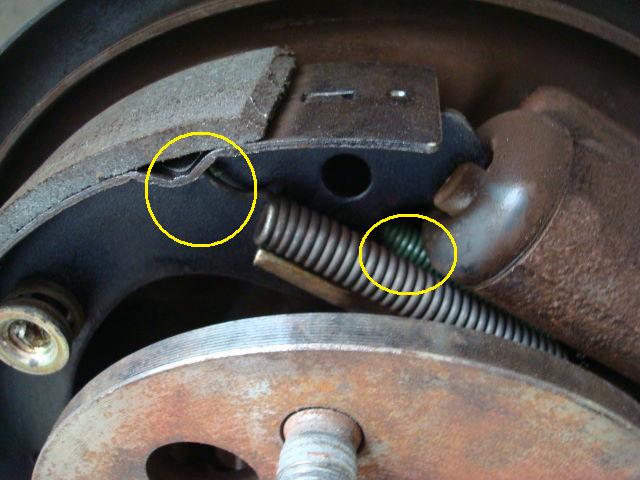

I think I installed the spring correctly this time. I will attach a few pics that show the upper return spring(green spring). Let me know if all looks ok.

i THINK it looks ok. The upper return spring is installed from the back as it should be, and appears to be in the correct orientation. And the adjuster spring also appears to be connected correctly.
Sorry for the confusion -- but as I said -- I'm not a drum brake kinda guy.
If you have ANY doubts, take your vehicle to a Saturn dealer.

i ran up to the autoparts store and took a quick peak at a chiltons. the install is correct. whew!!! i'm a pro now if anyone needs their drum brakes replaced!! thanks again for your help.
