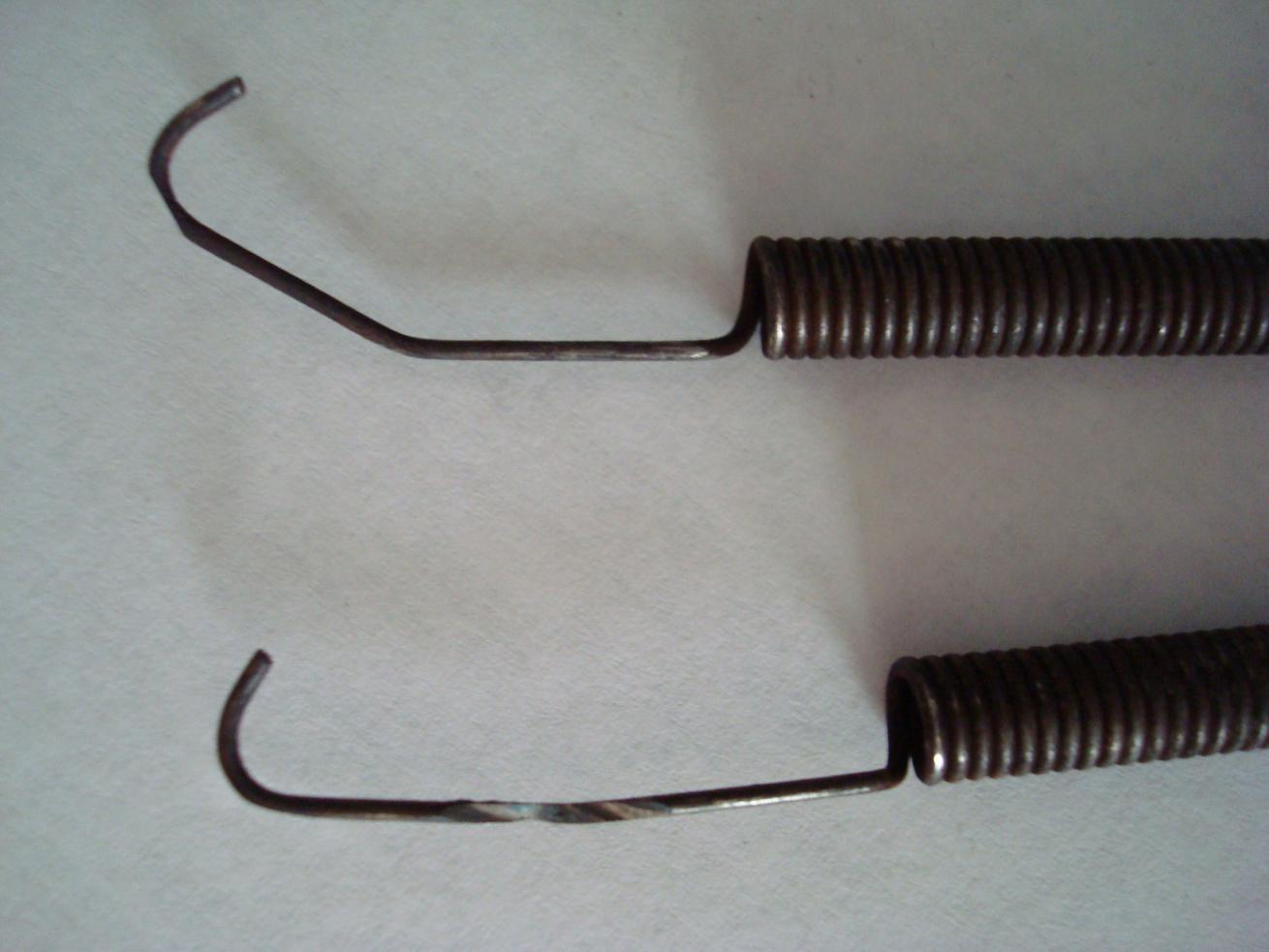

Thanks for all of the advice. I agree that someone might have added a little fluid a long the way. I also installed my rear brakes. I did one at a time. When I took off the rotor for the right rear I notices a spring just sitting inside behind the shoes. Hmmmm..... So I then took off the rotor on the other side and the same spring was sitting there in the same place. Neither sides of the spring were connected and they also have lots of metal to metal wear. The top and bottom springs were ok. Where does this third spring go? Thanks

you mean rear drums, yes?
I think you are referring to the parking brake cable spring. It may look like it is just sitting there, but I believe it should be riding over the parking brake cable and attached to the parking brake shoe on one side.

Yes drums not rotors, sorry. If you include the spring that is where the e-brake is then there would be 4 springs total. This spring looks identical to the one on the top of the shoes except it is a little smaller wire so its diameter is less as well as the length. The e-brakes work fine also. I have not had any issues with the brakes at all since installation (about 70 miles city driving). When you look directly at the brake assembly on the car the extra spring was located behind the right shoe. When I took off the drum the spring sat about 1 inch below the shoe, so I would have had to push or take out the spring to reinstall the drum.

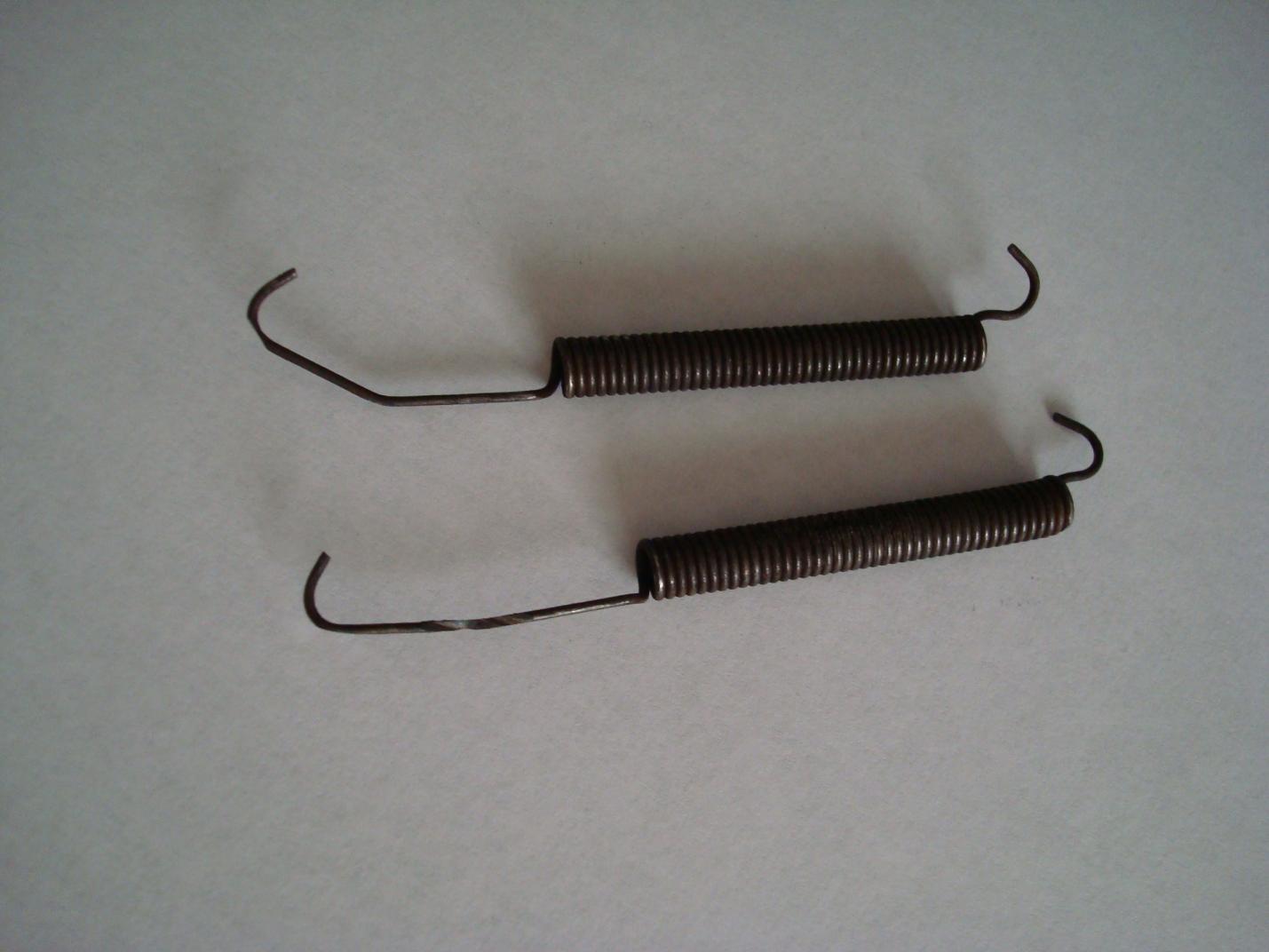

would need to. I have the springs. Want a pic?
Old Nov 11, 2009 | 12:36 PM
yes -- of the springs and ideally of the rear wheel with the drum removed, if you're willing.
I believe the only other spring besides the upper and lower return springs and the parking brake cable spring is the adjuster spring which keeps tension on the adjuster assembly. It would be installed at the top of the entire setup, across where the star adjustment wheel would be.....

Here are the springs
