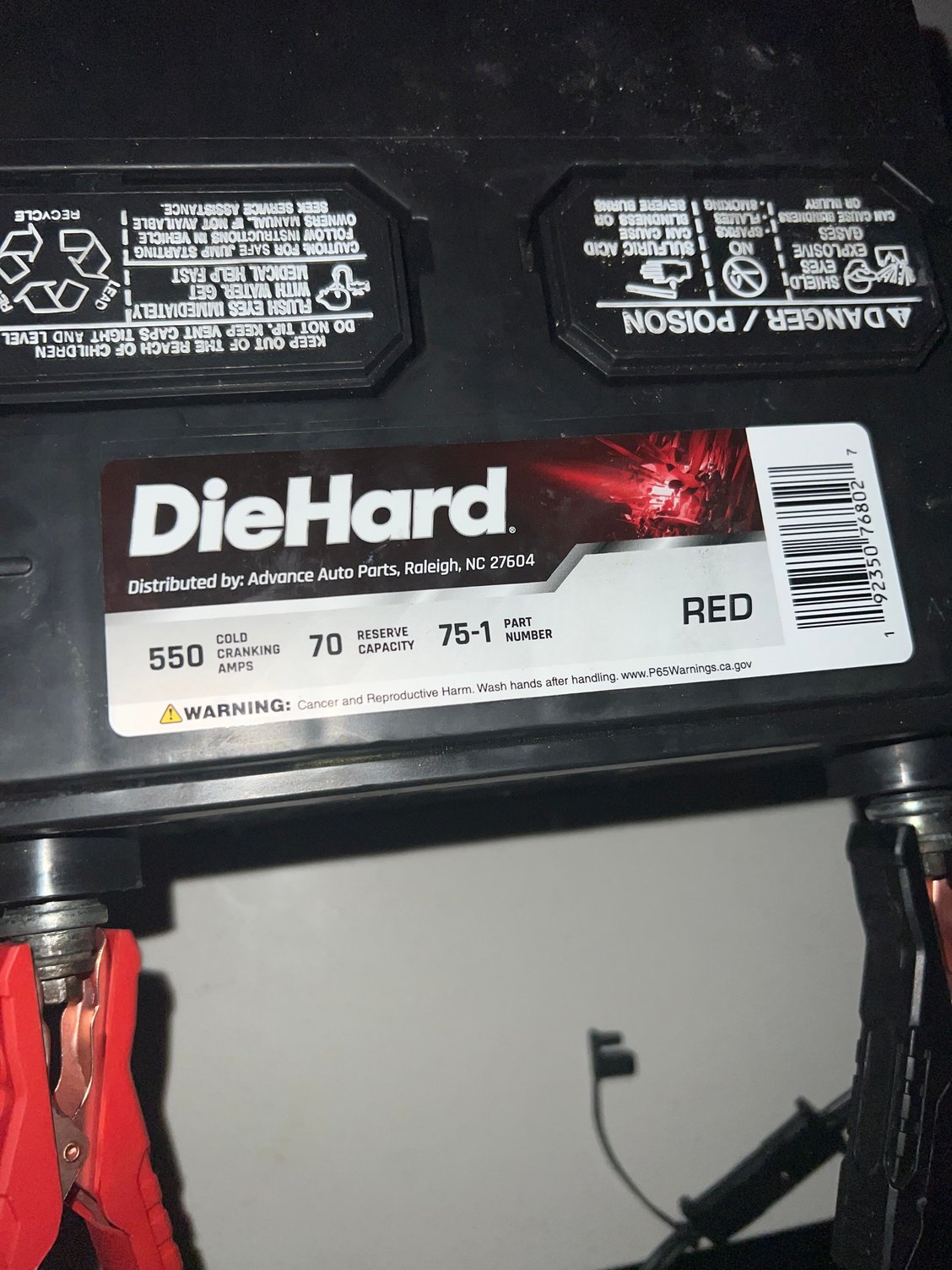

So anyway, the correct group for the battery is a 75.
No idea what you have since you won't answer the question, post the picture, or seem to care.

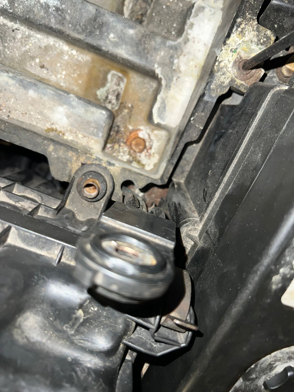

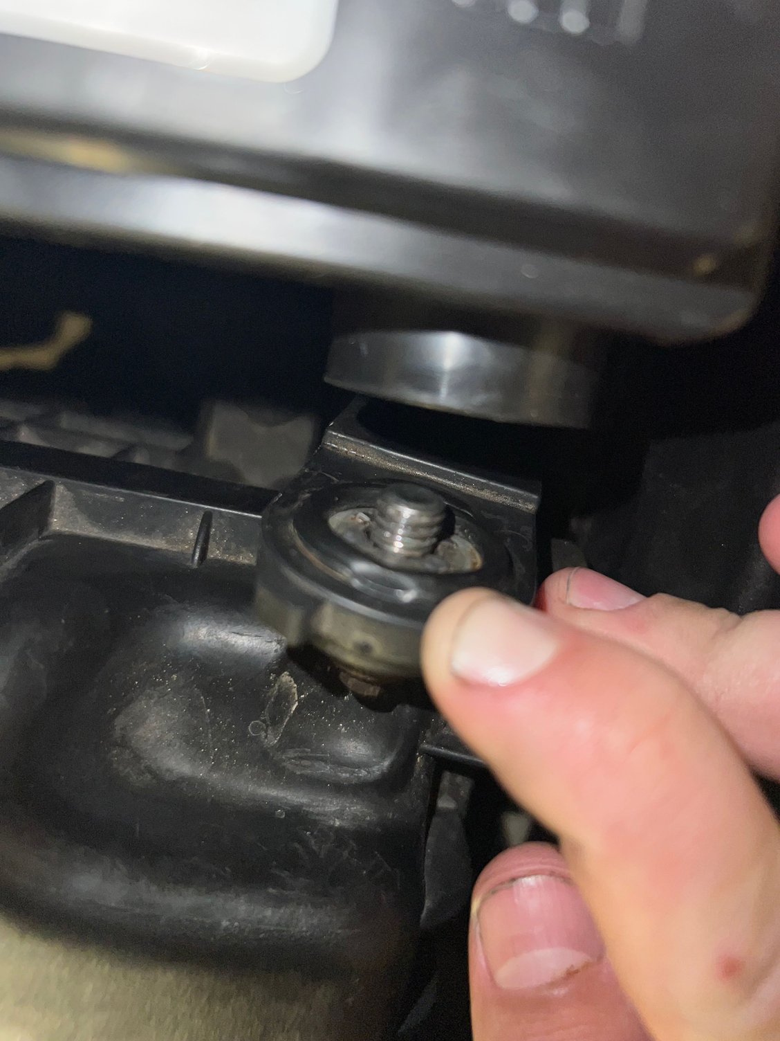

hey man! Thanks for replying. I didn’t get the chance to snap a pic of the battery, the car is not at my house and i didn’t have the time to get over there today. Battery pic is uploaded here. It’s charging on my kitchen table lol. Also wanted to upload this pic of my neg battery connection, i believe it’s oem but it looks like there is a plastic cover over the metal part, would that prevent a metal on metal connection? Going to try my best to check continuity or resistance not sure if that’s the same thing, on all wires from alternator to starter to battery; and look at the fusible link. Although I’ve never seen one and am not sure what I’m looking for. I also did replace the belt tensioner; i looked and the alternator was spinning but how do i know if it’s tight enough?

Here is the pic of the negative connection. Yes i know there is corrosion but that was from the old battery.
