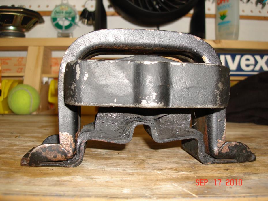

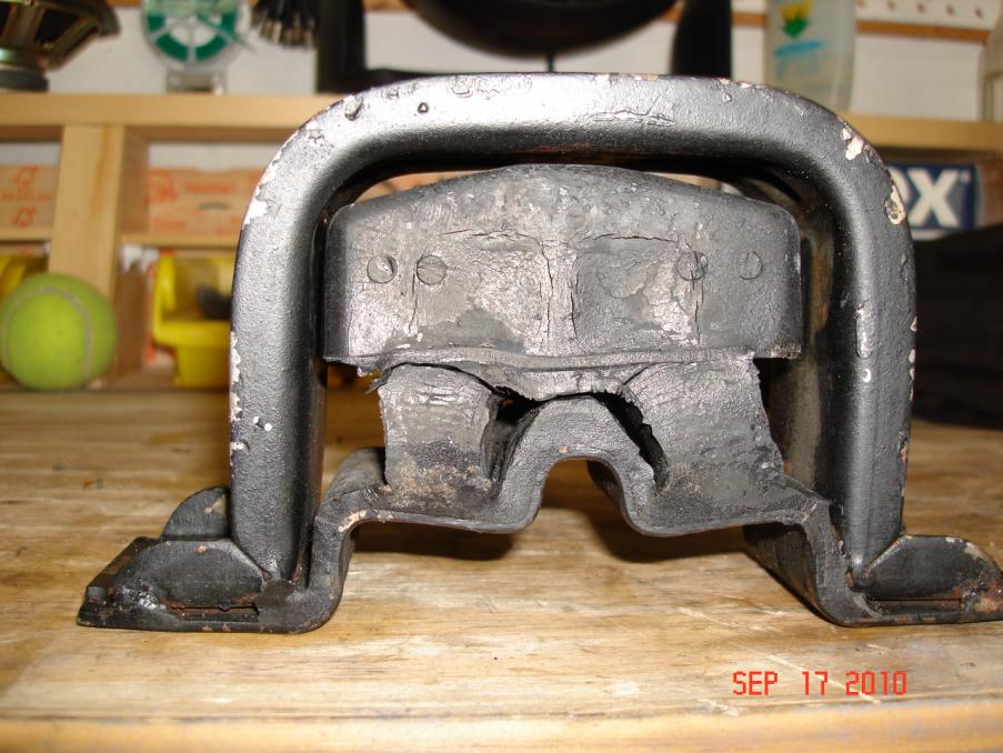

I just replaced the top motor mount on my 2000 Saturn SWP last week after having problems with the engine shaking while idling. The dealer pointed it out on a visit to Saturn. They wanted $200 to do the job which I really didn't have. After doing some research I purchased a new motor mount from Theautopartsshop.com for $18.05 plus shipping and I found several video's on YOUTUBE showing how to do the job. It only took me about 10 minutes using just a 15MM socket wrench. It solved the problem. Here's the video I watched.

Attached Thumbnails 98  SL2  load vibration from engine?-91-17-2010-old-motor-mount-1-.jpg   98  SL2  load vibration from engine?-91-17-2010-old-motor-mount-2-.jpg
