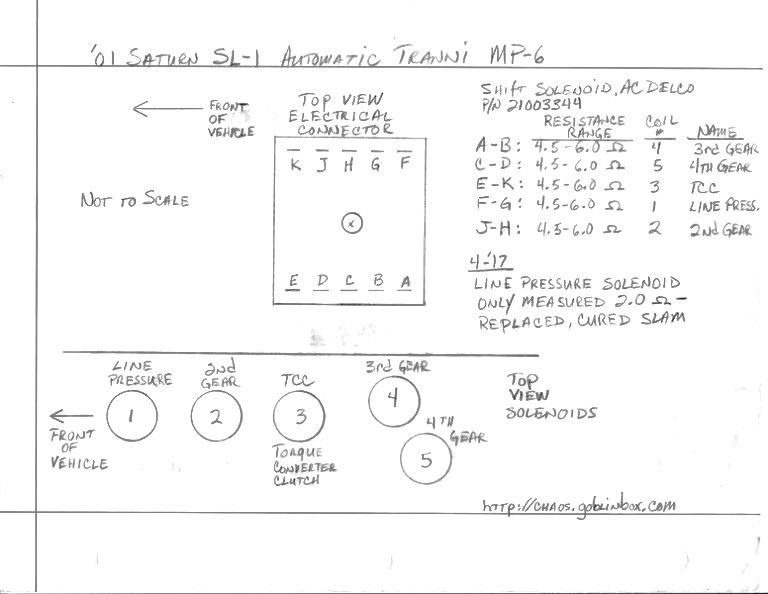

I have a basic code reader...no codes. I had the battery disconnected today checking the resistance of the shift modules they all check out within spec. I'll have to drive the car around a bit to get the computer reset and I'll bring it to my friends shop to put a real scanner on it. After checking the resistance of the modules I did pull them out and checked them manually, they all clicked closed when energized. Although not the best way to check them, I put a rubber hose on each and blew though once energized, checking that hey were closing. One, although hard to tell may have had a slight leak (the line pressure mod) so for 45 bucks, I replaced it. I today read on another thread that you may have to drive the car a hundred miles or so to allow the computer to recalibrate itself. So, I'll drive it gingerly for awhile and see what happens. Any other ideas would be appreciated. Thanks.

So here's the latest update. The car is back to normal. Originally I changed the crank sensor because it was clearly out when I checked the resistance. This made a positive improvement for about a month. then, It must have been just a coincidence that the issue started again right when I changed the radiator. So, for good measure changed the output sensor as well, as it was at the bottom limit of acceptable resistance. They were quite inexpensive so it was worth the risk. It didn't make a difference, all well. Next I checked the modules for resistance and they all were in spec. (I checked them by probing the leads coming out of the top of the transmission cover.) This is a valueless beater car so I thought I would just have some fun and try to figure it out on my own. So I pulled off the trans cover and pulled each of the modules to make sure they were actually closing when activated. They all "clicked" and worked fine. Then I checked to see if they were sealing when activated and I found one that leaked under pressure. (The one toward the front of the car. Line pressure module.) Simple and cheap enough so I changed it and it didn't make much of a difference but it did change some. Then I read that the computer has to relearn the shift pattern and timing associated with the new parts. I then drove the car gingerly for several days and each day it ran better and better and now it's back to normal. So that's it, for under $100 bucks I fixed the car myself and learned a little along the way.

I only changed 3 parts,1st the output sensor which made a difference for about a month. Then the crank sensor which was at the bottom end of acceptable resistance but that didn't make a difference. lastly was checking the line pressure module which did click and close but not properly seal when energized. I would therefor say it was the line pressure module at fault. I should add that I did have a mechanic check the ecm with a professional scanner and it showed no codes, Can't explain that either.

Aglocklear
16
Aug 25, 2024 02:45 PM
Eaglescout
Nov 17, 2014 07:19 PM
Curille
Mar 20, 2013 03:30 PM
timmerz
Aug 20, 2011 10:31 AM
B_Richardson45
Nov 29, 2010 09:32 PM
