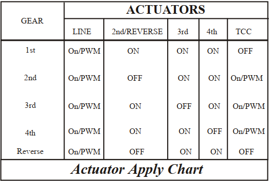

Solenoid actuation shown below (PWM is pulse width modulation - similar to how the fuel injectors are controlled).

In addition to checking resistance the solenoids can be tested by actuating them and listening to the sound they make.
They should make a clicking sound and it should sound the same for all five. If one doesn't make a sound or sounds off from the others then that solenoid needs replaced.
There's two methods to do this.
1. For all generations:
Simply apply 12VDC across the solenoid pins. This can be done through the connector or if the cover and connector plate has been removed by connecting directly to the solenoid pins.
The post above shows the terminals and polarity at the connector if you use this method.
2. For 1st and possibly 2nd Gen cars:
The 1st and (and possibly 2nd Gen) have an automatic test routine built into the PCM.
The nice part about this test is that it can be done from the drivers seat and the only tool required is a paper clip.
Jump terminal A to B in the connector as shown in Figure 12.
After the terminals have been jumped, turn the ignition to the "ON" position. Do not start the engine.
Next, move the selector lever into the manual 2 position and listen for a buzzing noise coming from the 2nd actuator.
Use the chart in which illustrates the gear selector position to check the desired actuator.
When the gear selector is moved to the corresponding position, the PCM will pulse width modulate (PWM) the actuator at a set duty cycle for about six seconds.
Listen and compare the noise of the suspected bad actuator to that of the other actuators. They should all be similar.
If the noise coming from the suspected bad actuator is faint or not present, replace the actuator.

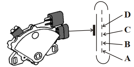

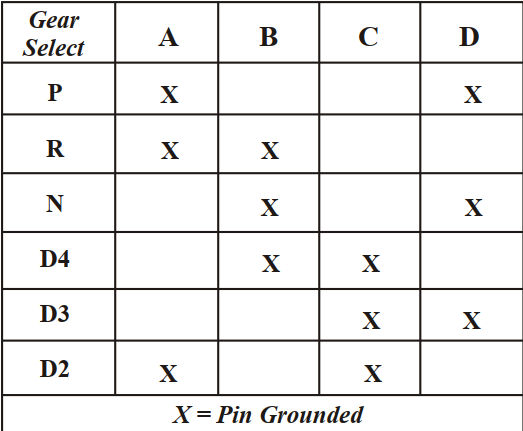

It can happen that the gear select switch isn't working right.
Pinout:
Check for correct operation by testing each pin to ground:

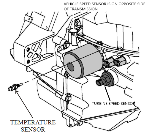

The PCM also uses signals from 3 sensors as part of its data set for controlling the transmission.
Turbine Speed Sensor (TSS)
Vehicle Speed Sensor (VSS)
Both sensors resistance should be between 800 to 1600 ohms.
Transaxle Fluid Temperature Sensor (TFT)
Nearly identical appearance to the ECT and temp./resistance chart is identical.
Maybe they can be swapped?
Sensor locations:
Note, the temperature sensor port doubles as a line pressure test port.
300psi gauge connected there will indicate line pressure.

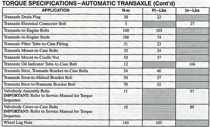

The rest of commonly need torque figures in chart below:
TAAT service torque chart
Additional Torque values:

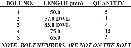

Which bolt is which (valve body)?
Valve body bolt identifier chart
Bolt length guide
